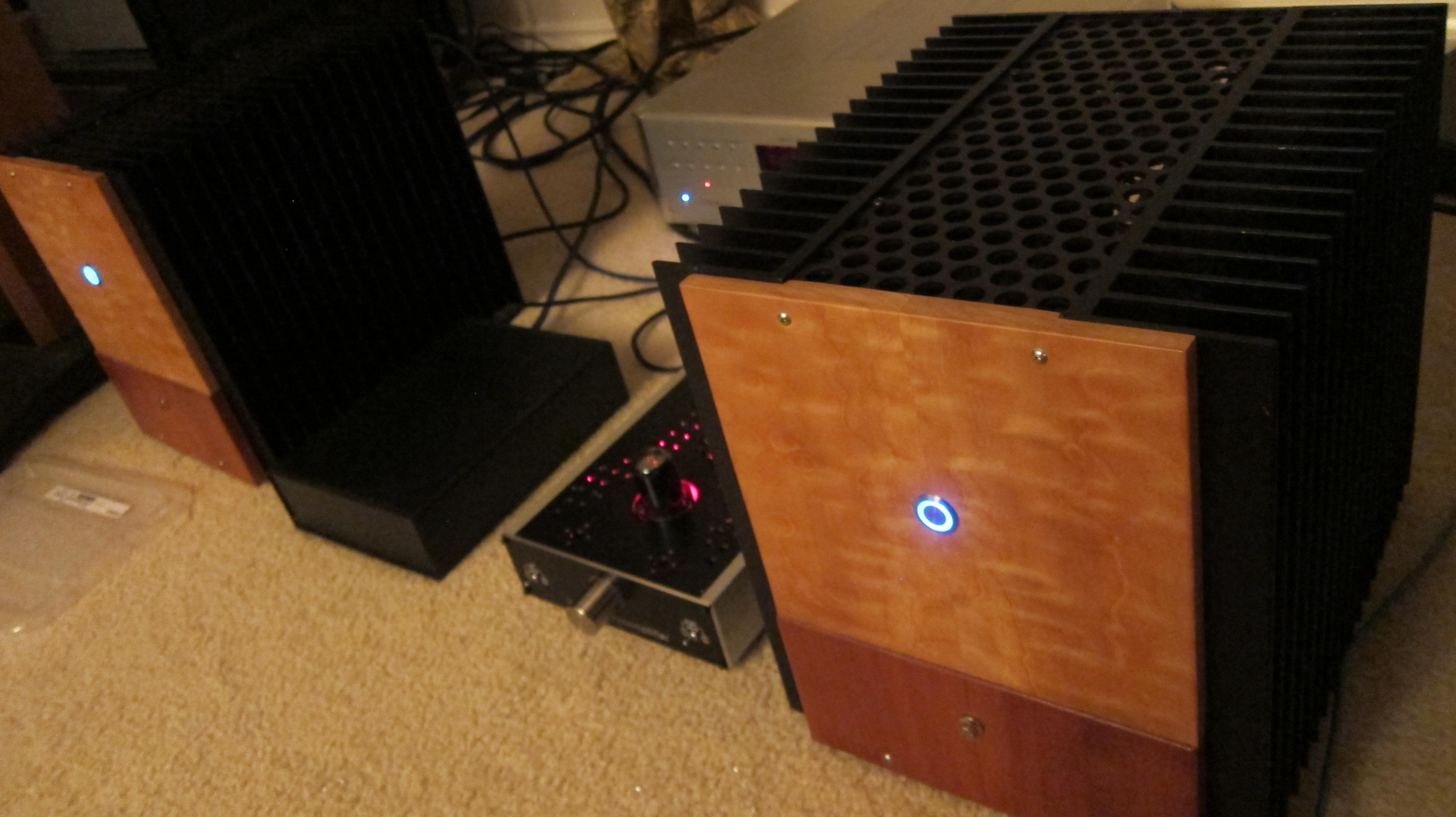

My gut would have been that those heat sinks are good for half the heat you have. I'll be interested to see the temp after the lid is installed and it is on for 12 hours or so. Good luck!

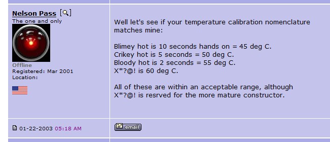

I'm afraid you could be right. How should I go about taking their temperature? Should I be able to use something like a meat thermometer, or do I need something more specialized?
Not to dwell on this, but they may have appeared to be slightly smaller than they are. They are 10.75" L x 2" W x 6.5" H. I suppose they aren't very deep or thick, but that seems to be a fair amount of area.
Okay, I will stick with the hand test.
And the hand test weighs in at one second. I may need to readjust the bias on the lower channels. I noticed that when I raise it, the hum in the transformers increases, and only one of them is humming loudly. And it was set right as the batteries on my multimeter were running out.
Anyone have any suggestions for where I could get better heat sinks that would fit there?
Finally got around to getting things buttoned up. That buzz, has totally gone away and returns at a nearly undetectable level once it warms up for 12 hours or so.

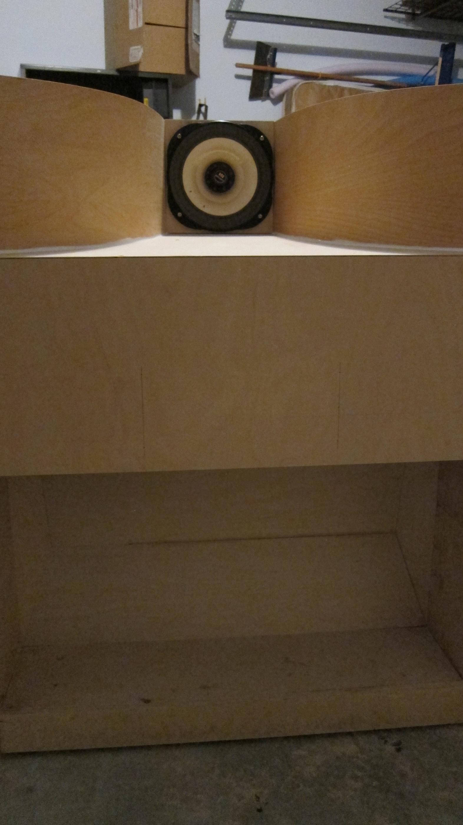

I'm curious if the F4 will drive what's behind garage door #1 in the second picture
Nice cabinets in progress!
Thanks!
I have a feeling I'm about to have to go read Pano's gain structure thread. But, the upside is, I can probably just use a "regular" preamp and be fine.
I guess I could also try a swamping resistor across the drivers. Getting very close to being about to listen!
