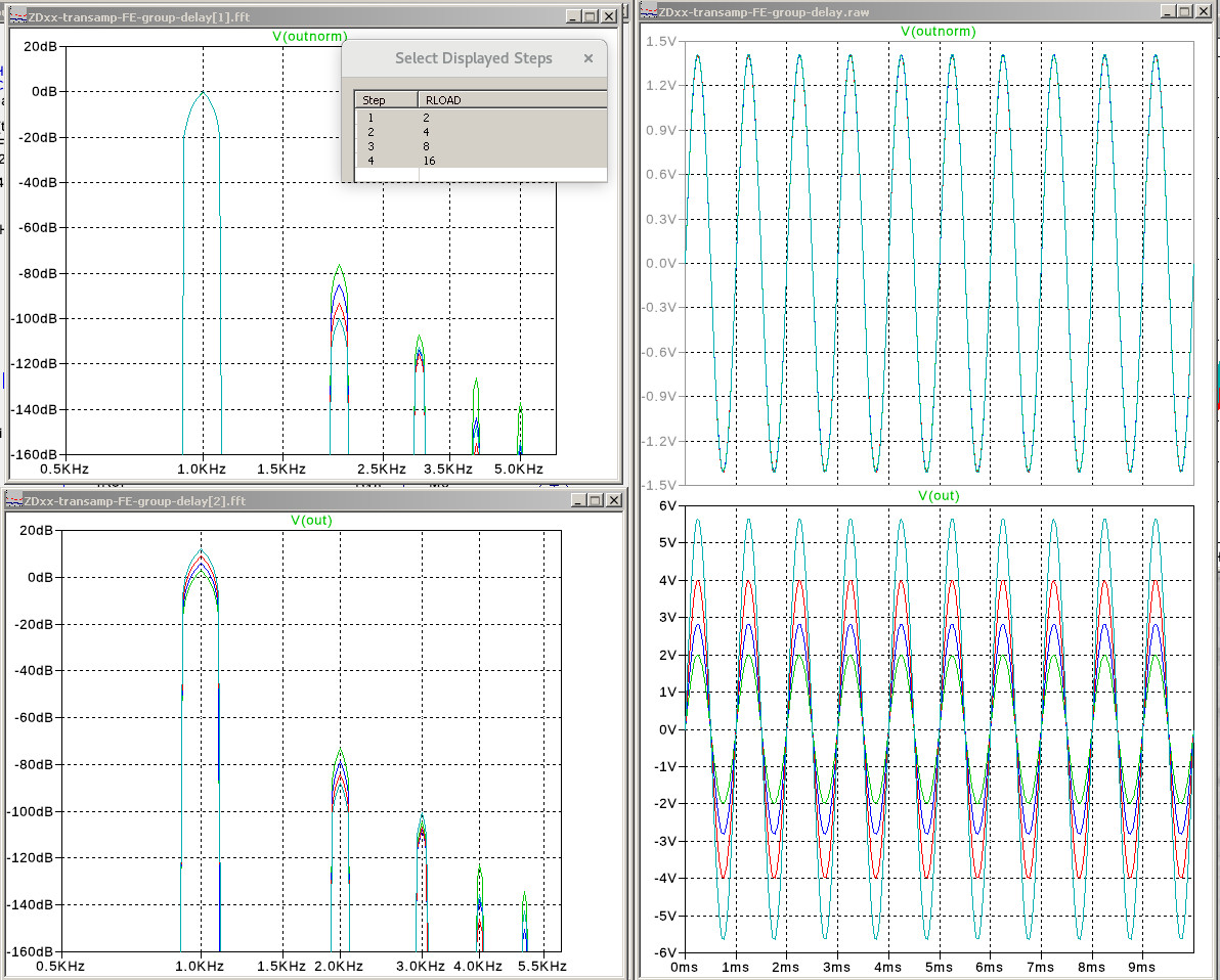

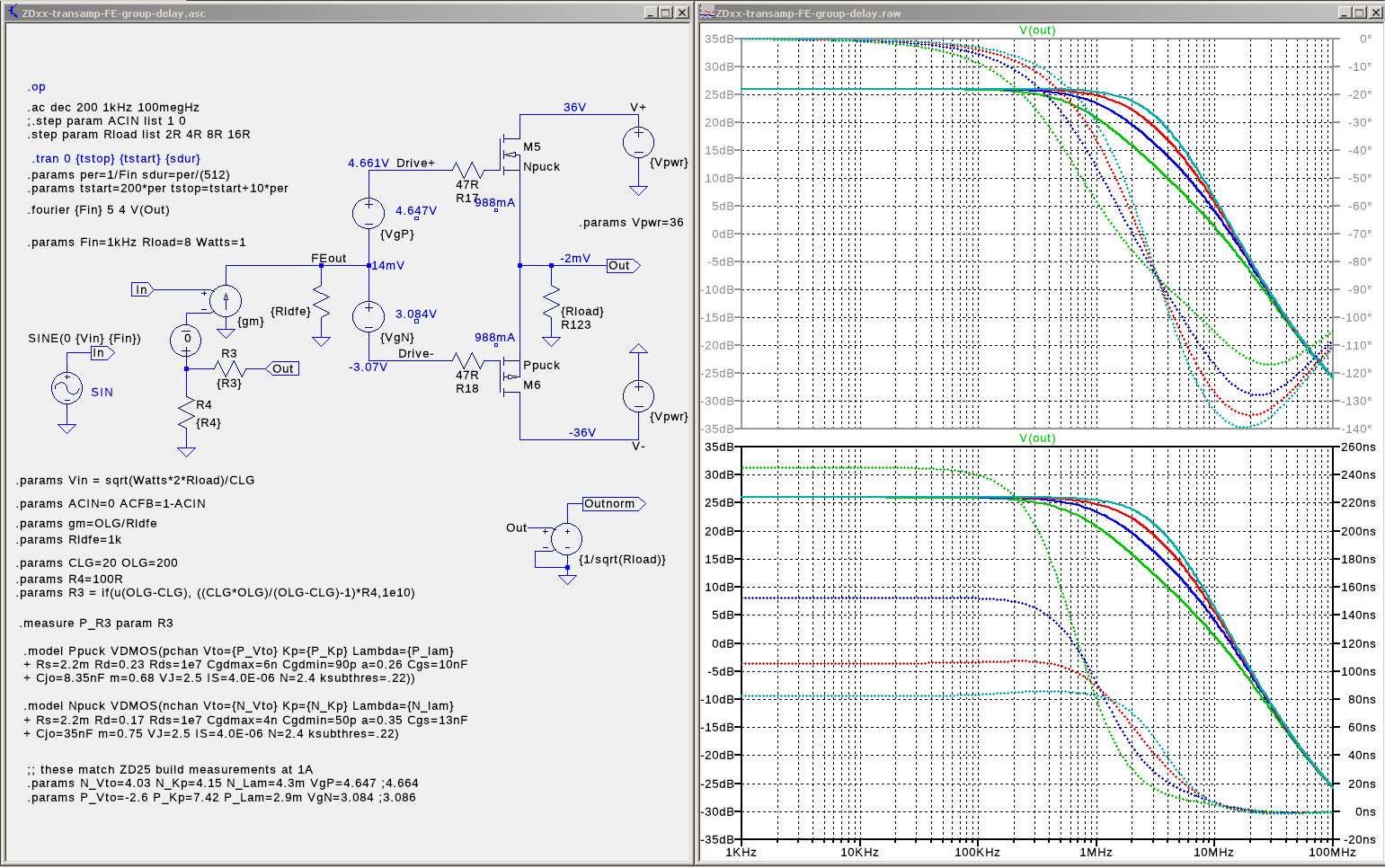

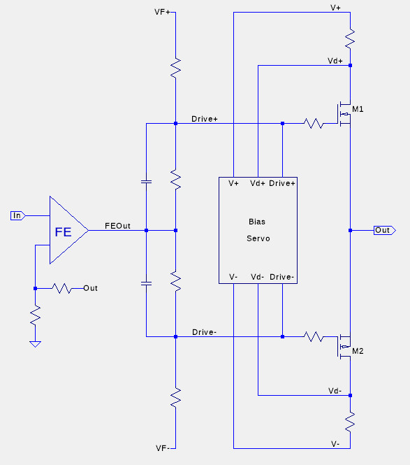

While waiting for my new power supplies I couldn't resist more simulations. I am still trying to understand the effect of load resistance on the distortion spectra. Below is a test circuit for undegenerated output fets, using an "ideal" front-end (FE).
The first set of plots shows the distortion spectra for 1kHz, 1W, and 20dB feedback with four values of Rload: 2R, 4R, 8R, and 16R. The top row is normalized V(Out) so that the fundamental is at 0dB for all loads.
The second set of plots shows the test circuit and the AC response for all four load resistances. The top AC response curves for phase, whereas the bottom curves show group-delay. I find the group-delay plot to be very interesting.
Attached is the .asc file and a file containing the LTSpice .fourier log numbers.

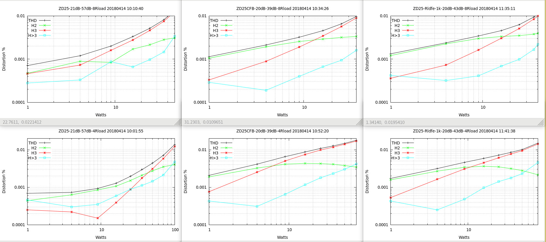

Without adjustment, the FE will have some amount of second harmonic (H2). There are many possible ways to make such an adjustment, including the choice of JFETs. What are the "proper" conditions for measuring the neutrality of the FE? one approach is to connect the feedback resistor to the FE output rather than the OS output and adjust the harmonic spectrum of the FE output. Should the FE be loaded by the OS FET gates when making such measurements?

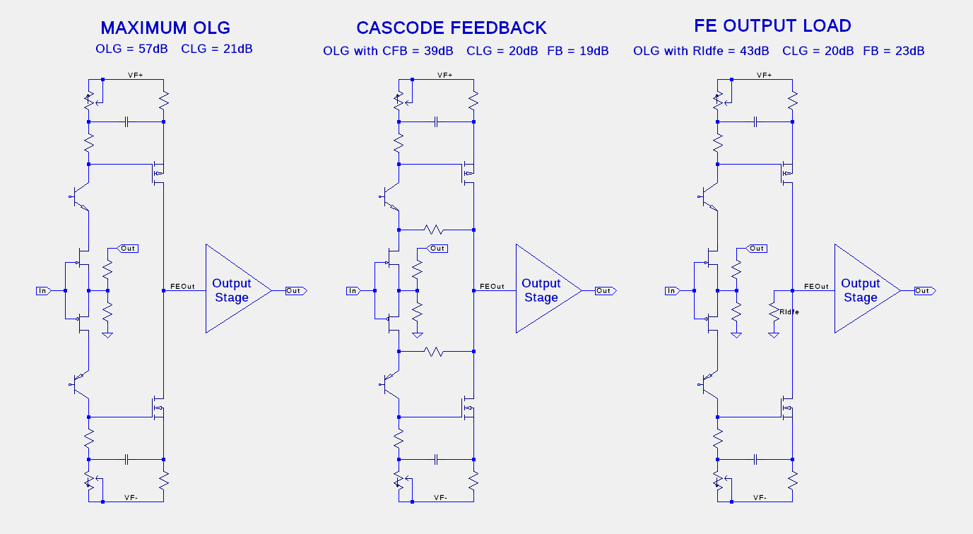

I started bench measurements about a week ago and discovered problems with distortion measurements because of the change of output FET bias with power and load resistance. After modifying my software for distortion measurements I was able to capture the output signal faster before the bias changes significantly. Below are some results.
These distortion sweeps are for 3 different configurations, shown left to right:
  1. maximum feedback
  2. feedback limited using cascode feedback
  3. feedback limited using a load resistor on the FE output
The top row of sweeps is for an 8R load; the bottom row for a 4R load.

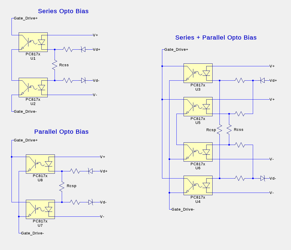

Based on both simulations and bench measurements of long signal bursts (30 secs), both the the series optocoupler and parallel optocoupler bias circuits have a significant drift in bias as the power is increased or the load resistance is reduced. Bias increases with the series circuit and decreases with the parallel circuit.
Below is a hybrid of the series and parallel bias circuits that significantly reduces the drift. For 25 Watt signals into 4R and 8R loads, the drift is reduced to about 6mA.

which one you prefer?
The high feedback measurements in the left column are best, and I have been listening to this configuration for many months. Sounds great! I have not seen any stability problems due to the high feedback.
I have not listened to either of the other two versions, and it would probably require building a complete amplifier in order to do A/B comparisons between two versions at a time.

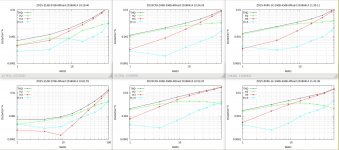

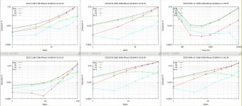

I just noticed that the distortion sweeps in the upper right corner in post #1508 was the Frequency sweep rather than the the Watts sweep. Here is the corrected set of sweeps. Notice how similar the cascode feedback and FE load versions are for both 4R and 8R loads.

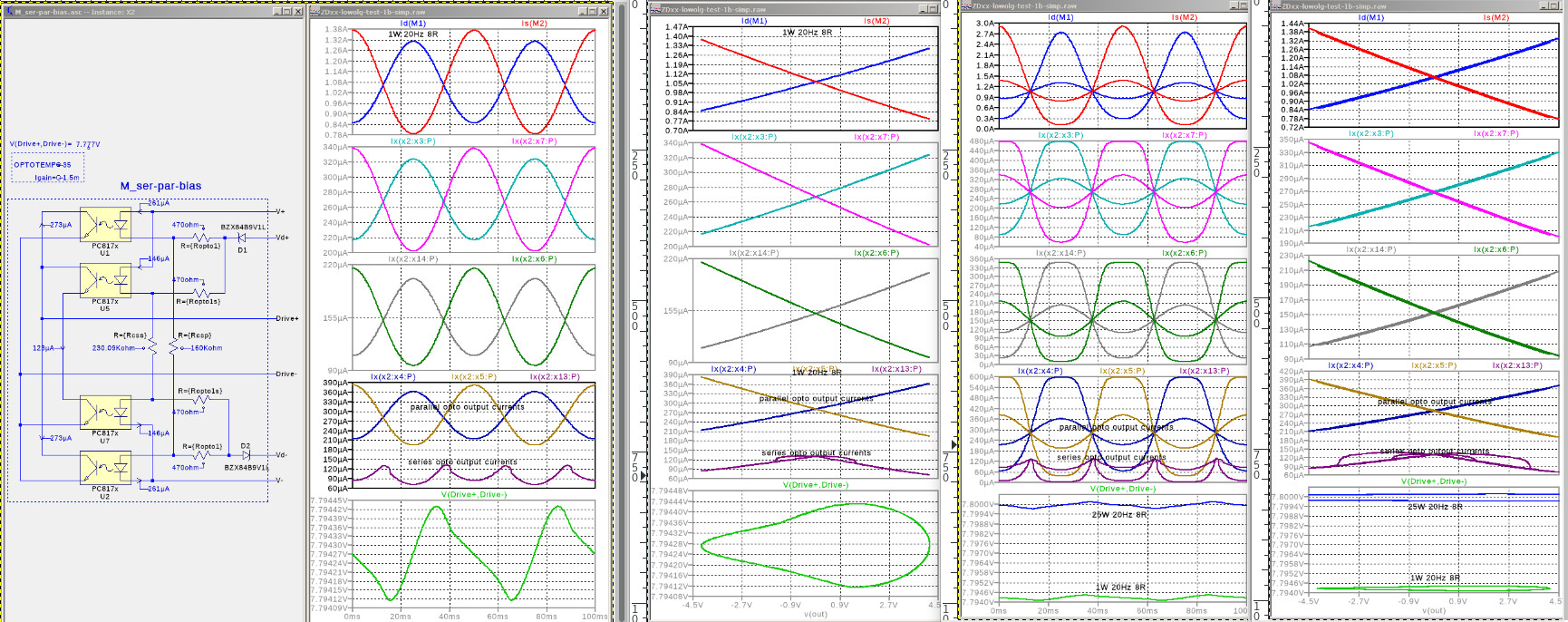

Do you know why the bias drifts with power and load resistance? Has it to do with leaving class A or is some other factor responsible? I can see that your series/parallel combination will work but it would nice to avoid the additional complexity if at all possible.

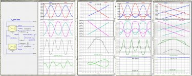

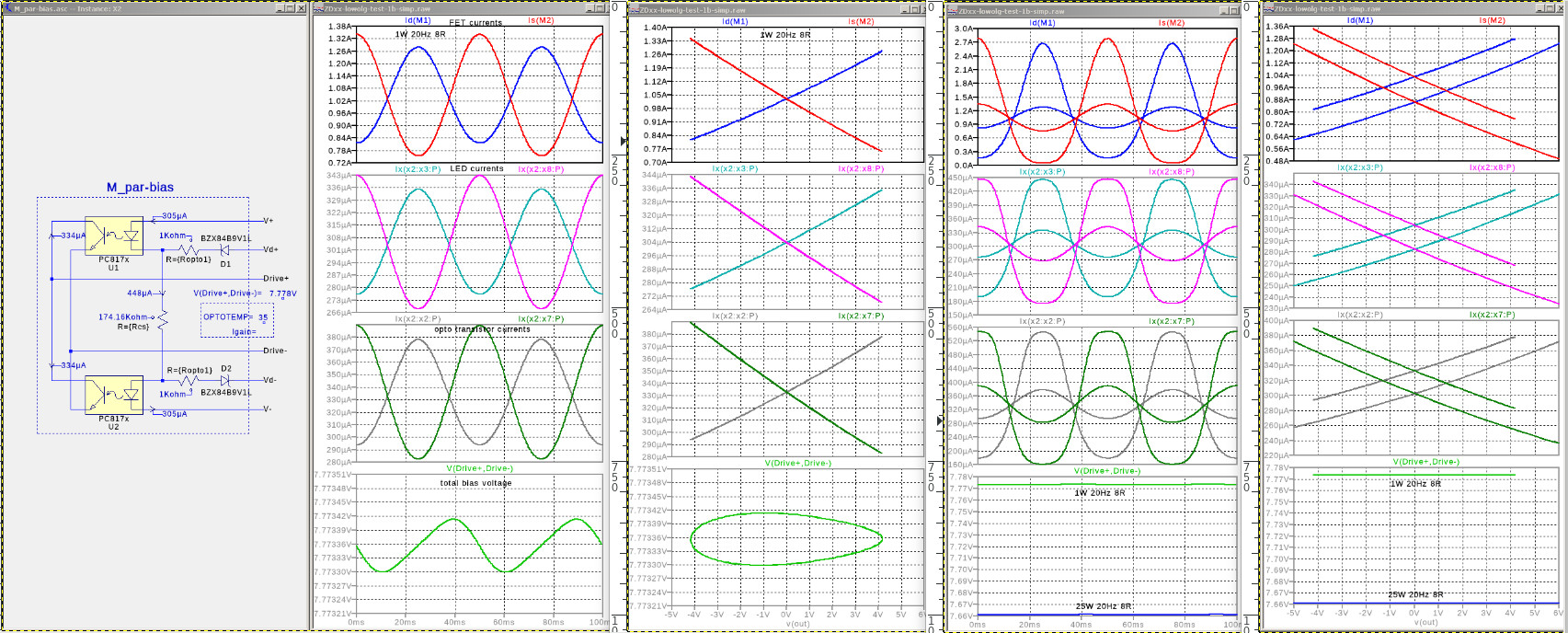

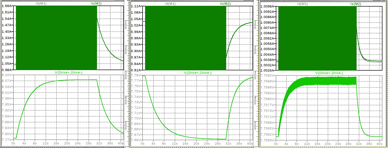

The bias drift vs. load resistance is easy to explain. For a given output power the fet current range increases as the resistance is lowered. The remaining question is why the bias changes as the FET current range increases. It is apparently due to the increasing asymmetry of the FET current waveforms as the current increases. The behavior is the different for the serial and parallel opto configurations. In the series configuration, at higher current levels (more asymmetric) the time integrated current output from the servo is insufficient and thus the voltage V(drive+,drive-) increases. In the parallel configuration the opposite occurs.

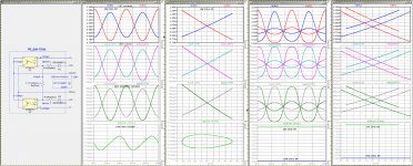

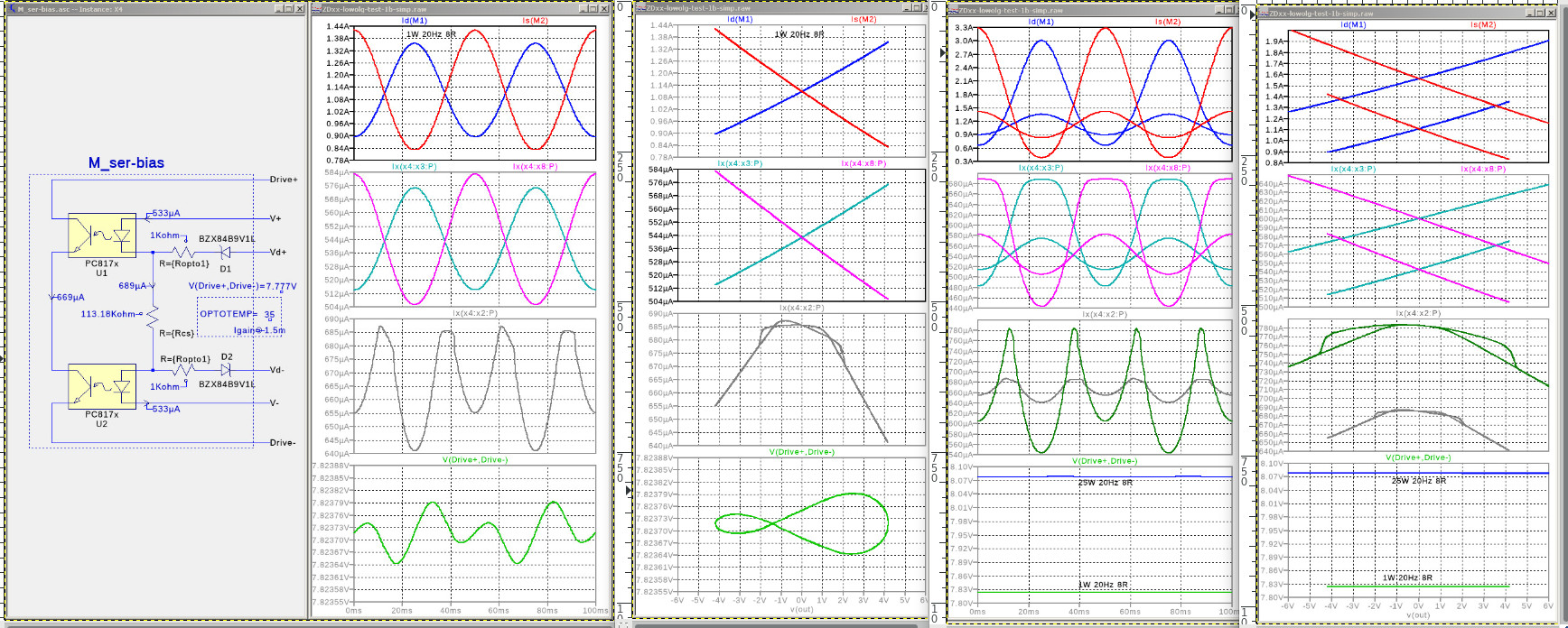

The images below show:
  • circuit topology
  • series optocoupler servo and waveforms
  • parallel optocoupler servo and waveforms
  • hybrid optocoupler servo and waveforms
From left to right are:
  • servo circuit
  • 1 W waveforms vs. time
  • 1 W waveforms vs. V(Out)
  • 1W and 25W waveforms vs. time
  • 1W and 25W waveforms vs. V(Out)
From top to bottom the waveforms are:
  • FET currents
  • LED currents
  • Opto transistor currents
  • V(Drive+,Drive-) total bias voltage

Here is another presentation of the behavior of the 3 servo configurations. Shown is ar the FET currents (top) and V(Drive+,Drive-) total bias voltage for a 30 second duration 20Hz 25W pulse into an 8R load. From left to right are the series, parallel, and hybrid configurations. Note the vertical scales in the plots. The bias drift for the hybrid configuration is less than 3mA.

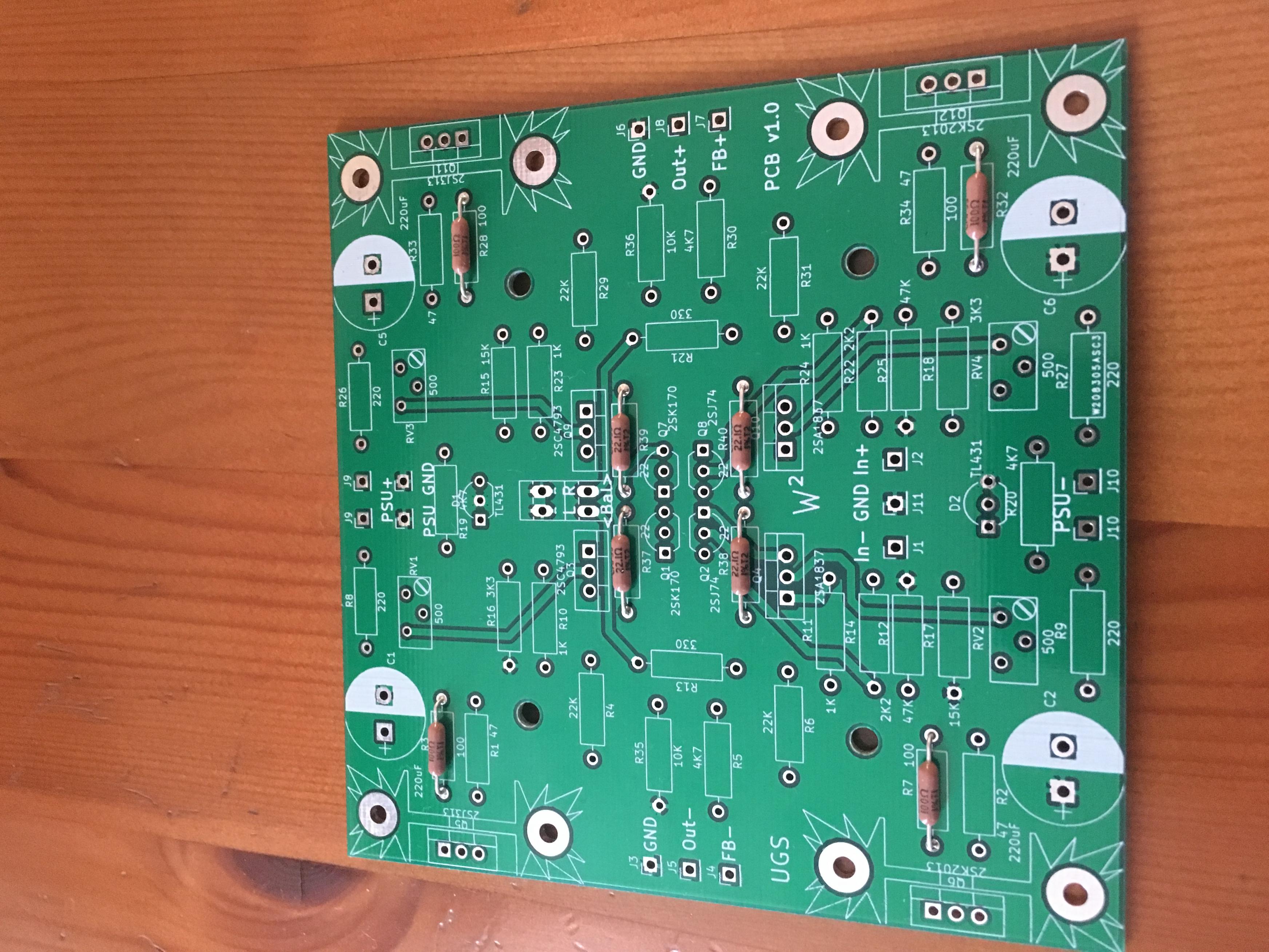

This is my version of the frontend, kind of UGS - Sony VFET pt2. Learning how to use Kicad finally pays off. I can configure this PCB in many ways to experiment. With or without degeneration of the small MOSFETs, EUVL trick for the JFET's or no degeneration at all. Balanced or left - right frontend.
Swiss army knife...
I will experiment with different output stages. But I think I will build this one Generg gave us first.

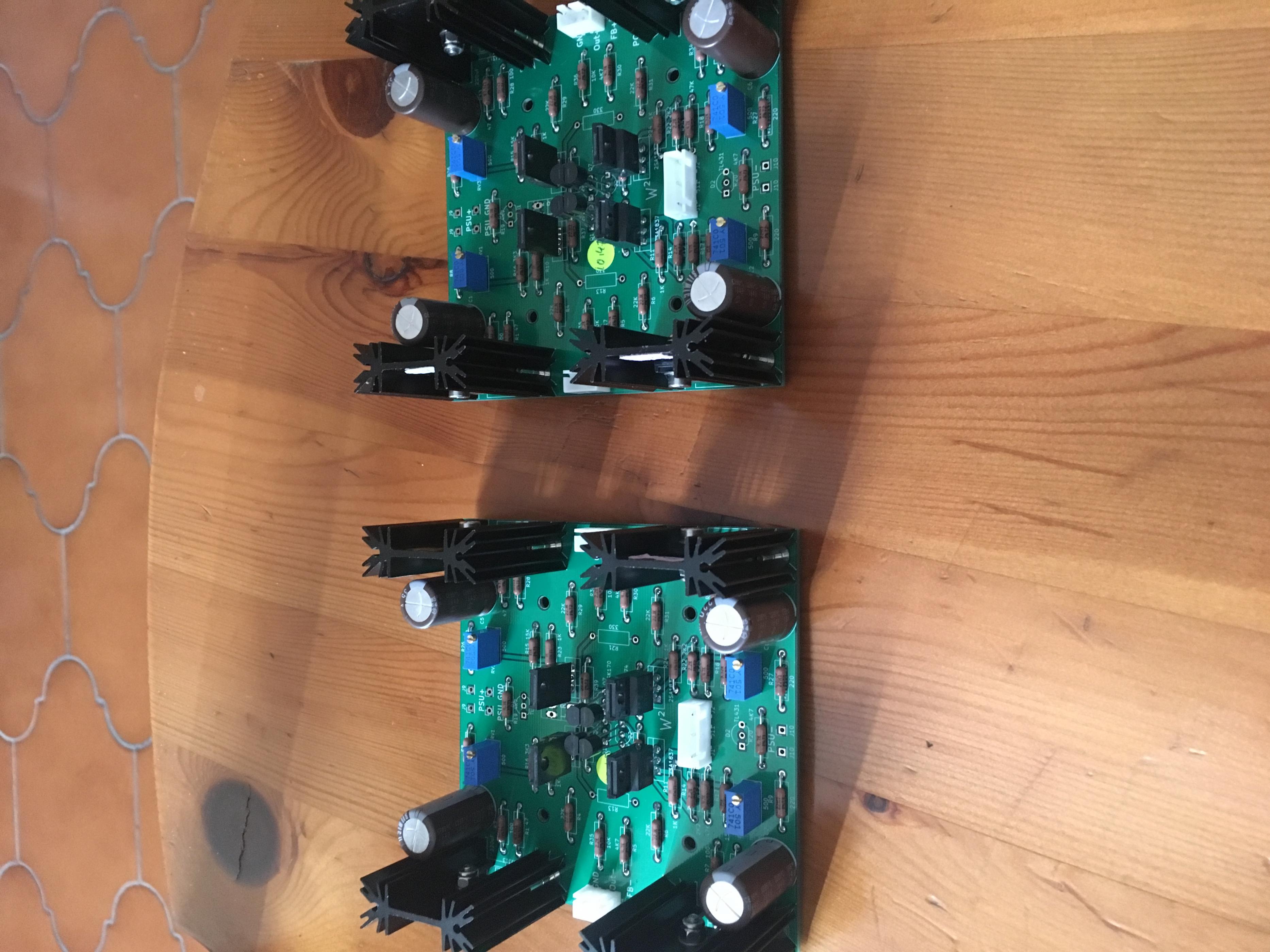

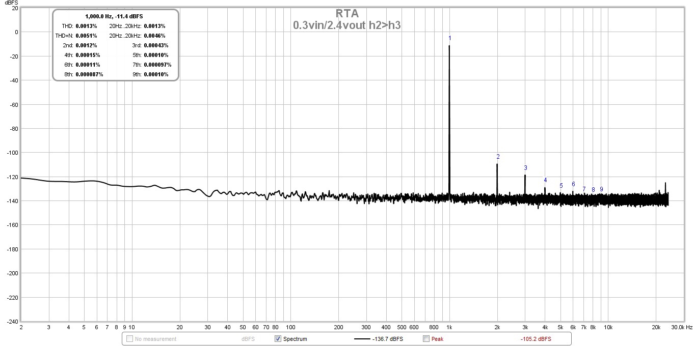

Thanks to Walter who shared with me 2pcbs I managed to build 2 balanced channels that I intend to use as a preamp after a dac.

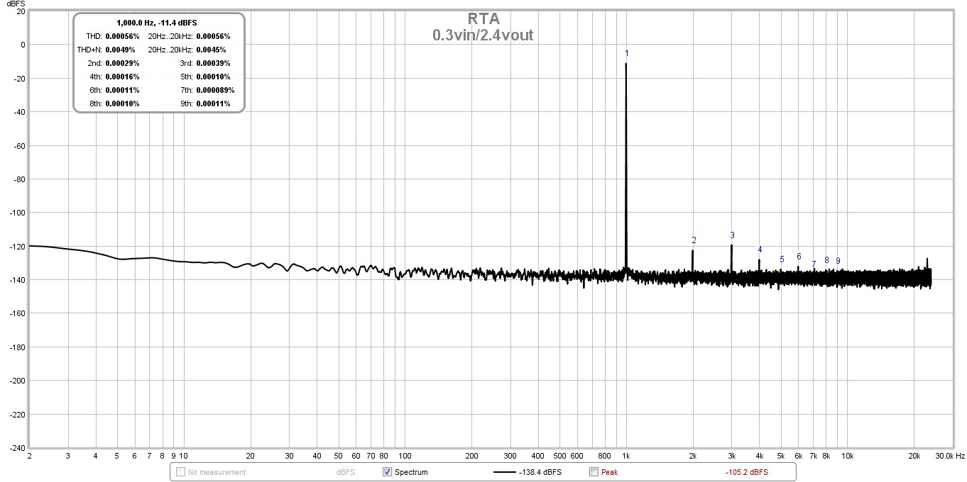

I did some thd measurements on the run and did get very impressed by the results.
My goal was not to get the lowest thd but to see if I can tune h2/h3.
