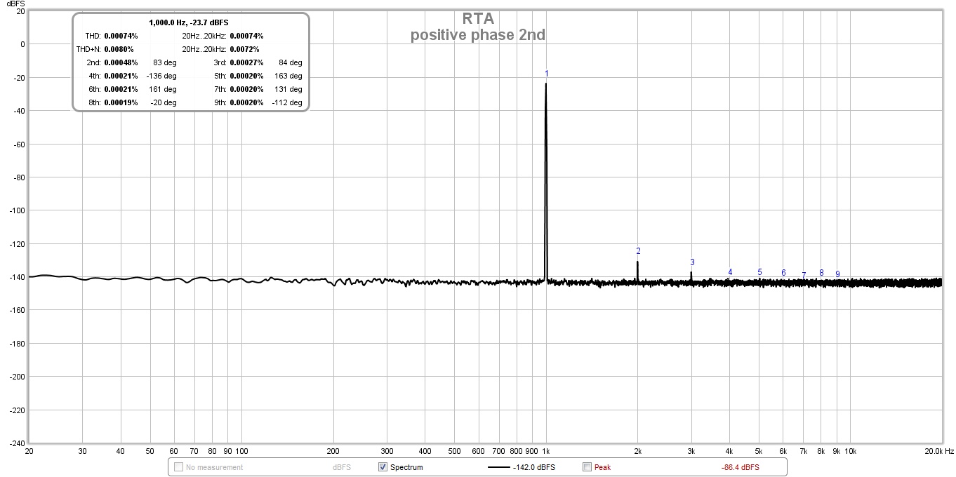

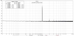

Wow, both plots look really impressing! Can you also go with positiv and negative phase to get the same H2/H3 relations?
Regards, Matthias
PS: Which software are you using, and which soundcard?
Yes you can tune h2/h3 to be positive or negative
I am using focusrite 2i2 soundcard and rew software
Nice to see 😀
How are you changing the H2 and H3? By modifying the source resistors of the JFET's or MOSFET's?
I am changing the harmonics by adjusting the load lines of the jfets(the pots placed in the collector of the cascodes)

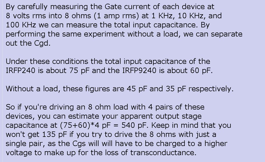

I am using IXFN140N30P and IXTN40P50P IXYS FETs. Look at the Crss curves in the datasheets and consider Nelson's comments about Crss and input capacitance in follower stages. Mosfet Output Stage Capacitance I seem to recall a BAF talk by Nelson which mentions the utility of the low Crss of a particular IXYS FET.
Thanks for the link. I will give that a try. It crossed my mind a couple of weeks ago to use a DMM to measure the AC voltage across the gate stop resistor. Nelson's idea to measure loaded and unloaded is a very nice touch to separate the two capacitances.
It might require a higher values gate stopper resistor in order to be able to measure the voltage drop. It might be better to use the technique for measuring input capacitance shown here http://www.firstwatt.com/pdf/art_mos_test.pdf.
Noted. I will try both methods and post some results. I also have occasional access to a CV measurement system and will save some tests and post those.
It will be a while as the day job is keeping me on the road quite a bit this year.
I thought more about using a DIMM for measuring FET input capacitance. It probably will not be accurate since most DIMMs cannot make accurate AC measurements at the high frequencies. Also, the parasitic capacitances of the DIMM leads and internals will introduce errors. An oscilloscope could work, but a differential measurement is required with a big common-mode component. It is probably much better to infer the capacitances from the output response vs. frequency.
