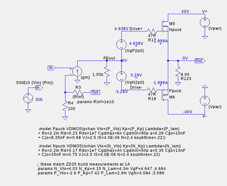

The problem is in the simulations. I have not yet built the low feedback version. The high feedback version runs really well.
I have run some simulations with "invented" pucks with matching transconductance (Kp) values. The distortion goes to below 0.001%, at 200Hz 4W 8R, even with zero feedback.
I have not been explicit about which FETs I am using since the purpose of this LTSpice file is to experiment with the FET model parameters as well as the other circuit parameters.

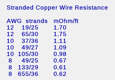

How much damping factor is enough? Consider that speaker wiring introduces resistance between the amplifier and the speakers and must be considered in the net damping factor equation.
If #10 speaker wires are 15 feet long (30 feet round trip), the the resistance will be around 30mOhms. That alone would result in a damping factor of 267, assuming R_int=0.
DF_amp = 8Ohms / R_int
R_net = R_int + R_wires
DF_net = 8Ohms / R_net
Below are some stranded copper wire resistances.R_net = R_int + R_wires

Is that the amplifier DF or the net DF? With 30' of #10 wires, if the amplifier DF=200, then the net DF is 114. It the net DF is 200 then the amplifier DF must be about 800.IME, 200 on 8 Ohm. But depends on the speakers.

The only thing impossible about having NFETs and PFETs with the same transconductance is the internal capacitances. At very low frequencies the even harmonics would cancel, but at high frequencies even harmonics get seriously bad. The design issue is to choose the "right" balance of the transconductances.

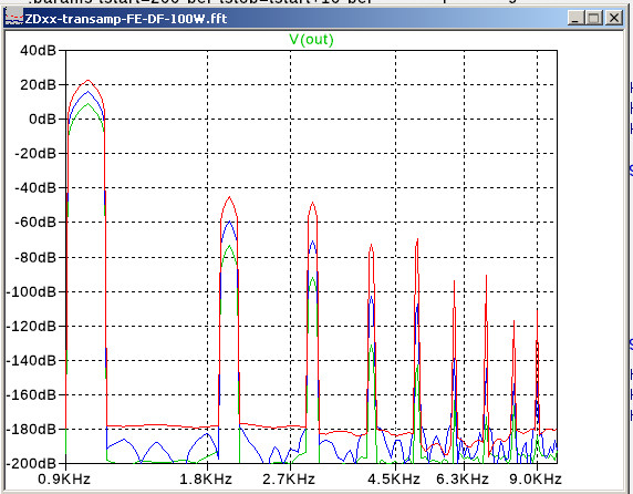

Yes, there are tricks to modify the harmonic character of the output stage itself. Without such tricks I see H2 about 18dB higher than H3 at 1kHz, 1W, 8R in the standalone output stage driven by a perfect front end with 1K output impedance. Below is the test circuit and the spectra for 1W, 5W, and 25W.
I have been running simulations where the FE is tuned to be as "neutral" as possible, i.e. so that the FE does does not introduce even harmonics, particularly via the feedback loop. This might help to reduce the variations of the output spectrum due to variations in the speaker load resistance. Work in progress.
