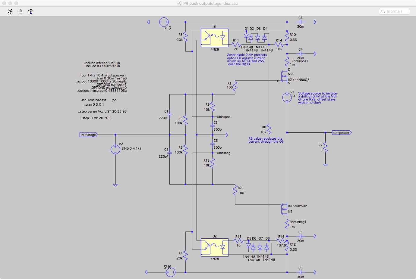

Peter aka PR made us a Pentecost present, his new idea for a puck output stage controlled by optocouplers.
It is for me a new and interesting way to control the OS stage. Regulation is not as tough as some other solutions but it is stable down to 1 Ohm load.
Please keep in mind this are only drafts and no instructions to build .....
😎... only Spice ghosts.....😎 not yet proved, but comments welcome!
What do you say ZM, Juma and ....🙂

nice looking
however , you already know that I'm strictly pursuing concept with no more than 0R1 in rails
also - from my own sims ...... 4x diode is hardly any protection for optoled ;

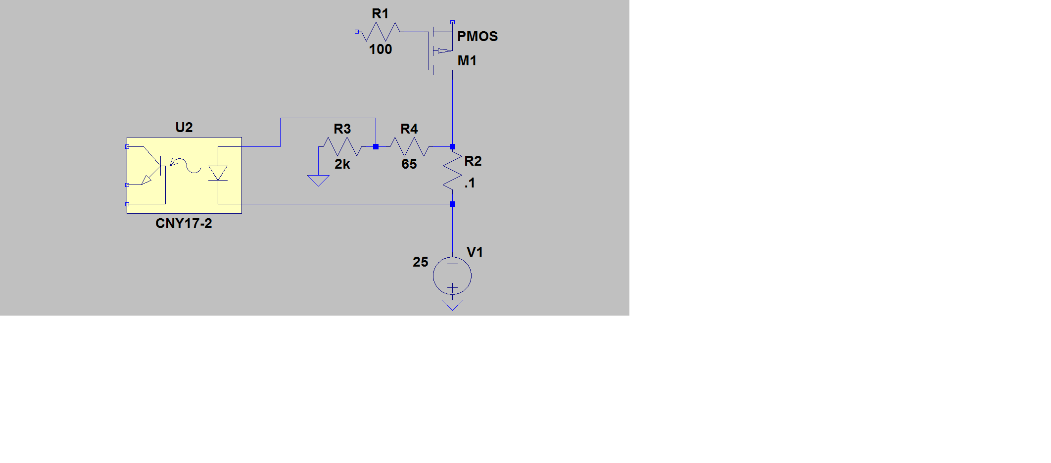

Is there any problem with giving the opto an 80% head start on the voltage it needs. That way the rail resistor could be lowered.
It is even more easy you can take the 0R1 and simply give the R8 a lower value.
Well generg, this simple idea is what I was asking about in post #895 but I didn't show a picture of it then.
Generg, your circuit above, at least on the transistor side of the opto, is exactly the same simple circuit I simulated. I put it aside when you said something about it being more important needing a bias circuit for the second stage. Did you come up with a bias circuit for the second stage then?

While there are really effective ways at doing this, I'm with you with regards to impedance on the rails.
I'm super anal about modulated rail voltages.
After trying a few clever circuits, I've gone back to my original version. It's dumb, it's simple, it works, and no worrying about it.
If I was to add resistance there I'd do something crazy like add 100,000uF after it to drop the impedance seen by the drain of the mosfet., which may or may not create some other problem to solve. Could you see a problem with stability putting a huge cap after the biasing resistor.
Edit: I see Generg has added 20,000uF there. Bloody sissy caps. Haha
Please keep in mind it is pr circuit, not mine. I could not do it.
Your are possibly an electronic engineer like Peter.....:--))
Similar Ideas?
Well no generg, if I had an electronic engineering degree I would have figured out this darn circuit by now. There is no need for me to go back to college at my age. If you have the passion to learn there is lots of information that can be found online, more than you would get from a college degree. I just need to dig in to it and fill in all those large holes in my knowledge.
Yes, a small part of Pr's circuit was the same. My problem is that I am to unsure if it will work in the real world. After I had finished the circuit I read some posts between Lynn and the mighty Zen about servos that made me unsure that it would work.

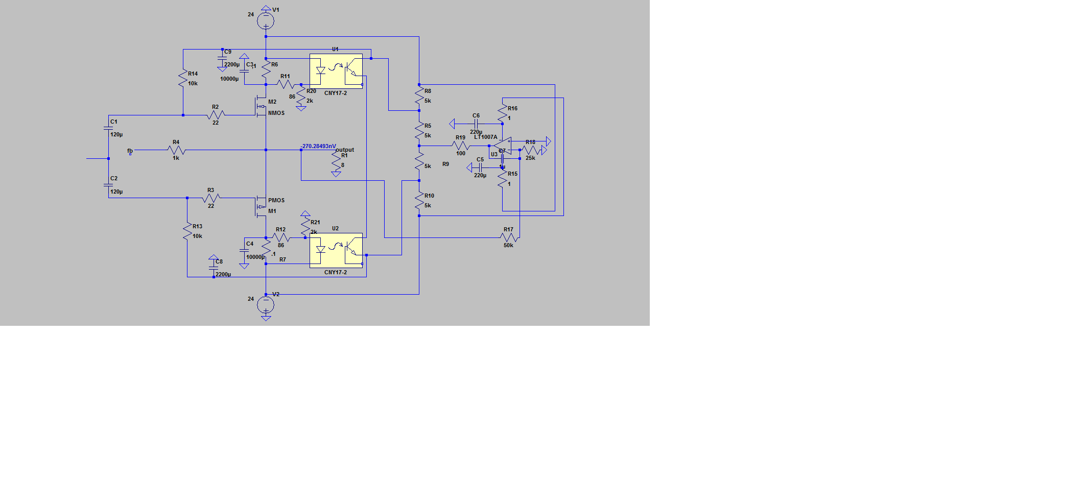

Here is a circuit I did which was inspired somewhat by Wayne's headphone amp.
I have not seen Lynn and Zen's solutions. Where are they posted, do you have a link. That sounds great.

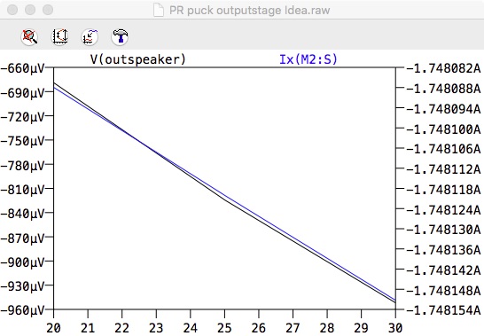

so here again the version that PR made to have an even better regulation.
Replace in the last picture, I add again, R3 and R4 20k by small CCS of 1mA loading the 330uF caps and the 10k R8 by a CCS with 10mA and you get this result for bias variation and the offset for different voltages of the PSU near the values of ZM and Lynn.

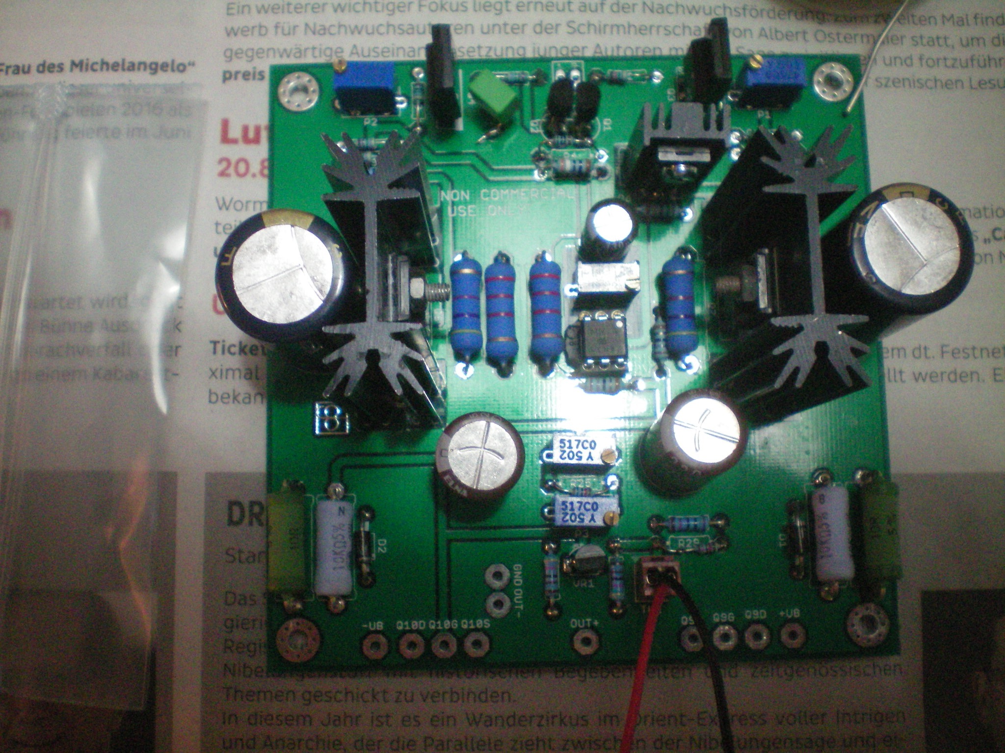

Next week I will hear this version with an optocoupler regulating the second stage without degeneration. Third stage is still "classic" with TL431.

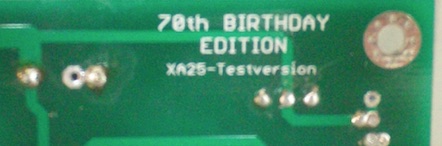

Friends made the board for me as a birthday present.
When this version sounds better to my ears the next step will be a combination of of this frontend and PRs OS with optocouplers or with his current mirror solution that is "fu..ing brilliant".
