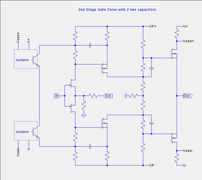

Scaling the power level
Now that we understand some approaches to building a stable amp with no degeneration and having one pair of common drain output FETs, I pose the following challenge: How do we scale the power up to 200W/CH or more? I see two options:
Forced air cooling of a single pair of output FETs at the higher power levels using a heat-tunne.
Multiple pairs of output FETs with a drain current sense resistor and servo for each output FET.
There are problems with each approach. I am not sure the the multiple servo approach can avoid undesirable servo interactions.
Any takers?

deja vu ...... and I can't remember from where it is
just take stereo amp , then bridge it and x-it as BA3 Bal
play with local and global feedback amounts to set THD spectra
or is there something more logical ?
Yup, bridging two 50W @4R amplifiers (XA25) that will take you to around 100W @8R. How do we get to 200W or more? How much power per FET with a SOT-227 footprint can we dump into a convection cooled heatsink? I guess I need to run the the thermal convection heatsink simulator NatSink NatSink to get some estimates.
Yes. 200W or more. I am thinking of a design that would extend to the highest power levels of the XA.5 and XA.8 series amplifiers.200w/8ohm Class A?

just an idea - tried more than few times - common FE , multiple output stages
then do with them what you want
find simple enough and elegant way of biasing one vertical pair , then put zillion in parallel
not necessary to have drain current senses as part of CRC ........ or you can even have big C then separate (smaller) rc cells per each vertical pair
really ...... more than few possible choices

One pair of mosfet should be enough for that power with forced cooling.
I dont know how much you can reduce bias, because of class A envelope.
150w disippation per mosfet, or more ,seems to be possible with forced cooling.
In that case (non bridged), small CL voltage gain start to be unpractical.
I bet that amplifier is stable with given gain and amount of feedback, but I doubt that we can easy increase OLG and keep stability.

How about a single temperature stabilized FE with each output FET having a thermistor on the spare source terminal to stabilize the FET current to reduce current hogging? It will not be perfect but perhaps adequate.
