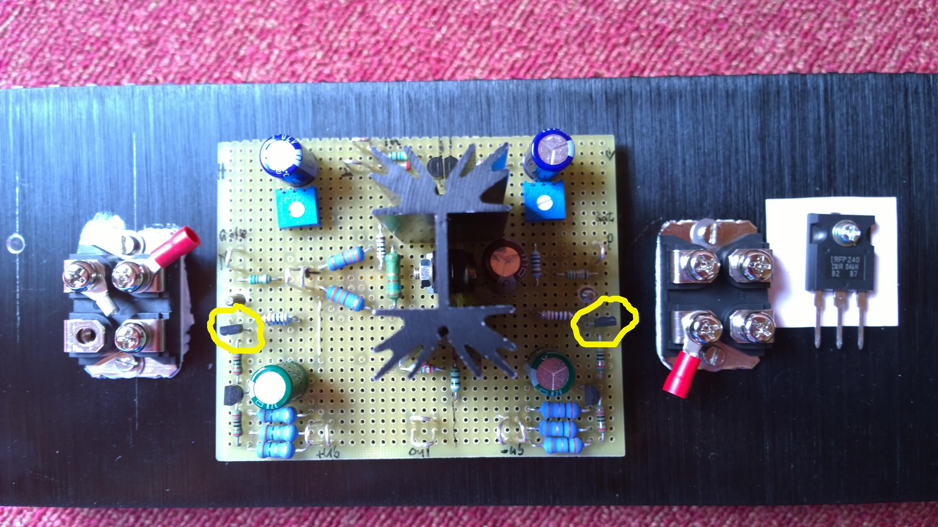

O.K. here we are. DC - testing done on both channels. Idle regulation works like simmed. Have to stop now. AC - tests follow after easter. Fortunately no poof.
Regards, Jürgen
Hi Jürgen,
I try to build your version on a perfboard too...
Only thing irritating me is two more BJTs that are not in your circuit.
Did you cascode the J-Fets?

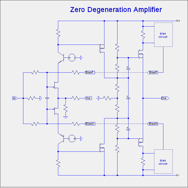

Here is a circuit topology that simulates well and whose bias at all stages is thermally stable without the using thermistors. It is unusual because of the negative feedback of the DC current through the output FETs to the JFET gates. The "secret" is in the design of bias circuit.
if you are going to have dedicated bias circuits (in other words current sensing custom converters ) ......... gate is last place where you need to push
at least for my logic
I have no doubt that everything behaves well in sims , but you know those gates ..... they can feel Sparrow flying 300m away ....
I have not yet bench tested this circuit, so I do not know how it will behave in practice. The main reason that I considered feedback to the JFET gates was to reduce the thermal drift due to the temperature coefficients of the JFETS. The alternative of using negative DC feedback to the gates of the 2nd stage MOSFETs requires a bias circuit with much higher current gain and appeared to require a considerably more complicated bias circuit.if you are going to have dedicated bias circuits (in other words current sensing custom converters ) ......... gate is last place where you need to push
In the simulations of the thermal drift from 20C at power-on to 60C at operating temperature, only about 0.4uA variation of the DC feedback to the JFET gates is required to maintain the output stage bias current to within 20mA. That is a temperature coefficient of about 0.5uA/C.

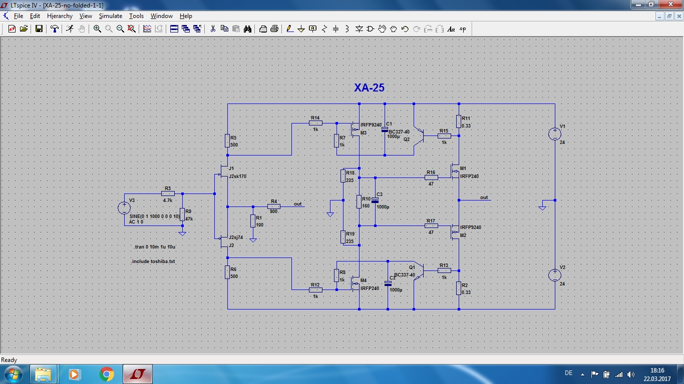

It shows at first glance a good behavior in LTSpice and possibly in real too.
No more opto couplers and thermistors and......and....
but only Nelsons good old cascode feedback to the first stage.. Because of PSSR it is possibly necessary to use TL431 for the J-Fet cascodes as in Sony II.
Oh my God, what a trip this thread.....may be someone has a Christmas Egg this year and the drama goes on, doesn't it Jeff.....?
Here the circuit with the 0R33 resistors pozo1992 suggested.

Hi Jürgen,
I know I am late but those easter holidays in Venice....
The components you encircled are the ZTX bipolars used for idle control, the other TO92 components in the picture are LM385`s (not shown in the schematic) to allow class AB mode - a trick stolen from the Firstwatt M2 schematic. Still left is a lot of data to be checked and tested.
I did not cascode the JFETs.
Sorry for the confusion caused.
