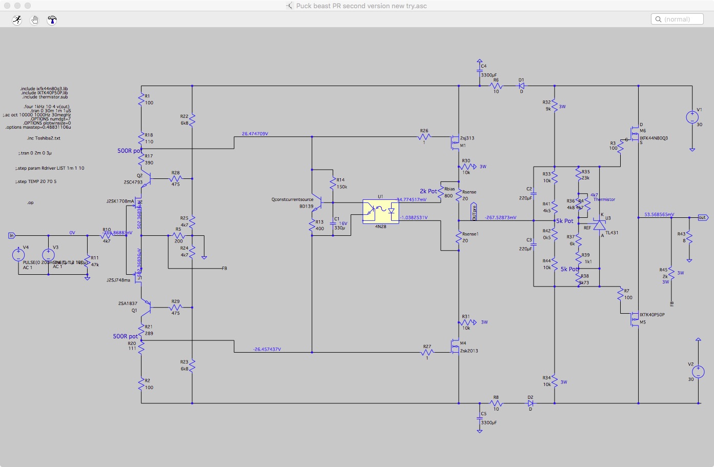

Next thing I will do, I will finish and hear this circuit, done by Peter (pr) for me.
http://www.diyaudio.com/forums/pass-labs/300233-f4-beast-builders-81.html#post4996543
Here exists no degeneration in all three stages.
Of course the regulation ist not the one Nelson uses. It is only done for the second stage with an optocoupler to avoid running away.
It behaves good in Spice and I hope same in reality.
One step further.... :--))

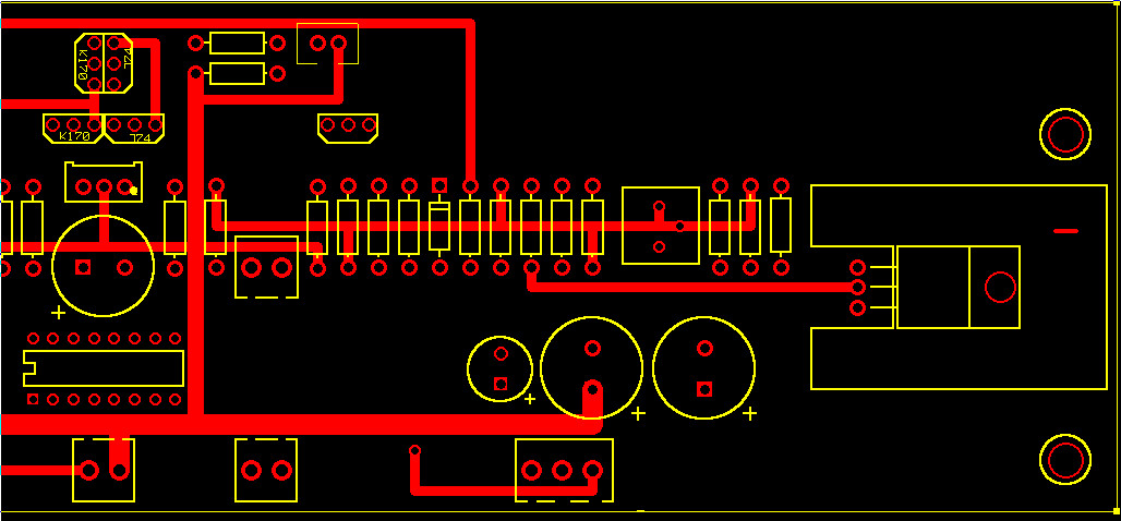

And I am making great progress in intentionally obscuring my circuit topology in the fashion of the XA25 photo. Everything important is on the other side of the PCB which is not shown. 😛
Generg, when you build sch. in post #983 try using 100R/10R in feedback loop instead of 2k/200R (R45/R5) and listen to difference.
10R should be 1W or so and 100 R can be made of 3 x 330R/2-3W paralleled ( it's close enough).
That is (almost) exactly what I am doing. My simulations show that the amplifier is capable of rather high class-AB power levels, so with that in mind, what is the necessary wattage of the 100R feedback resistor? I solve the high open-loop gain problem by loading the FE output at around 390R rather than using cascode feedback.
