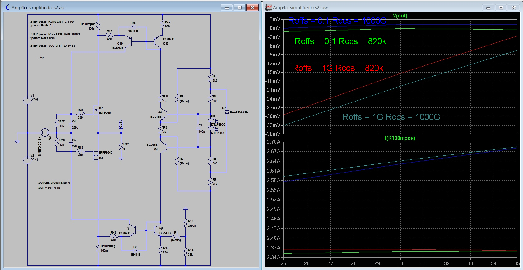

The Pr BJT circuit has the appearance of a current mirror, but I do not think that really is a current mirror. In the first of the circuits shown in post #1026, Q10 is just a common-base amplifier circuit. Q12 establishes the base voltage of Q10 and Q12 being defined by R30*.5mA (CCS current) and Vbe(Q12) which is temperature dependent. The Vbe temperature coefficients of Q10 and Q12 (mostly) cancel.
Yes,Lynn,that is correct.
I like to add, that the 220µF capacitors are charged by Q10 and Q9 and discharged by R27 and R28 (pos and neg side independendly). Therefore the value of R27 and R28 only depends from the time constant they form together with the 220µF caps.
R42 und R48 define the gain of the stages.
The bias for the output MOSFETs can be set by changing the values of R30 and R10.
A little bit more explanation:
The chosen constant current source in the appended file is not a simple one but compensates the influence of changes in the power supply voltage.
The common part - thermal stability:
The two LEDs are said to have nearly the same thermal coefficient as the bipolar transistors, so two of them in parallel with Q3 and Q4 should deliver a thermally constant current in both collectors. Noise is suppresed by the 100µF capacitor. To make their oparating current less dependant from the power supply stability, a zener diode stabilizes the voltage over R4 and R5 which in return stabilzes the current through the LEDs.
2 special features - compensation of power supply influence:
R8 and R9 compensate the influence of the changes in the power supply voltage to the bias current of the power MOSFETs I(R100mpos). In the graph I(R100mpos) is constant for R8=R9=820k. But if these resitors are left out (R8=R9=1000G=1TeraOhm), noise signals in the power supply are reflected in the bias.
R14 ist used to trim the output offset to zero. And R13 compensates the influences of the power supply voltage to the offset, as shom in the graph: Vout is constant, with Roffs=0.1 (Roffs in this simulation is used like a switch).
The bonus - D4 and D5:
The diodes protect the bipolar transistors,when the current through the 100mOhm resistors rises above about 50A. In that case Ube can become >5V, which exceeds the limit of typical small transistors. The diodes limit the voltage to 0,7V.

Pr: Thank you for the good explanation. Have you actually bench tested this circuit.
I am interested in how well the LT3092 might perform in comparison, since it replaces 13 parts by 2 parts. ZM suggested using the LT1634-1.25 precision voltage reference with the LT3092. That might be useful if absolute current accuracy was required, but I do not know if it provides any other benefit.
No, only simulation.... I am not retired, I have to go to work, so not much time left...
In my personal opinion absolute current accuracy seems to be less important than suppresion of noise signals from the power supply. In my amp temperature between winter and summer is only about 15k, so I do not expect much change in bias. I could imagine that a precision current source is a litte over the top here. But we are DIYers and we like it over the top... (me dreaming of a bridged amp with 3 IXYS in parallel on each half and side, so 12 in total per channel, and that is over the top😀)

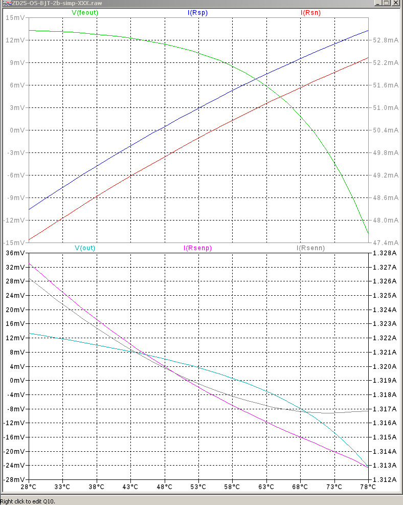

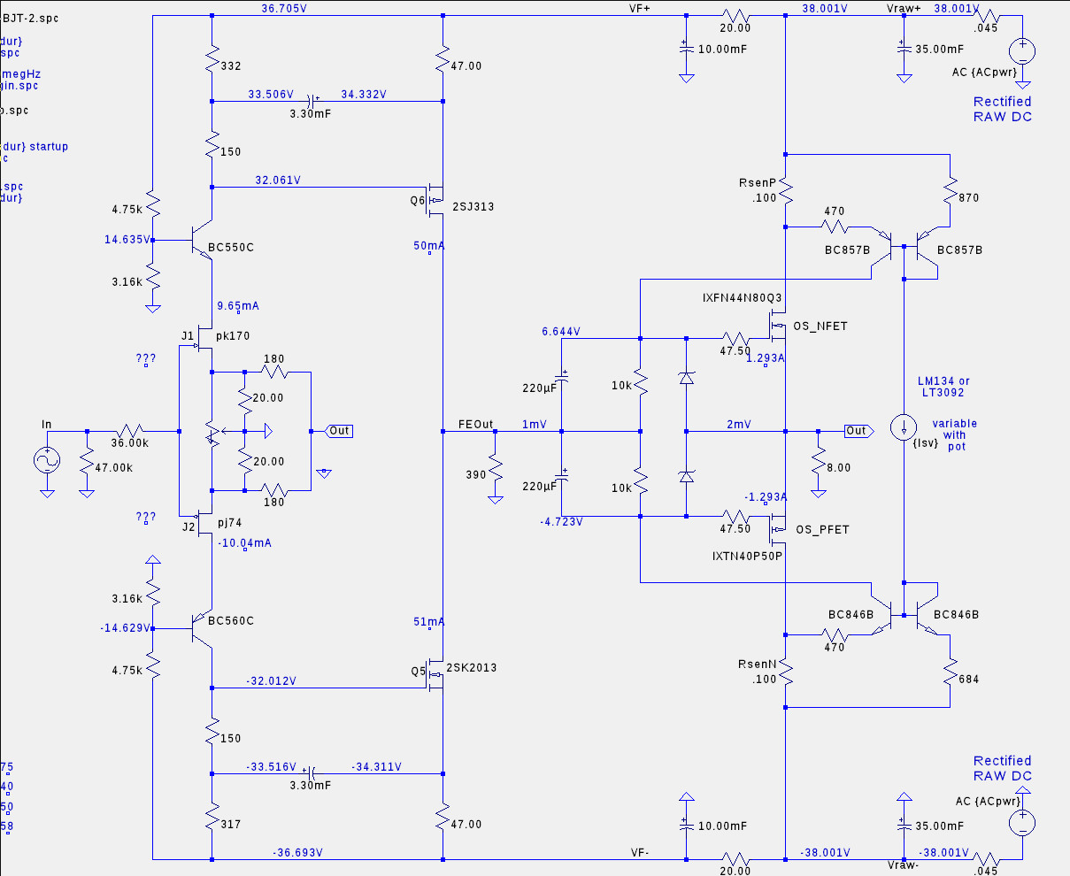

Here is a (nearly) complete amplifier with the BJT servo in the OS and a FE with DC degeneration of the J313/K2013 FETS and no servo. The JFET sources are driven in the manner of the F5, with independent feedback networks for each source pin. The parameter values have not undergone final tuning, but so far the performance looks quite good.

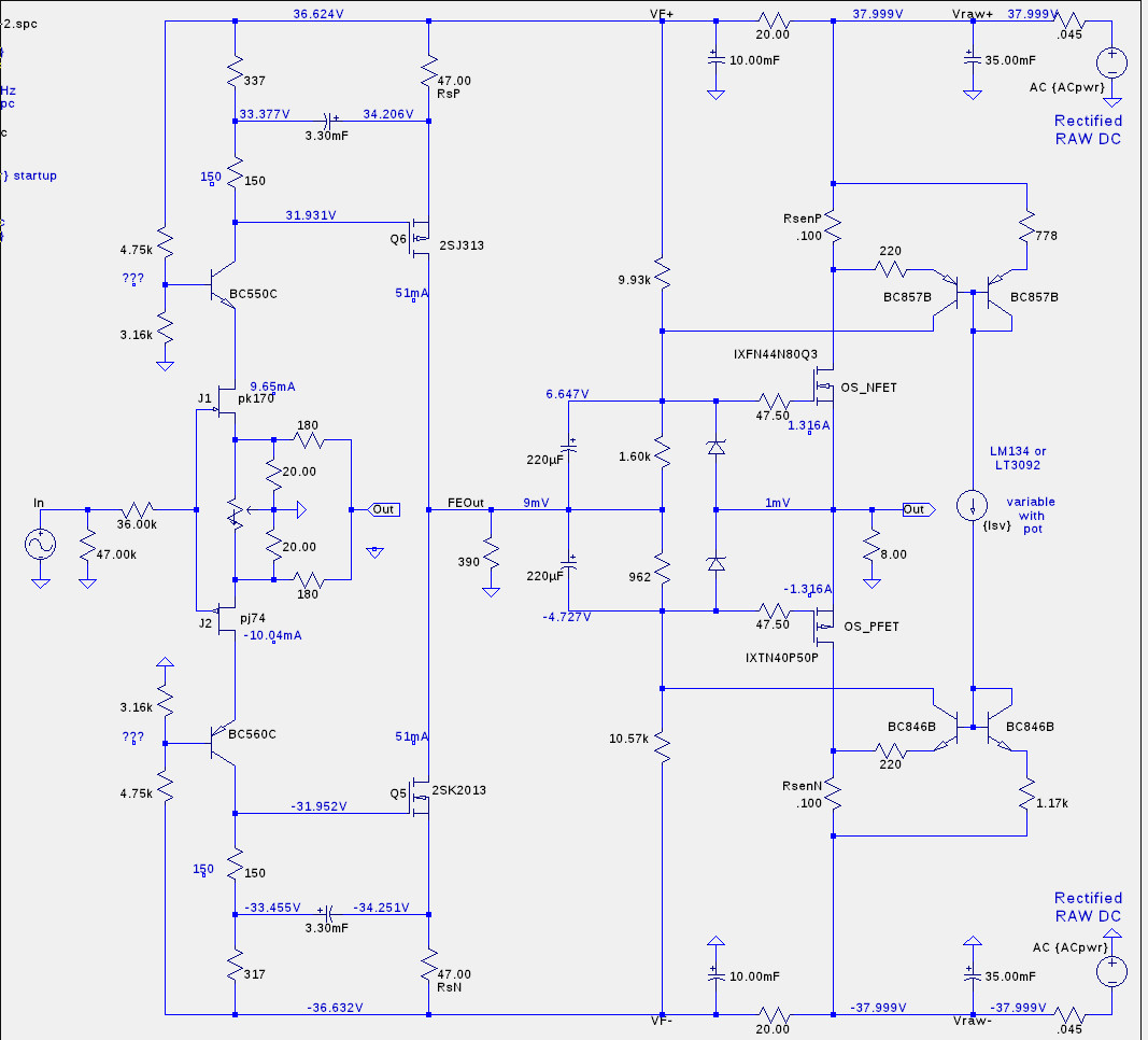

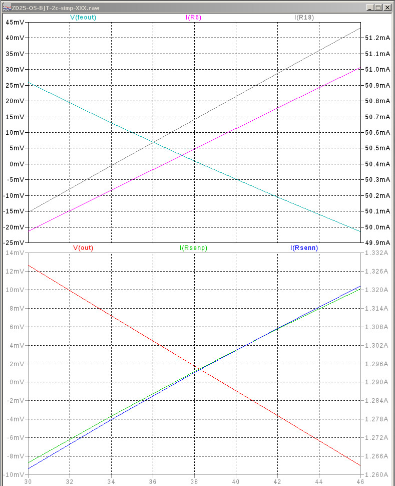

My previous circuit had leftover resistors from OS gates to rails that introduced PSRR issues. Here is a revised circuit that is more like that from Pr that has good temperature and rail voltage insensitivity. The plots below are FE and OS parameters vs. rail voltage.
