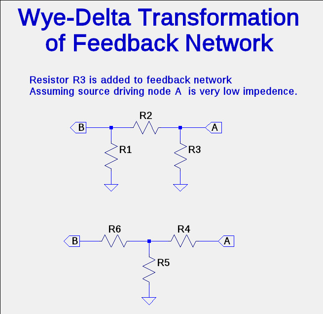

Ian: Good points:
- Stability: The LTSpice simulations show that the phase margin is "on the edge" of instability, properly measured within the feedback loop rather than with respect to the input.
- Degeneration: That is a good question. Using a wye-delta transformation, a two resistor feedback network can be converted to a lower impedance two-resistor network with a series resistor at the output. This is not exactly equivalent to the original network since it presents a lower impedance to the source driving the network. In any case, the resistive feedback network presents some level of degeneration.
- Doubling up: I agree that my circuit does not support putting multiple output FETs in parallel.
Thanks for the rapid reply 🙂
If stability is on the edge as you say, that raises the question of what is the output impedance or damping factor of your circuit? If it is well in excess of 500 then I suspect that Nelson must be using some feedback round the front end in his XA25. That might be a good idea here too although I know that many variations are possible, some mentioned earlier on in this very thread.

I finally measured the simulated damping factor. The results are hard to believe.
Test conditions: input is a .8V P-P sin at 1kHz
Measurements:
- 2R 8.19326V
- 4R 8.19326V
- 8R 8.19343V
- 16R 8.19351V
- 100R 8.19358V
Taking 2R and 100R
df(8.19326, 8.19358, 2, 100) = 47934.55761184867
Taking 4R and 16R
df(8.19326, 8.19351, 4, 16) = 49159.06000011457
that amp is completely insane
Taking 2R and 100R
Taking 4R and 16R
They are roughly what I would expect with all the feedback applied globally. Rdson for the IXTN40P50P is 0.23R giving a damping factor of ~35 into 8R and if your open loop gain were around 63dB, which is quite possible in practice, then the damping factor is going to be around 5000. This suggests to me that the XA25 either has a lower open loop gain or more local feedback, or perhaps both. My concern here is not so much the damping factor but the worry that so much global feedback may well result in instability.
