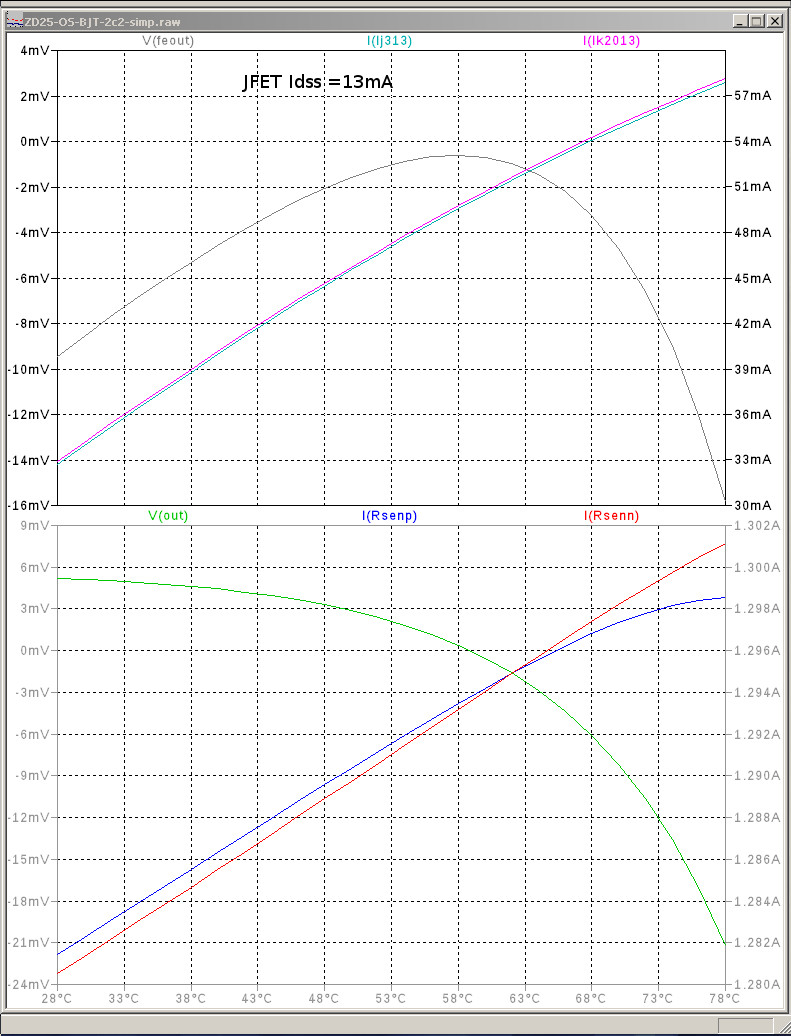

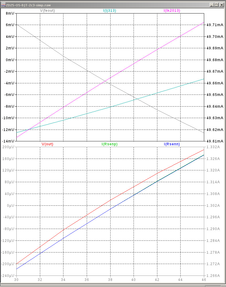

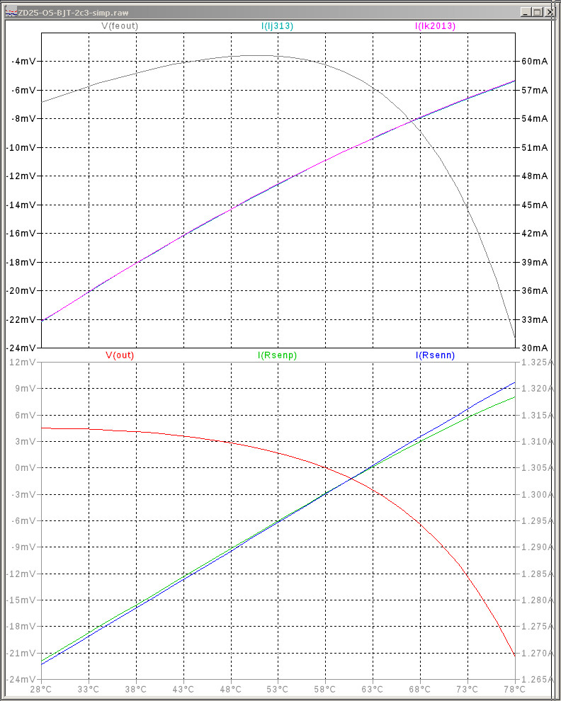

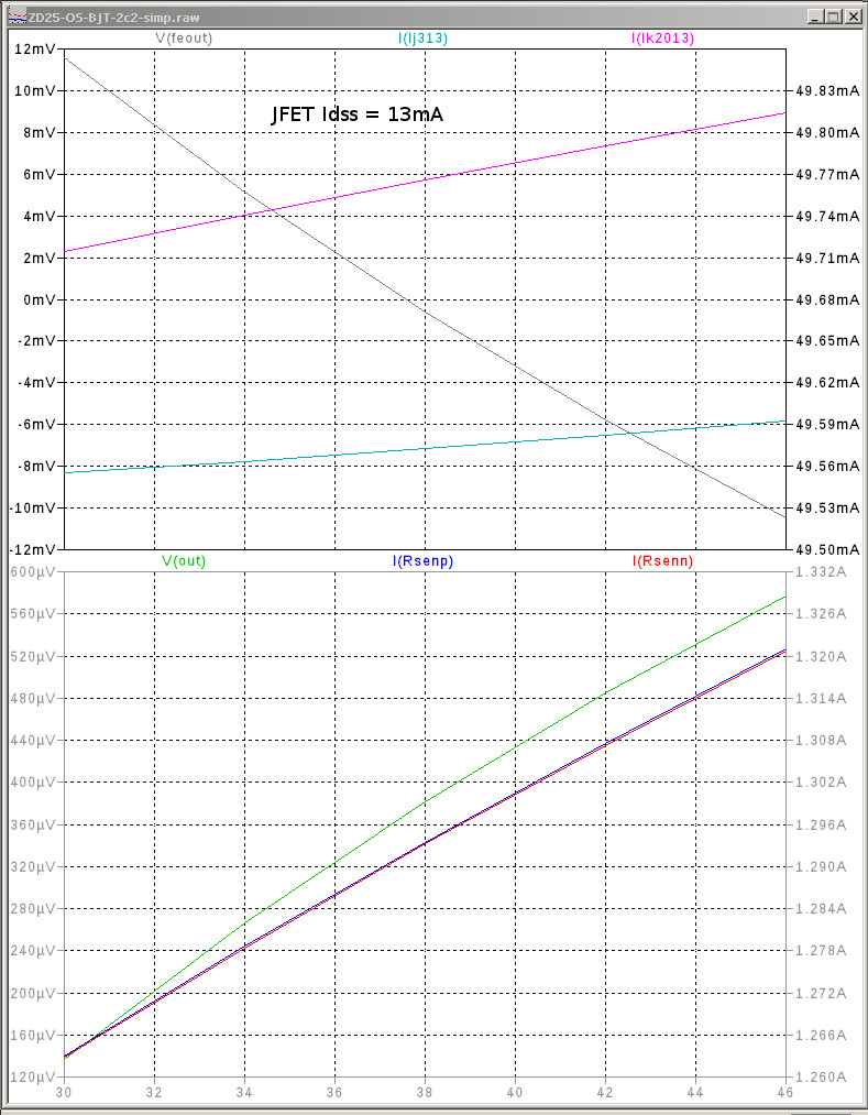

No degeneration and BJT servo on OS only. Good temperature stability. Rail voltage stability not as good.

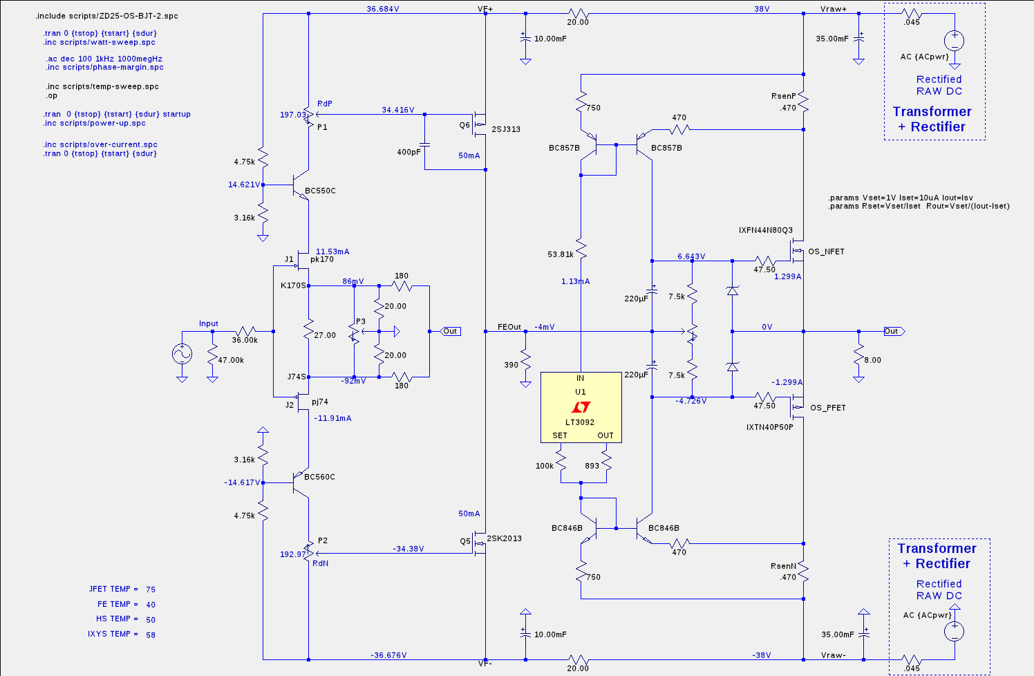

I managed to get the LT3092 current source to properly simulate in the circuit of post #1066, but the simulation runs very slowly, requiring about one hour for the temperature sweep.
ZM: There are two parallel servos here. I ran a 10 minute duration simulation at 25 watts and 20Hz and could not see any motor-boating. What do you say?

Instead of one hour simulation, you could make that ops and see for your self in real time ☺ Interesting work btw.

I have two competing designs to choose from. I suppose I could build both, requiring only a switch of the PCBs, since the power supply, heatsinks and enclosure would be the same.

looking good for me

You don't need pcb for prototype of this ops, it's not that complicated, but I guess you are just lazy as I am... ☺
Seriously I don't think simulation for temperature compensation is reliable at all.
with 0R47 in rails , you can go much simpler route , with great stability (Iq tempco etc)

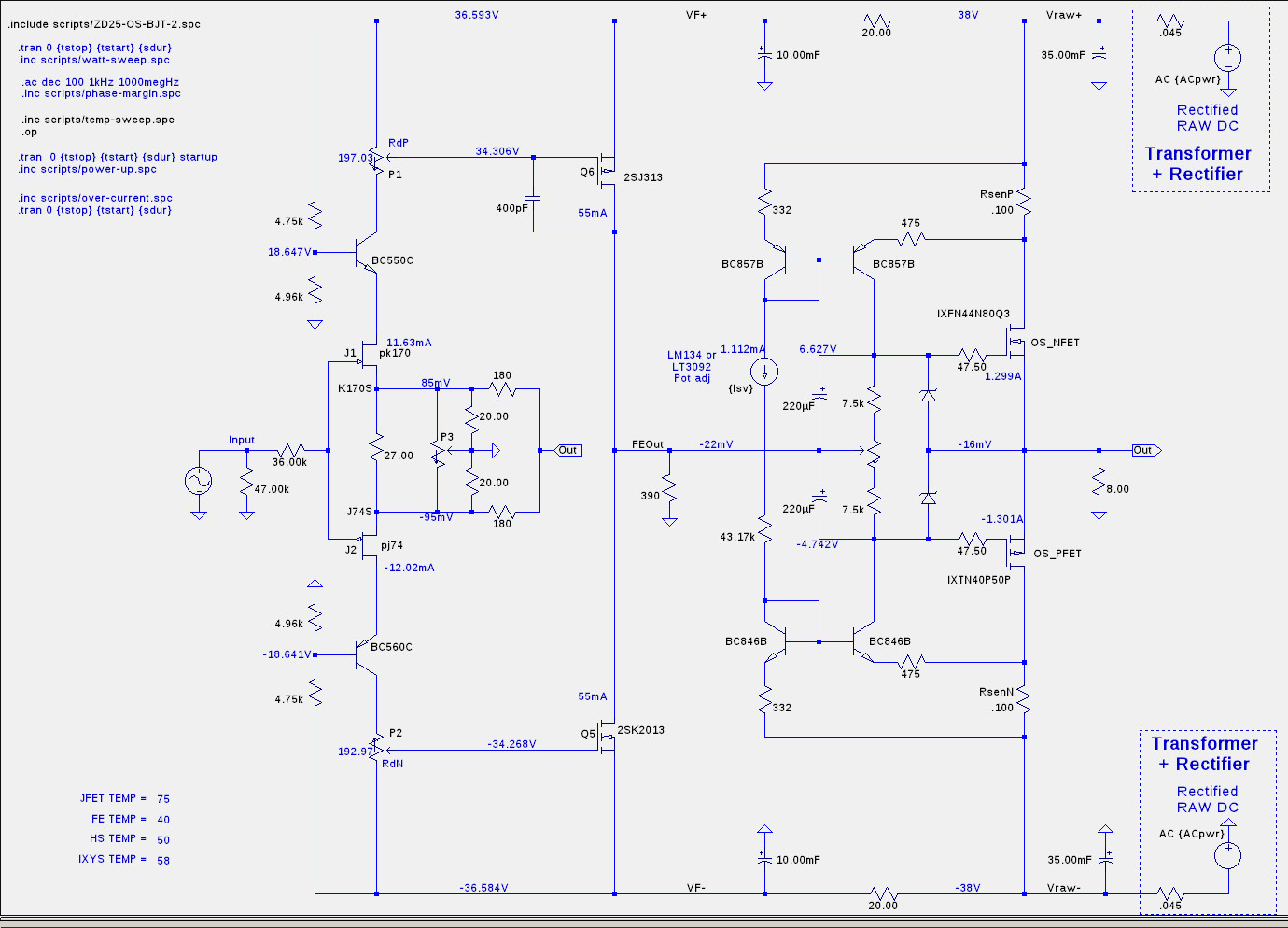

ZM: What THD do your simulations show at 20Hz and 25 Watts and 8R load ? My preferred design gives .022% THD, mostly odd harmonics due to clipping in the servo circuit, for this condition. A slightly more complicated design gives .0035% THD.
gimme your relevant sim cmd , to make tests the same

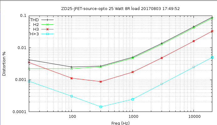

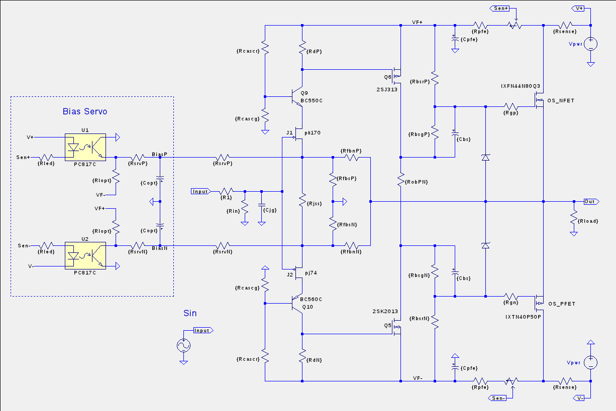

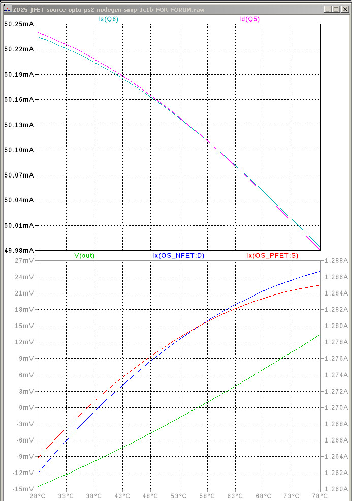

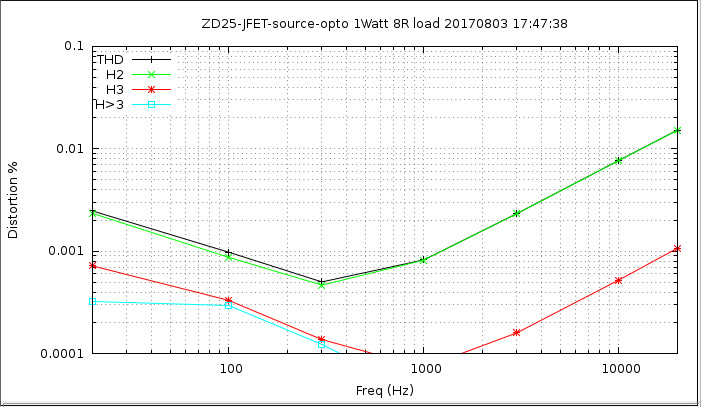

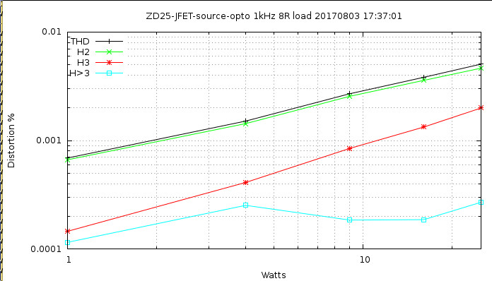

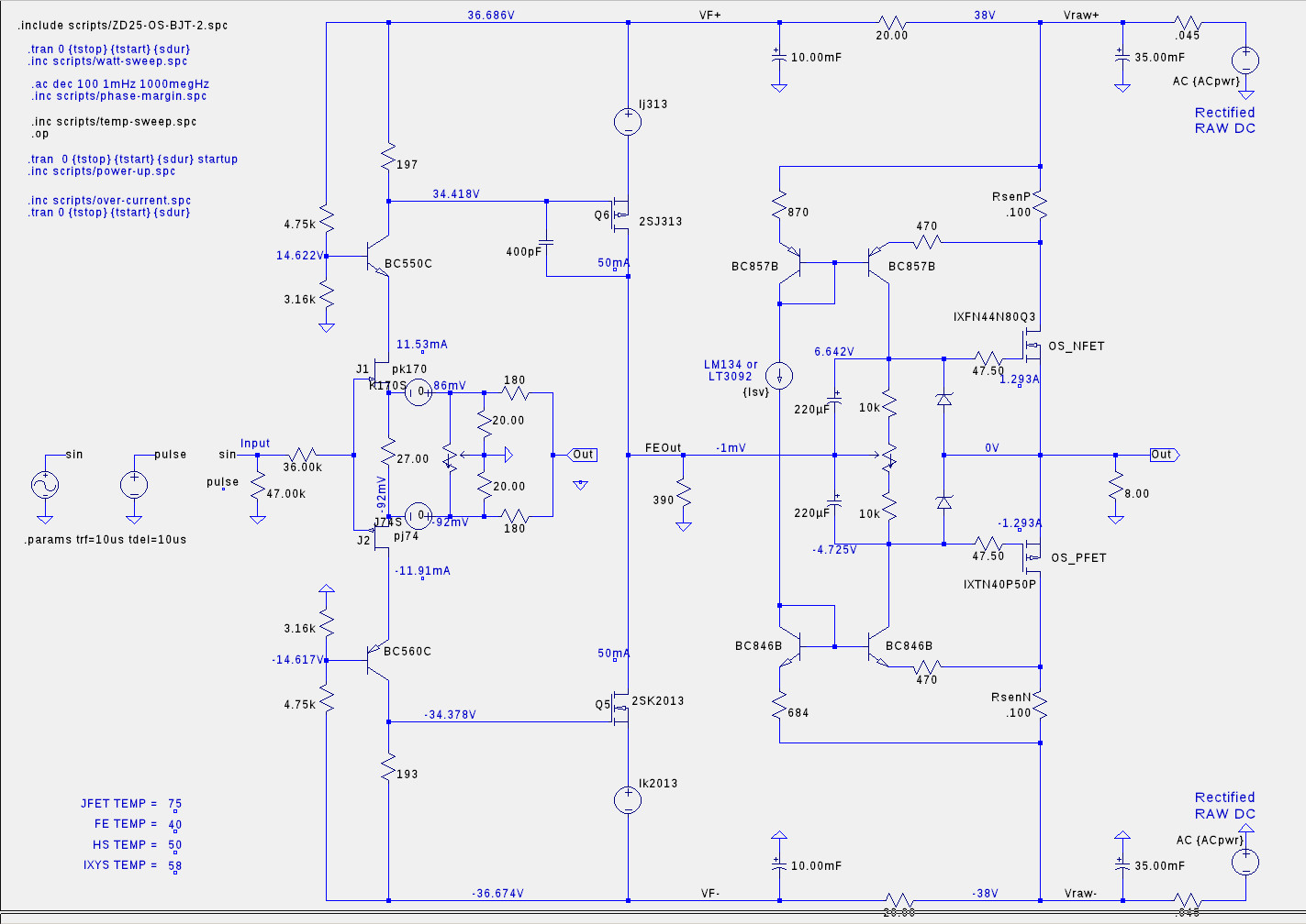

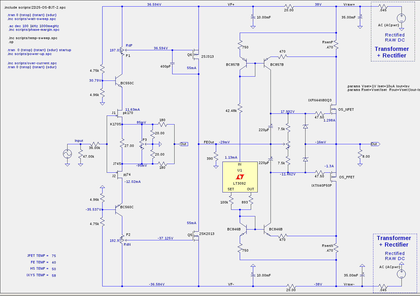

Here is a circuit with no degeneration that stabilizes both the front-end (FE) and output-stage (OS) bias and with appropriate resistor values appears to satisfy the XA25 specifications, except for the over-current shutdown. The schematic is shown without those values for now, but some performance plots are shown below.
ZD25-JFET-source-opto-ps2-nodegen-simp-1c1b-FOR-FORUM.asc.jpg142.5 KB · Views: 443
ZD25-JFET-source-opto-ps2-nodegen-simp-1c1b-FOR-FORUM.temp-sweep.jpg176.9 KB · Views: 338

ZD25-JFET-source-opto-ps2-nodegen-simp-1c1b-FOR-FORUM-1Watt-fsweep.jpg91 KB · Views: 149

Do you have a graph of frequency response and phase? Just wondering about stability given that you are applying all the feedback globally.
Unrelated point: I think there is degeneration here of the input JFETs due to the network between their sources. Doesn't Nelson tend to operate these at Idss these days? Even so, I can't see how all degeneration can be removed due to the need for the feedback resistor to ground.
Interesting bias circuit BTW. One issue I see is that this kind of approach will not lend itself well to doubling up (or more!) the output devices for extra power. Then again this may not be a goal for you.
