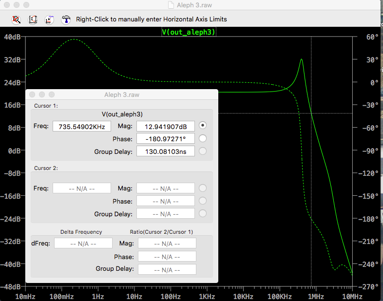

why is the phase value of the box so different from the value shown on the right side?
here is the situation with the Aleph3.....
Sorry Mister Pass all mistakes due to me and Spice......😀
If I take serious what the box says Aleph 3 has no gain margin with neg. dB values, only relative to the gain 20dB itself. Is this already enough?
When I take serious the information on the right bar it is -24dB.
Hu, Hu ...... I feel again at starting point.
The magnitude value is correct. The phase value corresponds to the position on the dashed curve (phase) at the frequency determined by the horizontal position of the cursor. In all cases the vertical position of the cursor is irrelevant.

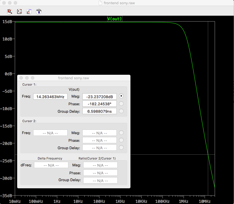

I have the impression we search a ghost...
The Sony II version 1 frontend alone fulfills the demands pico told perfect, combined with the Puck output stage all gain margin at -180° is gone.
Is it possible that the models we have for our Pucks do not have the lower capacities starting around 15V and so we get und must get always wrong results?
the phase bar on the right side we switch off...what does it show?
Sony II frontend and CFB and I connected the 750R instead to the OS output to the FE output.
I wanted to isolate the problem.
I think it is not in the frontend making bad values, but possibly our models do it in the OS stage.
