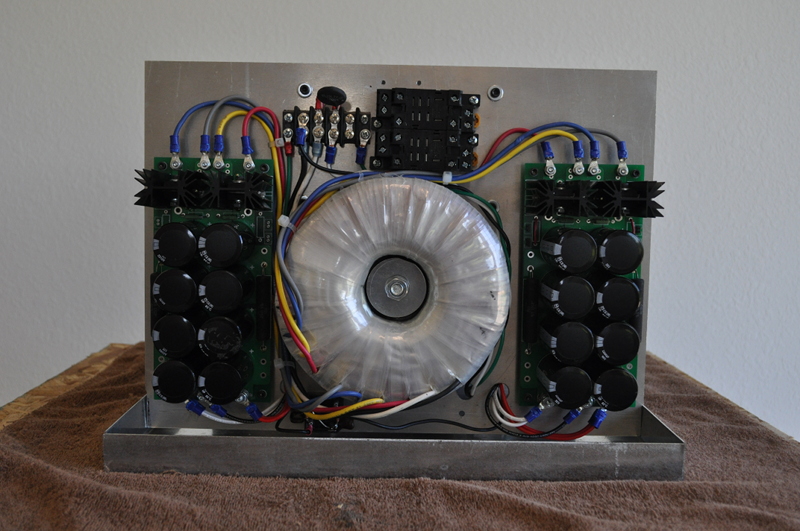

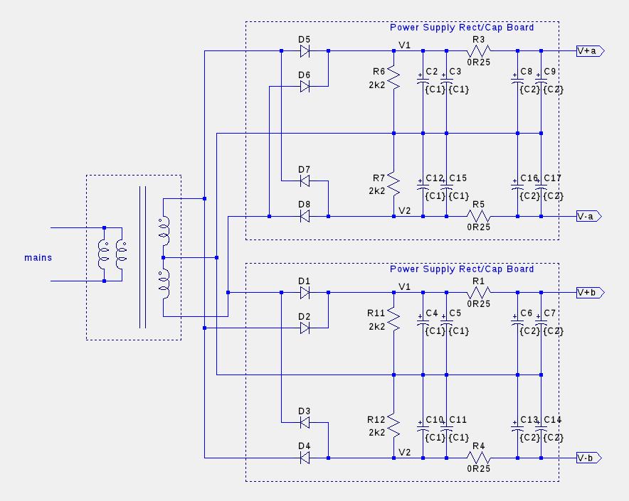

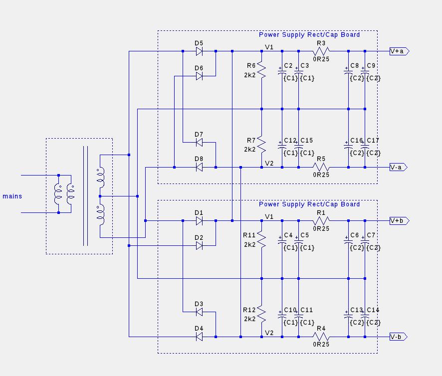

I have rectifier/cap boards as shown. I could cross connect the first stage capacitors as shown below. I do not have room for dual supplies. The other option is to use a 800W 4-secondary transformer. The 2nd image is power supply with 800W and 4 windings.
800W 20VAC 4-secondaries from Antek: AN-8420 - 800VA 20V Transformer - AnTek Products Corp

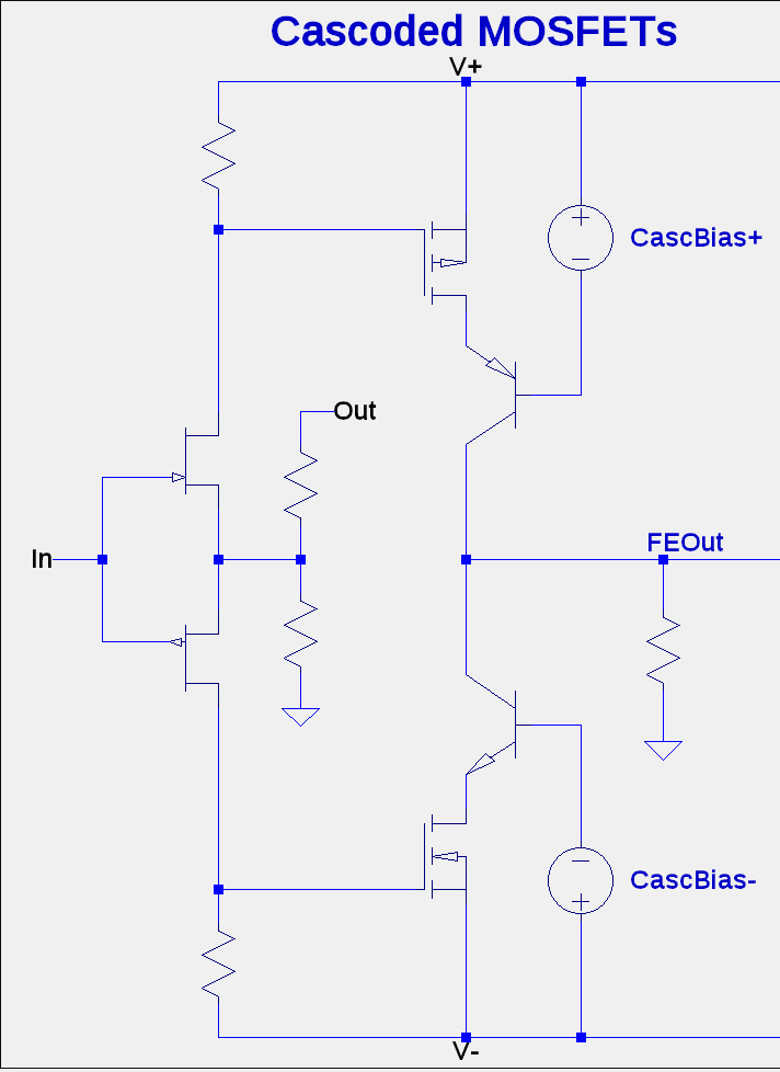

Cascoded MOSFET would imply the front end circuit topology shown below. Cascoding the MOSFETs would cut into the voltage headroom of FEOut which would be undesirable unless one was to increase the rail voltages.
My conclusion is that the XA25 User Manual statement was poorly worded and that the JFET drains are cascoded, not the MOSFETS.

"We still use the same “New Old Stock” of small power JFETs and cascoded MOSFET, in the classic “CFA” voltage gain circuit."
The term "cascoded MOSFET" is troubling me. All of Nelson's cascoded front-end circuits of which I am aware put the cascodes on the drains of the JFETs.
Any other opinions?
