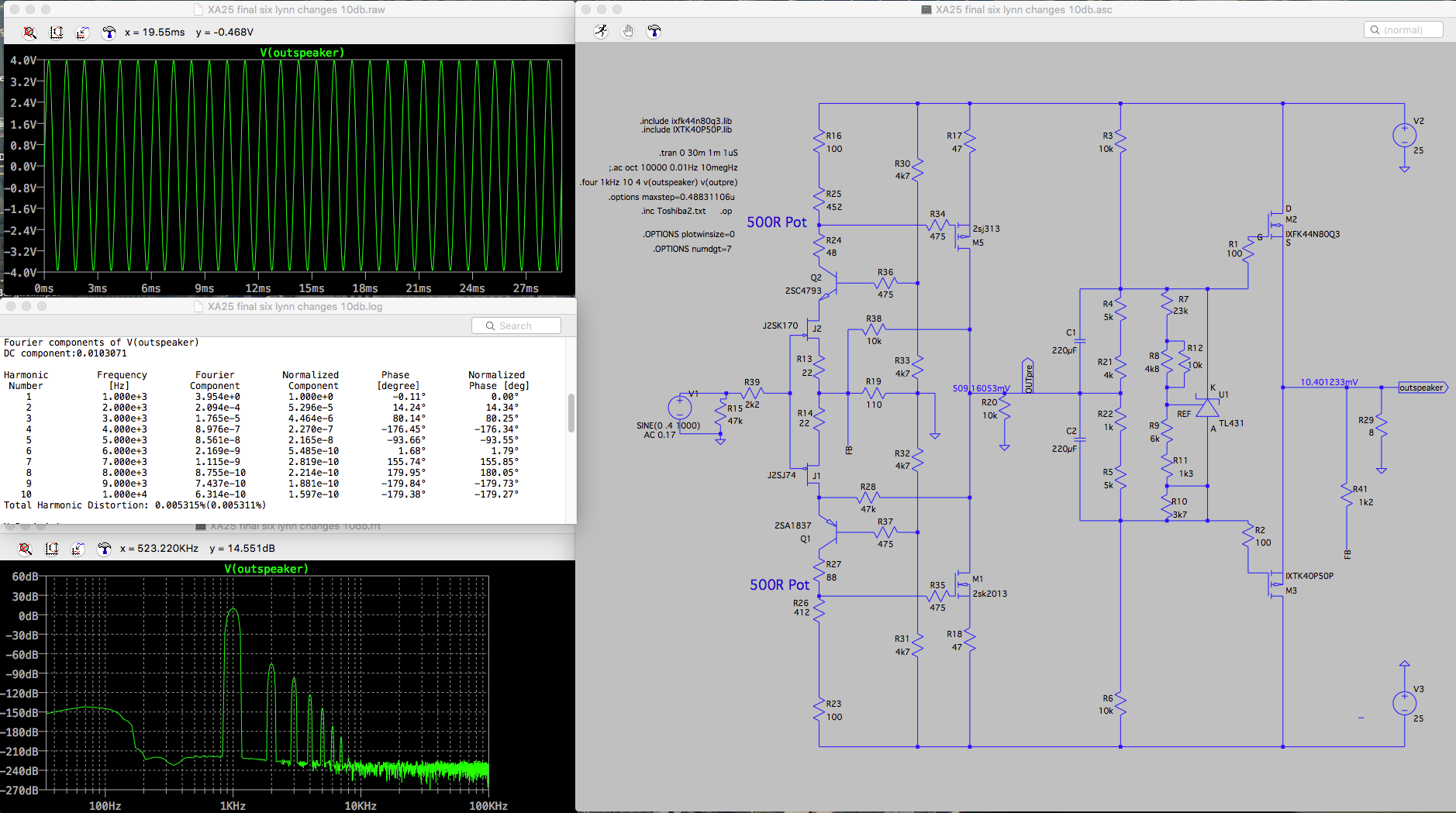

Here is a Gm vs. I(d) plot for the 2sk2013. It tracks excellently with the datasheet.
BUT, the bias situation is far from perfect.
At 50mA, Gm=.3 S. The Vgs vs. temperature plot in post #373 has a slope of -1.8mV/C. If the bias current is adjusted for 50mA at an operating temperature 20C above ambient, the bias current will be 1.8mV/C * 20C * .3 S = 10. 8mA lower at the ambient startuptemperature.

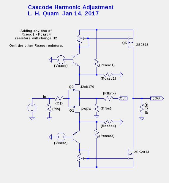

With the cascoded jfets is possible to adjust the H2 magnitude and polarity without using cascode feedback or jfet source resistors. Connecting a resistor from one of the cascode BJT emitters to ground (or rail) will inject a (almost) constant current into emitter, requiring a change to the drian load resistance in order to zero the FE output offset. Changing the drain load resistance also changes the open-loop gain of the jfet stage, thereby changing the H2 balance. Try it.

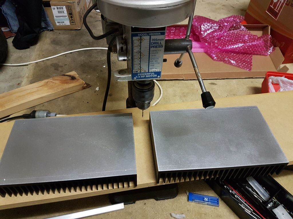

I ordered bigger heatsink for the SK/J not to come in trouble with the possible thermal runaway. In some days I can try to omit the source resistors.

No need to worry. You probably want both negative cascode feedback and some difference in the amount applied to the positive and negative sides.
I was only making a comment about another aspect of cascoded front ends, independent of the use of cascode negative feedback.
Yes I understood of course, it was more a joke ....:--))
Isn't it possible to do the same with an intended "missetting" of the 500 pots at the J-Fets and then adjusting the offset of the front end with the 5k pot in the outputstage?
PSRR becomes an issue, unless the ends of the pot are connected stable voltage sources, such as the cascode bias generators driving the bases of the cascode BJTs. Otherwise any hum or noise on the power rails would couple through the feedback network.
The circuit I presented in post #383 also has that problem if the resistors to the rails are used, but is OK with the resistors to ground.
