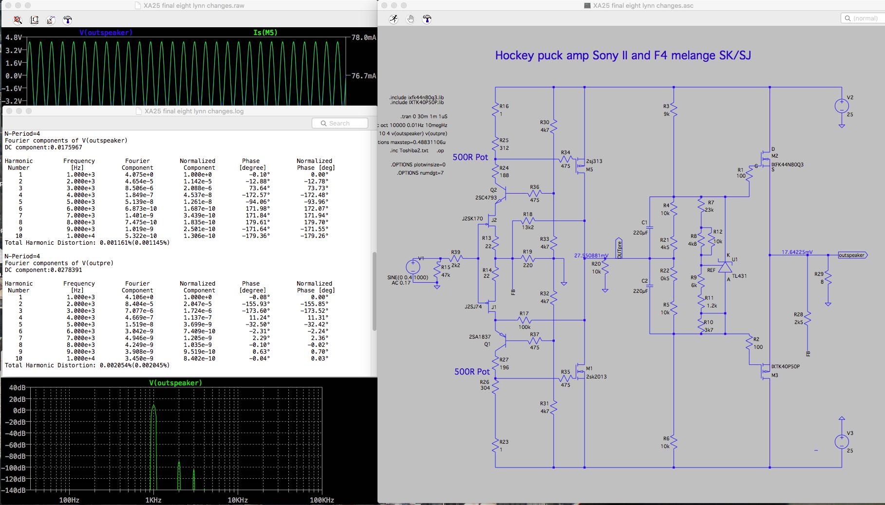

Todays work!
I have hope now that the low distortion can be done.
At least in Spice and hopefully in real!
Normal lokal feedback and high current around 70mA for the Toshibas SK/SJ and no degeneration there. Gain structure, OLG of about 44dB, with local feedback around 34dB and with overall feedback the wanted 20dB.
Would be nice if someone could verify in Spice too.
Values look now more like in the manual.
How can the distortion of the front end higher than the distortion of the whole amp?
And we must have a better possibility to get the output stage alone to zero, look that i had to change one 10k to 9k to get more similarity of the offsets.

Those OLG and feedback levels are similar to ones I have found in my simulations, but a bit more local feedback is needed to lower the impedance of the FE output stage and improve the distortion at higher frequencies.
The higher distortion you are seeing in the FE is the approximately the inverse of the distortion of the output stage. If there was sufficient feedback to reduce the output distortion to zero, then the FE output distortion would be exactly the inverse of the OS stage distortion.

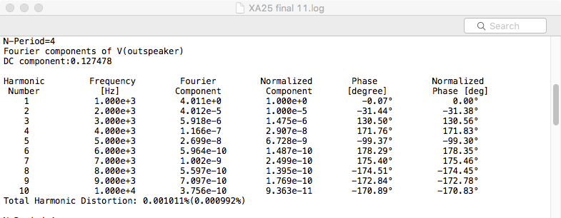

Isn´t this Spicy enough?
8mA/70mA/1.5A no degeneration
20dB gain
distortion "too" low
sound ????

Funny is that I get in Spice with two 15k CFB resistors, that do about the same local feedback as the single 5k6 resistor, more distortion.... what´s the matter?
And you get less....
o.k. with slightly different CFB resistors 11k and 13k I got again the same distortion numbers.
The higher damping of the CFB cannot be seen in the distortion value?

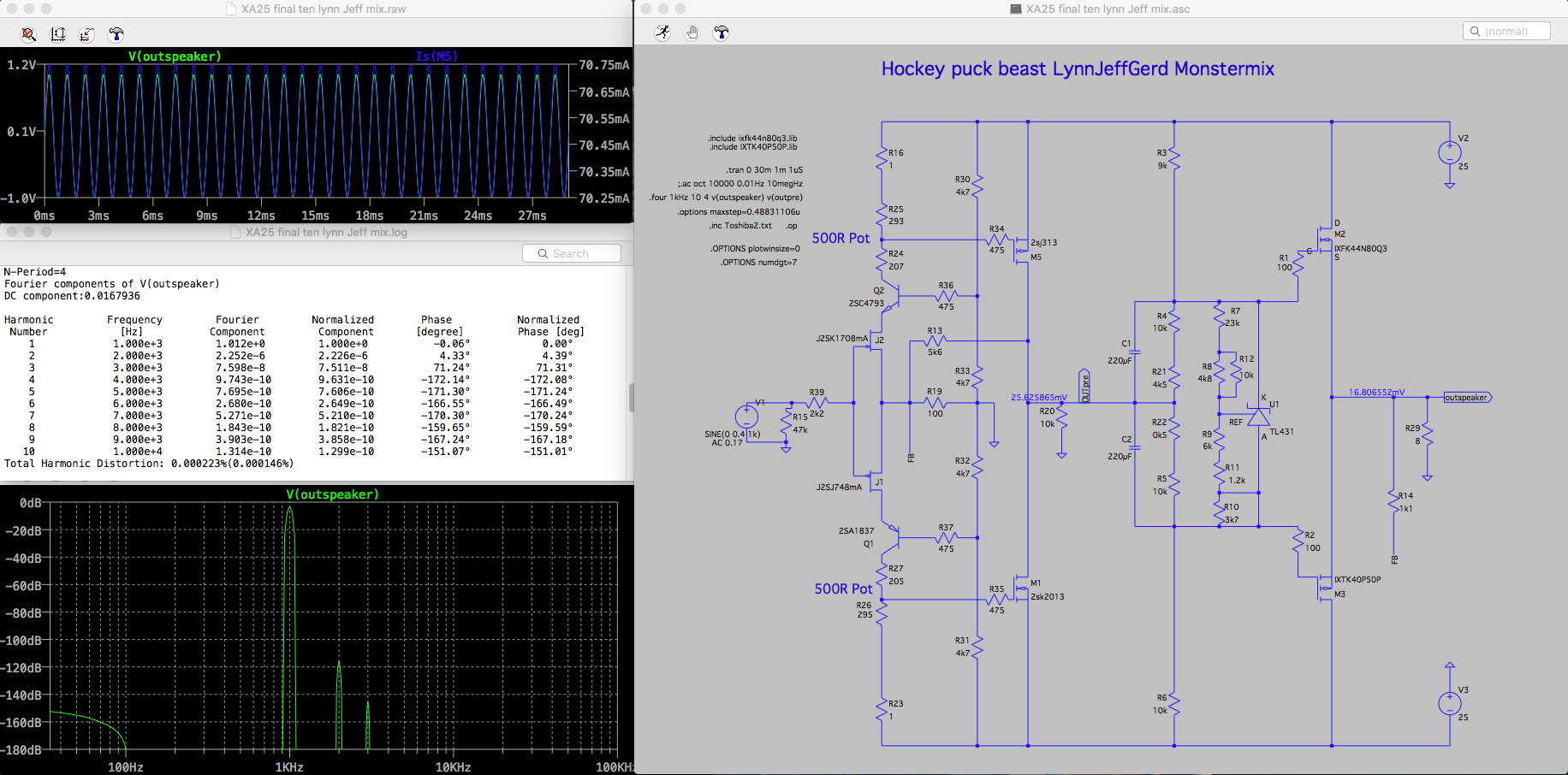

Your real name is in the circuits name I harmonized it to "LynnJeffGerd"
"when shall we three meet again" in a thread? It is the most funny and productive collaboration I ever had at Diyaudio.

I have settled on 120mA for k2013/j313 for the time being. I might push it higher later.
