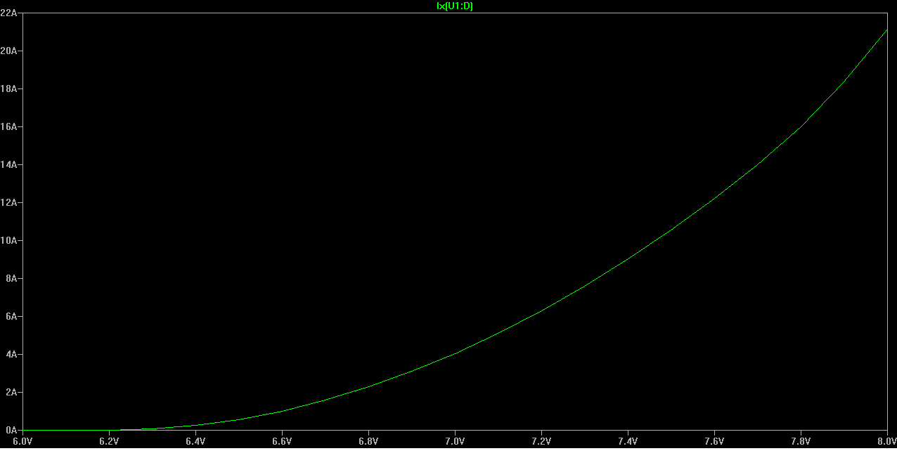

The IXFN44N80Q3 pspice file unzipped to a IXFN44N100Q3.lib file. I tried it in ltspice and it gave an error but generated a graph.
Great work Rob.
I still need to check curves for accuracy, but before that, I'm still getting weird results with the IXYS 40P50P model.
No spice errors, just spitting out a weird curve, more like a step. Hahaha
Could you describe some of the things you are doing to make it operate.
Yeah curve is wrong.
It's measuring around 11.7S instead of around 6.5S at our operating point.
The model needs to be modified.
I already have models that match our devices but they are based on simple model parameters but the important curves do match the part.
Keantoken can do more accurate models than me, but it usually doesn't change the results significantly.

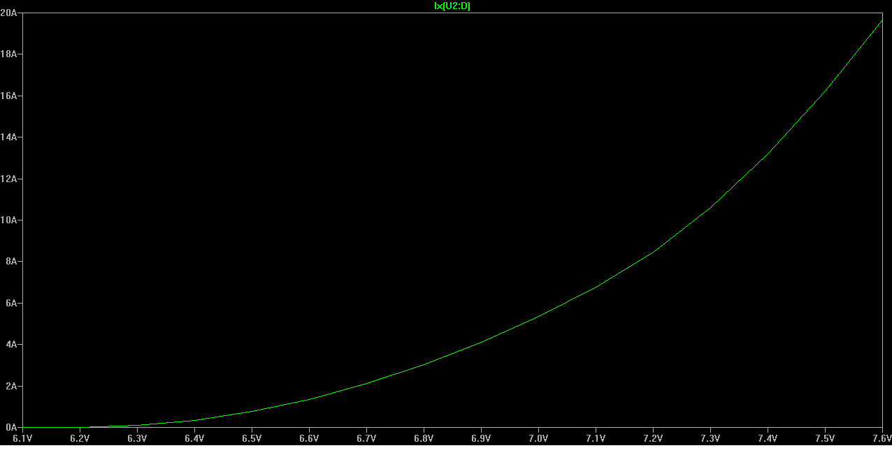

The error that I got for IXFN44N100Q3 was not from the model it was from my ltspice circuit. the model works fine and now so does the circuit. Ixys has the wrong pspice model for the IXFN44N80Q3 but the data sheet for part number IXFK44N80Q3 looks the same as the IXFN44N80Q3 and here is the graph for it.

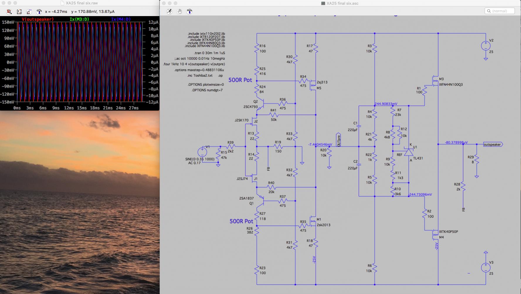

I am adding one more feature to this circuit.
1) Add toggle switch across R1 (not seen on circuit)
When R1 is shorted out, it will turn off output stage (stand-by/low power mode) but not the front end circuit.
I could have it so output stage turns completely off or add resistor in series with the switch so that output stage is drawing say 100mA. I'll decide later.
