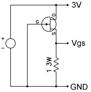

Does seem unusually high. Double-check the pinout and all your connections?
pretty sure that the pinout is correct
Do you know they're genuine? (My possible fakes measured differently too, but they were on the low side; 0.8V - 0.9V IIRC.)
I bought them from the member of this forum, not very sure that they are genuie or not
