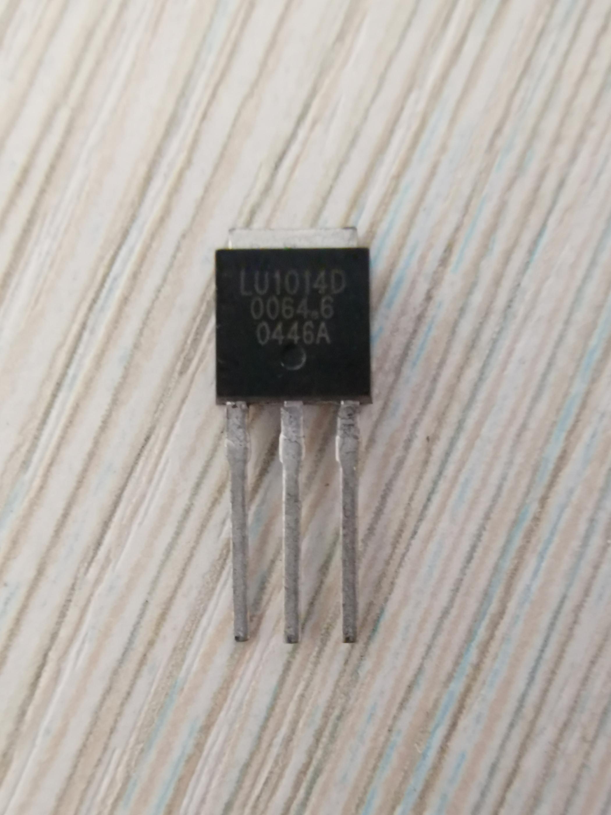

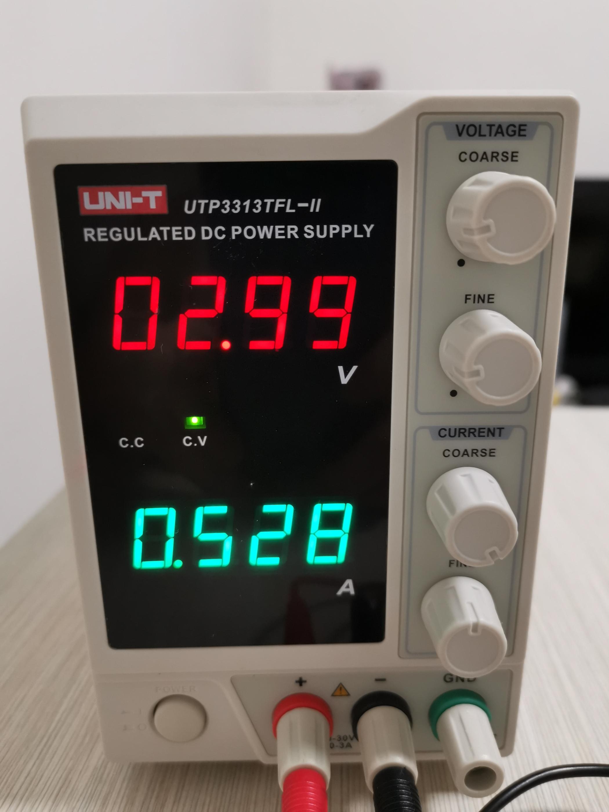

I can adjust Vd such that Vgs=1V. But I am sure that Vd will be lower than 3V. I forgot the value, maybe 2.x. I don't remember
Today I bought two LUs from Jim's Audio. I redo the test and found that the Vgs only got 5xx mV, so pretty sure that they are counterfeits.
Everyone, please tell me where can I get the genuine LU1014D? I have been spending few months on building the F3 and now I cannot continue my work due to missing of the most important parts. I am very frustrated, can anyone help?

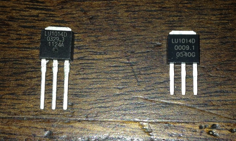

The right one is a genuine part, the ones of the left are what arrived. The legs are really flimsy too - snapped off while bending them to measure.
They seem to measure ok, but don't trust them

I bought some of these. The items don't match the image.
Sigh.
Yeah, I wouldn't trust them either.
