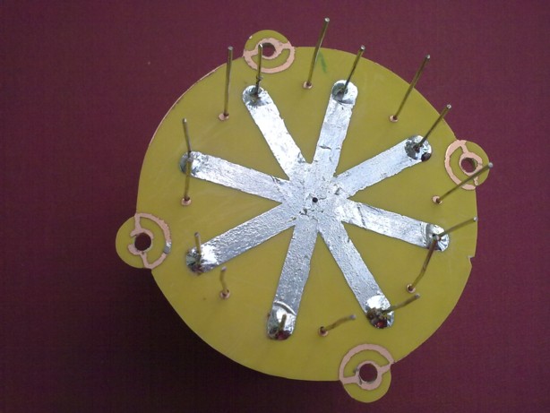

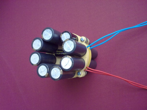

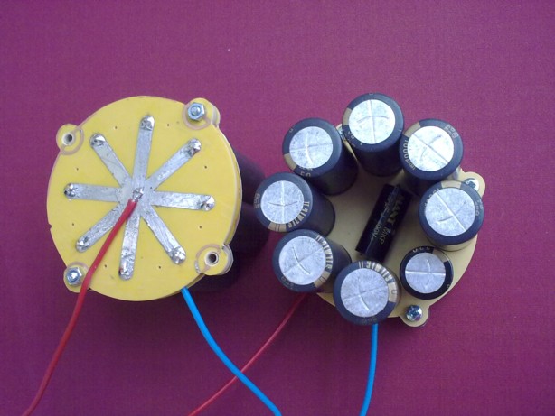

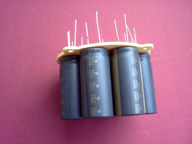

15x 1000uF Elna capacitor
Finally after several months I've rebuilt my Zen v9 into F3 amp. Following the Nelson advice I put (15x 1000uF +220uF) Elna Simic + 1uF propylene capacitor together at the ouput. Connected them into two layer star like pattern (see my previous posts). My Zen9 had 10000uF „Hi sound” Nichicon+10uF propylene. This time I was very careful in choosing transistors and resistors for both chanels more than previously also. Particulary in case of source resististors of JFET Q1. The rest electro caps are Nichicon Muse 220uF, which following suggestions of Jameshillj I paralled with 1uF foils caps. I was not so sure if such changes can altogehter bring significant results at the start, but reality proved it to be right. Previously Zen9 sounded very nice with a good soundstage but was a tiny bit „muddy”. The new F3 is sweet as previously but very detailed at the same time. Must admit the change is great, realy great. I didn't expect that. Additional „modyfication” in F3 cirquit are as follow: supply voltage 50V, 23V at the Q2 drain, change R8 from 2R to 1 R to rise bias to 2 amps ( as it was in Zen9).

After listenig to the amp I can say that paralelling C3 220uF with 1uF foil cap is not a good idea. Sound is pristine but there is probably sligth high frequency boost from Aleph current source. As a result some instruments apparenlyt play a bit higher as well as vocals. There is funny phenomena caused by that. They apparently "looks" smaller on a sound stage. "Honey, I shrunk the kids! ". So I'm going to leave foil cap out in this case. Open question is if the bank of 15x1000uF+220uF +1uF works 100% correctly so as to frequency responce. Does it ?

Yes it was. I removed 1uF MKP capacitor from (15x1000uF+220uF +1uF) group and now everythig is back in normal. So right now there is stack of (15x1000uF+220uF) Elna Silmic caps working and sounds fabulous .
