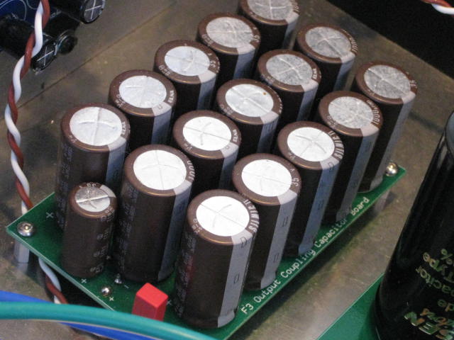

15x1000uF Elna silmic capacitors
Originally posted by Nelson Pass, January 23, 2009
... Probably the most contentious part is the big electrolytic at the output. If you could parallel up a pile of Elna silks or polypropylenes to form the output capacitance I think that would be the biggest improvement you could make parts-wise.
Originally posted by Nelson Pass, January 24, 2009
Trust me - people obviously are missing a big bet on the Elnas.
Finished my F3 in the Fall of 2009. Obviously, the Master was trying to tell us something and he was right. Glad I took his advice. Have 6 more boards. If anyone is interested contact me.

why not go with electronic concepts unlytic 1000uf polypropylene? they are massive in size, can go right up to 2200uf. can get them occasionally on surplus auctions, even then they wont be cheap, but probably not as much as you would think and 16x 1000uf silmic isnt cheap either

qusp said: why not go with electronic concepts unlytic 1000uf polypropylene?
The silmics were on sale and I got a good buy.
YES, I am happy that the Master confirmes this cluster-of-small-electrolytics approach. Till 2007 I was loosing all comparisons of my SE SS amps again the Linn topology amps, and only after I used a cluster of low-impedance smaller electrolytics, I have demonstrated definite advatages of SE topology to my friends. Even Jamicon WG and WL series, that are definitely not the best, solve the task. But, anyway, 50...100uF polypropylene shunt cap is obligatory. Since then, I use this approach in all new amps.

VladimirK, thank you for pointing me to raise a question that I haven't been able to answer since I'm still a novice who is still learning. Could you explain what happens when smaller electrolytics are used to form the capacitance in this particular place in the circuit, and why this approach results as Nelson Pass has said in "the biggest improvement you could make parts-wise." What is it that smaller electrolytics clustered in this way contribute to improve the sound that larger caps do not and how does this happen? I am very pleased with the sound of my F3. But then, I haven't heard one that uses "the big electrolytic at the output".
