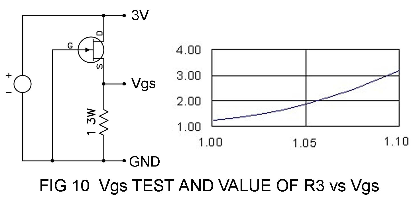

Did you adjust the value of the Source resistance against the Vgs figure of
the Jfet? I recall that I published a curve and some comments about this
on page 8 of the ZV9 article.
Also, you are looking for a Vds on the Jfet at around 2.5V.

Mr Pass,
I sent you an email regarding this test last week.
When applying the voltage to the test circuit, should I wait until the voltage settles (it just keeps climbing) or take the first reading on applying the voltage? The jfet heats up very fast, so it's not at room temp for very long.
Thanks,
Vince
Thanks,
Vince
It has been said somewhere already . Measure Vgs while Jfet is still at room temperature = no more than 2 sec in my experience. Or first reading after a second - short stable period before it climbs up - better.
That's a fine line, but ok.
I couldn't test the jfet prior installing it to the amp (don't have a suitable power supply) but I adjusted the resistor value R5 to arrive at about 3.5V on the drain of the jfet and a about 2.5V drain to source (when the amp is warmed up). Ended up with values ~1.7ohms/left and ~1.9ohms/right. Output dc is 21V, supply rail is 46V and about 41V at the drain of Q3. Voltage over R3-R5 is about 1V and 0.62V over R6-R8.
I don't really know what happened but after trying out different value resistors and finally reverting back to the values mentioned in the previous paragraph the amp started to sound pretty damn good last night. Maybe there was a bad connection somewhere? My super tweeter might still be playing a bit rough sometimes but this might change once I connect it through the separate coupling cap. I already have it installed with a second set of speaker terminals but don't have another pair of cables.
