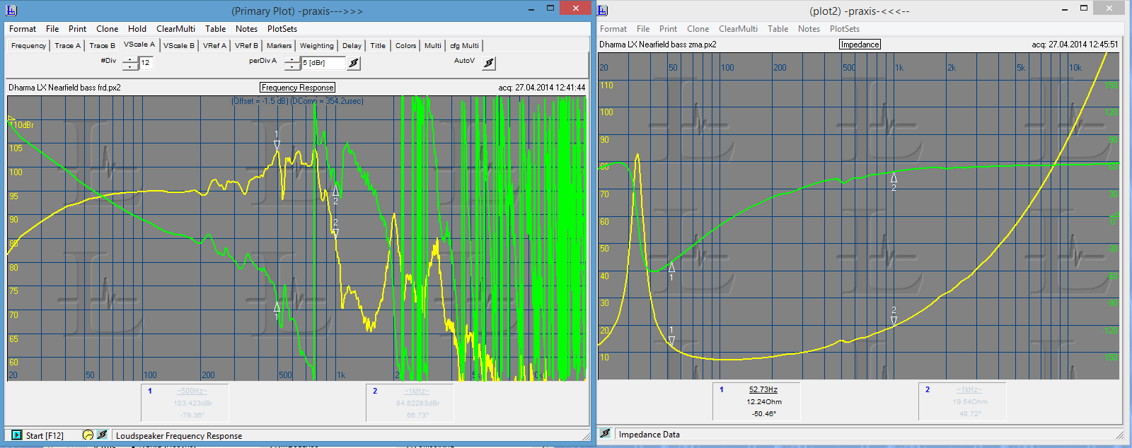

Here is the unequalized nearfield bass response of the sub section and the impedance curve. There is a resonance at 500Hz but that is ouf range. Otherwise it looks good.
From what I recall, performing a nearfield measurement on a dipole merely shows you what the drivers natural roll off is without the dipole cancellation added in.
In other words this is how you ascertain what EQ to provide as a way of modifying the system Q towards something more desirable. For example if you used bass drivers with a Q of 0.3, you would probably want to LT it to get you up to a Q of 0.5-0.7.
Once you've done this you then need to either measure, or model, the effects of dipole cancellation and EQ that on top of the previous system Q modification.
You may already know this, but from your post above it seemed like you were expecting that one bit of EQ to sort out the bass response in room. It wont.

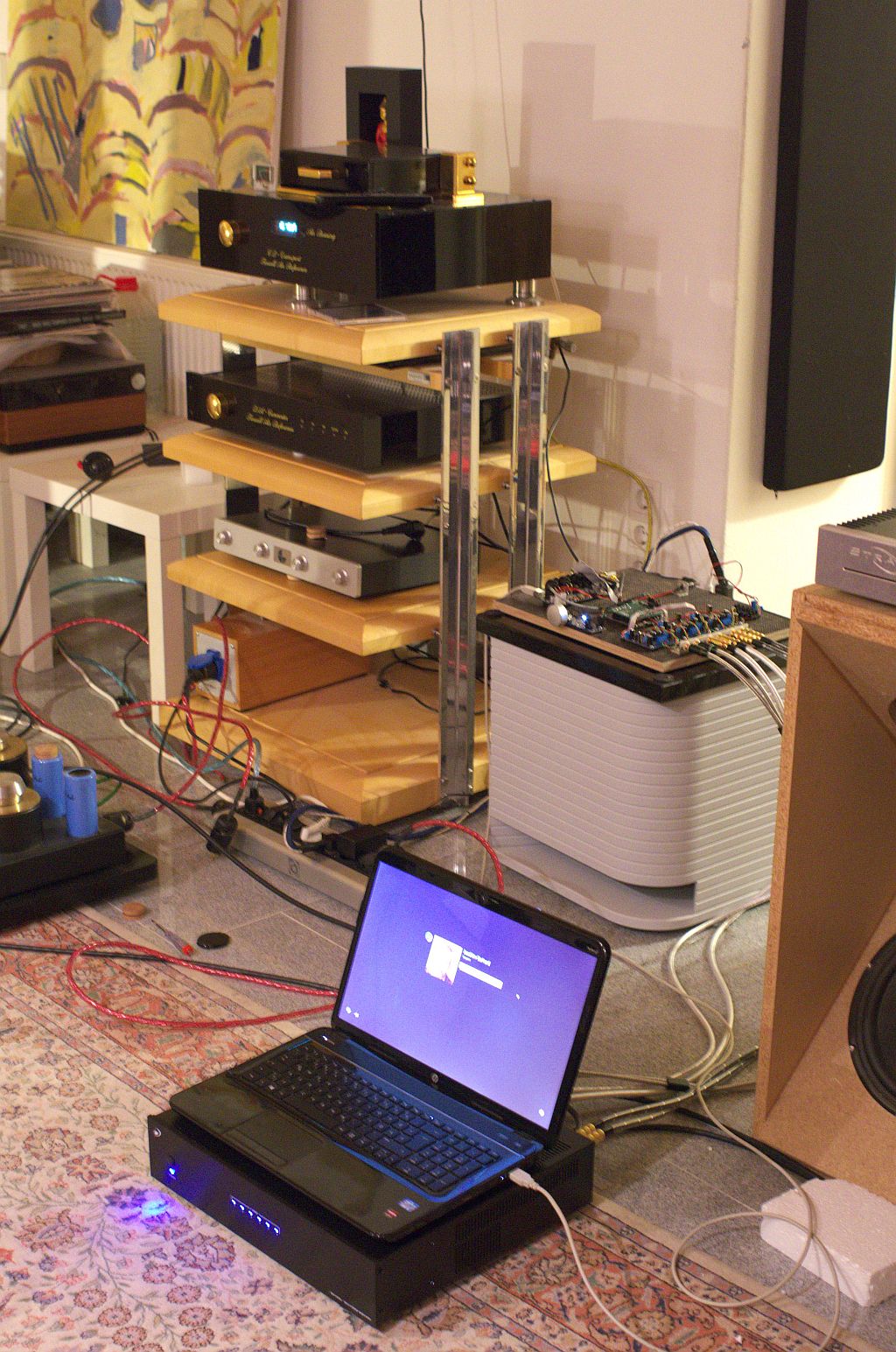

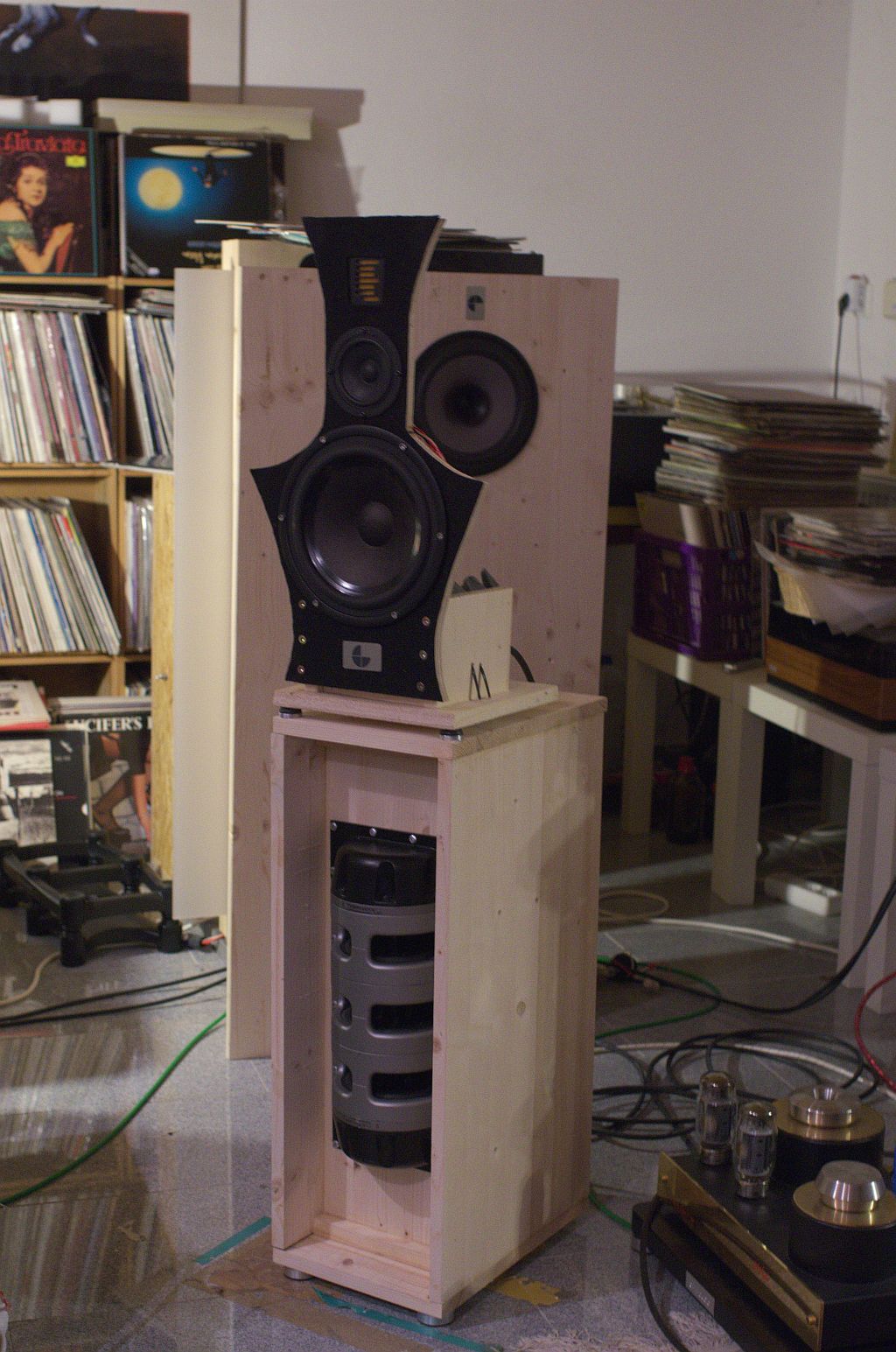

Please find attached some pictures of our first session. The dsp system + amp + speaker is now running and Joachim can do the fine tuning. Maybe he needs to do the whole procedure agan since on monday it was a bit quick'n'dirty :eek:
We are using IIR filters in a first step to EQ and lowpass/highpass the single speakers. FIR filters calculated with RePhase perform the phase corrections to achieve linear phase behaviour. This saves taps which are somewhat limited on the miniSHARC.
kind regards, Daniel
