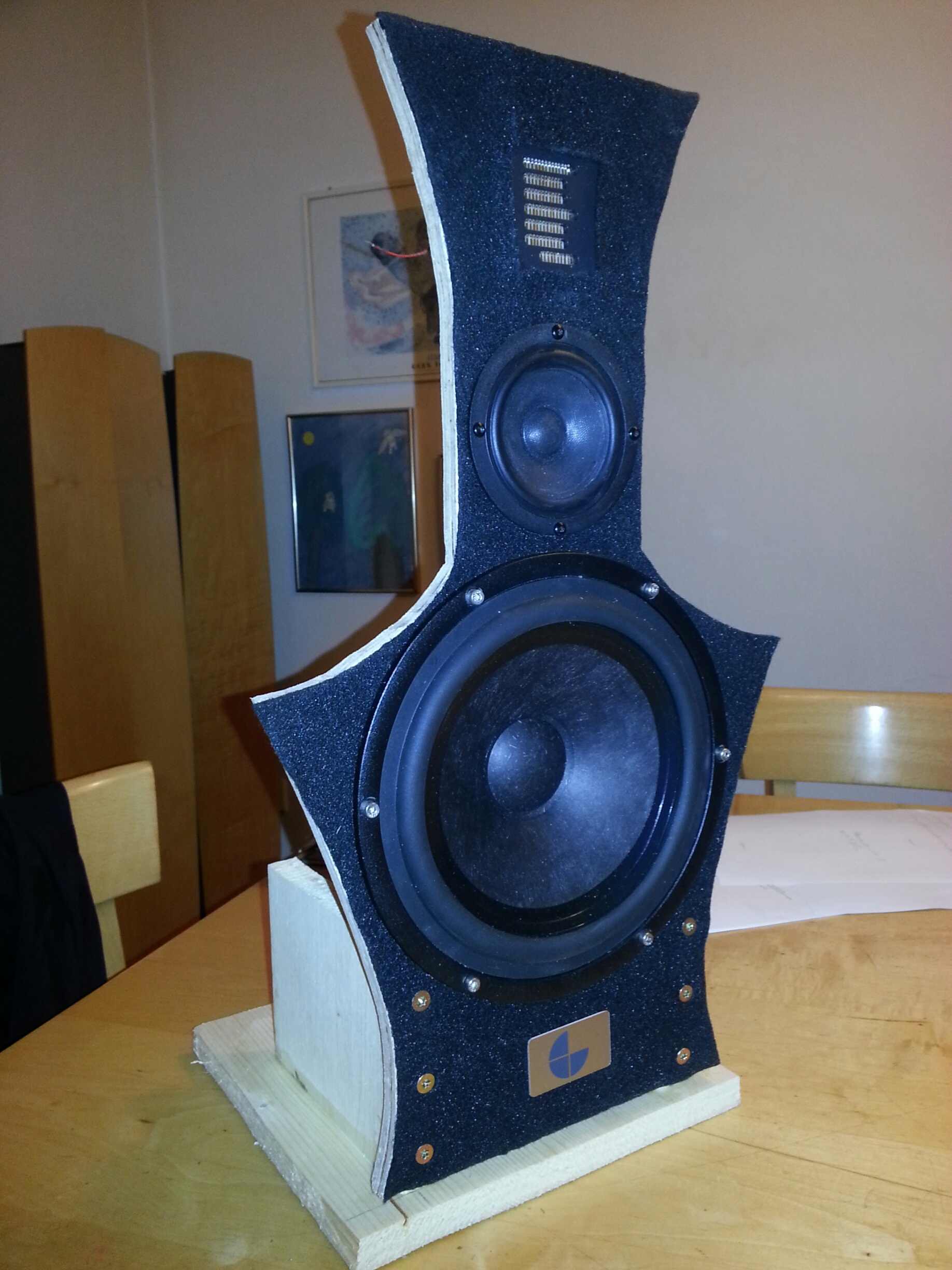

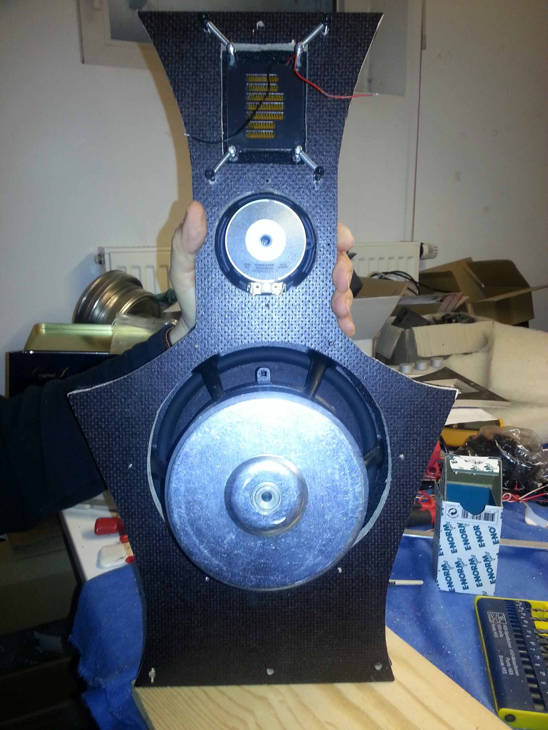

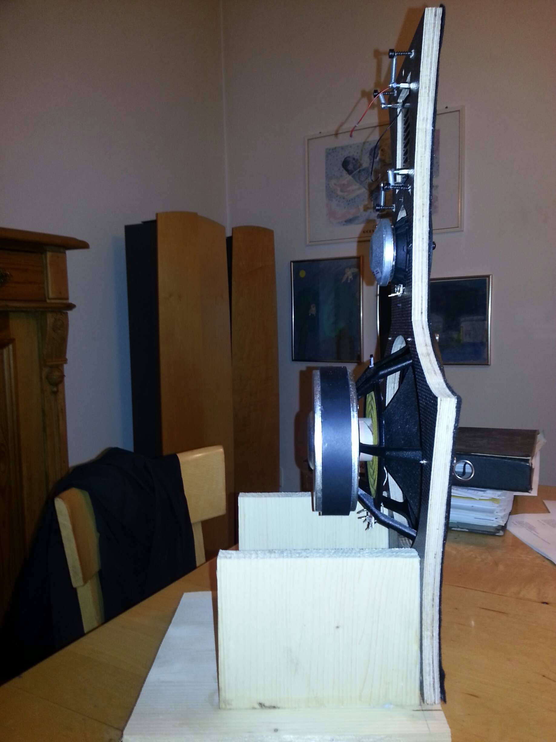

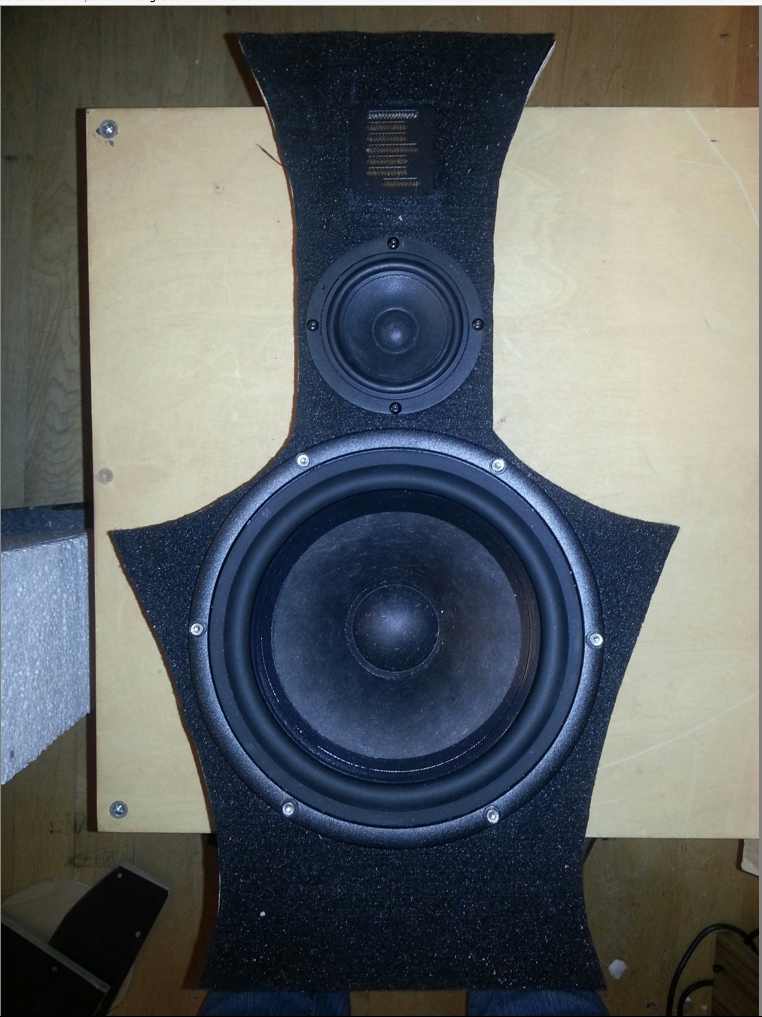

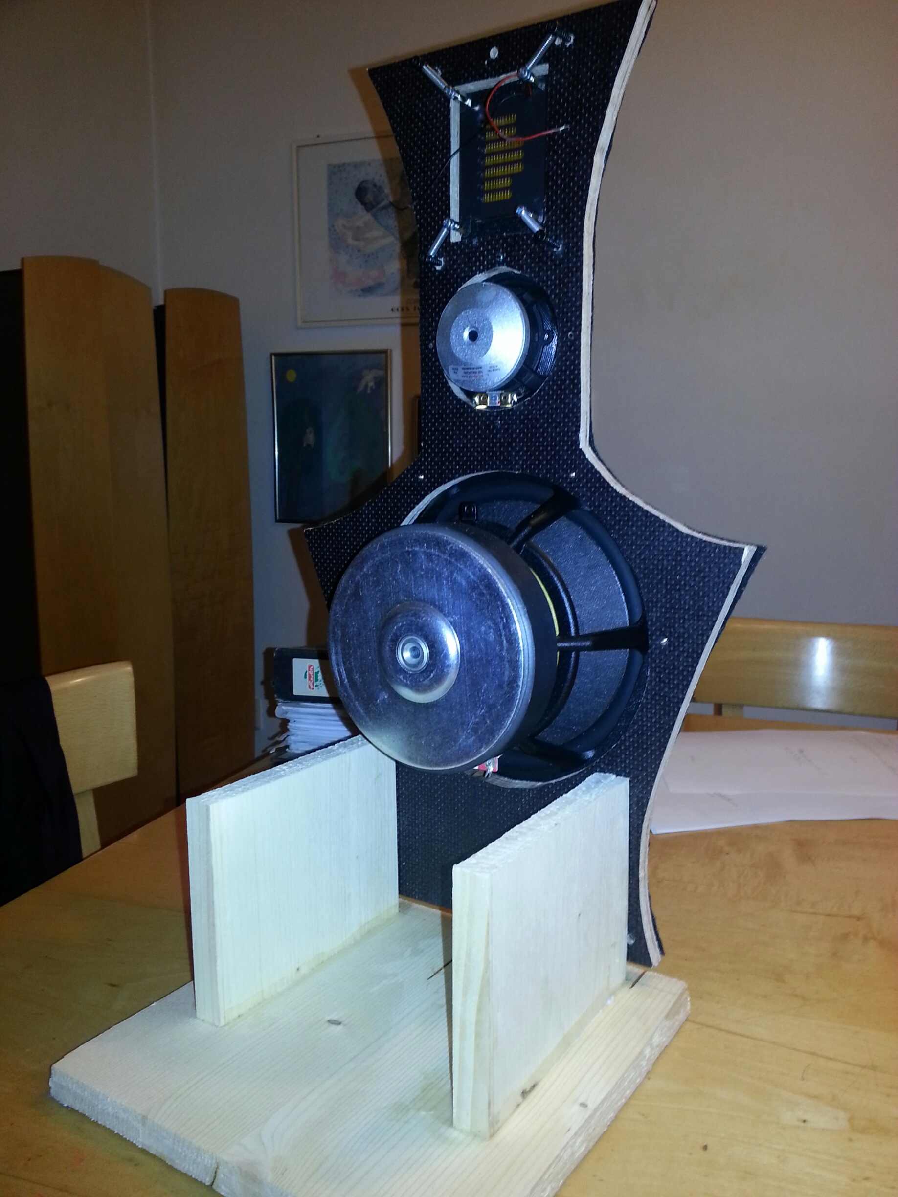

I admit defeat . I am a new member since yesterday , but have been actively lurking in here and conversing with Rudolf over email . Just read my introduction post . I really was under the impression that I would be the first to build a dipole using the Mundorf AMT 25d1.1 but alas , you beat me to it .
Anyway , my project is not finished yet but I already have some pics of the H-frame , minimal baffle for mids and tweets with drivers mounted (midranges are Wavecor WAF138 )
The baffle form is as narrow as possible for each driver to optimise sound dispersion as high in the frequency range as needed for the Xover point . Xovers will be around 250 and 1750 Hz
