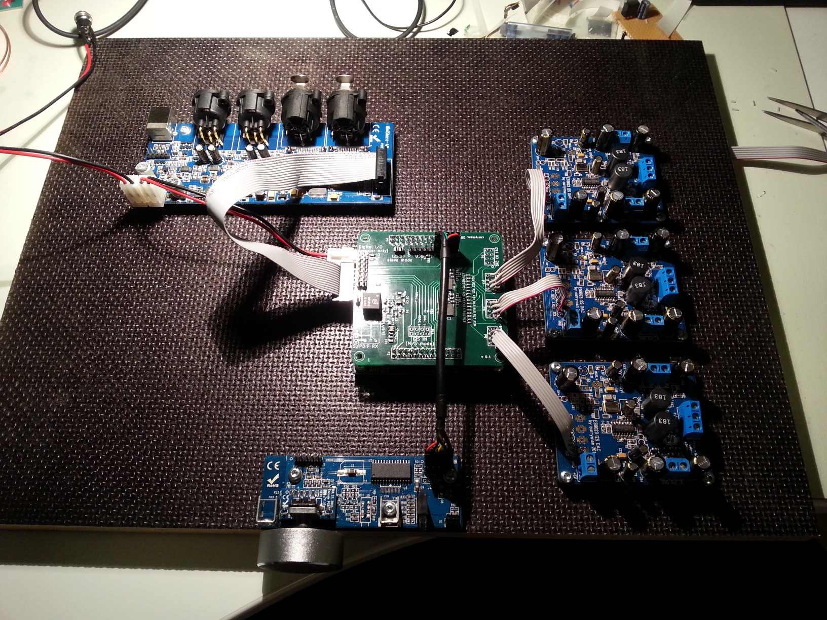

Very nice set-up for the DSP-DA... I'm using the miniSharc with two Curryman DAC's, its very good system and easy to use. Also, nice to see Daniel's add-on board in use, DAC connection looks a lot tidier.

That DSP-DA combo is exactly what I am planning to do. Can you tell us which modules you use in that DSP-DA combo?

Hehe, maybe I should jump in here:
it's a miniSHARC DSP from miniDSP plus 3 I2S input curryman DACs. In this case the so called AN_FP provides a stereo analog input (plus an additional stere output, so it's actually a 8ch DSP-DA combo 😀) and the Vol_FP allows for (digital) volume control and preset selection (4 presets).
Since the miniSHARC board has a suboptimal interface for multiple I2S DACs (bit clock and word clock lines shared for several data lines, which is quite usual btw.) I made an adapter board providing four buffered I2S outputs. This adapter board furthermore features buffered and transformer isolated SPDIF input and output, since the miniSHARC board only has TTL level in/out. The adapter board is in beta test phase at the moment, Joachim getting the first prototype 😉

That's exactly what I was looking for (properly buffered I2S)!
Are you interested in another beta tester?
