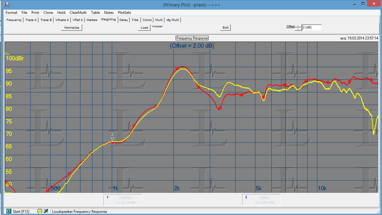

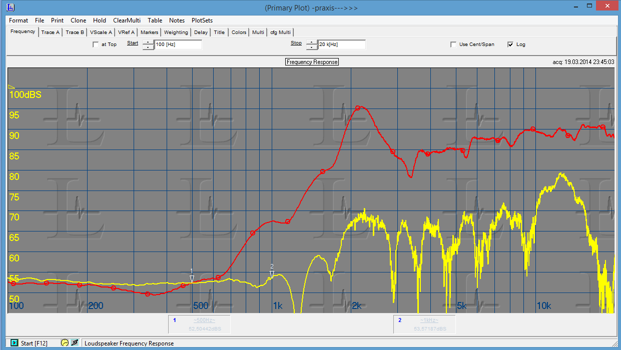

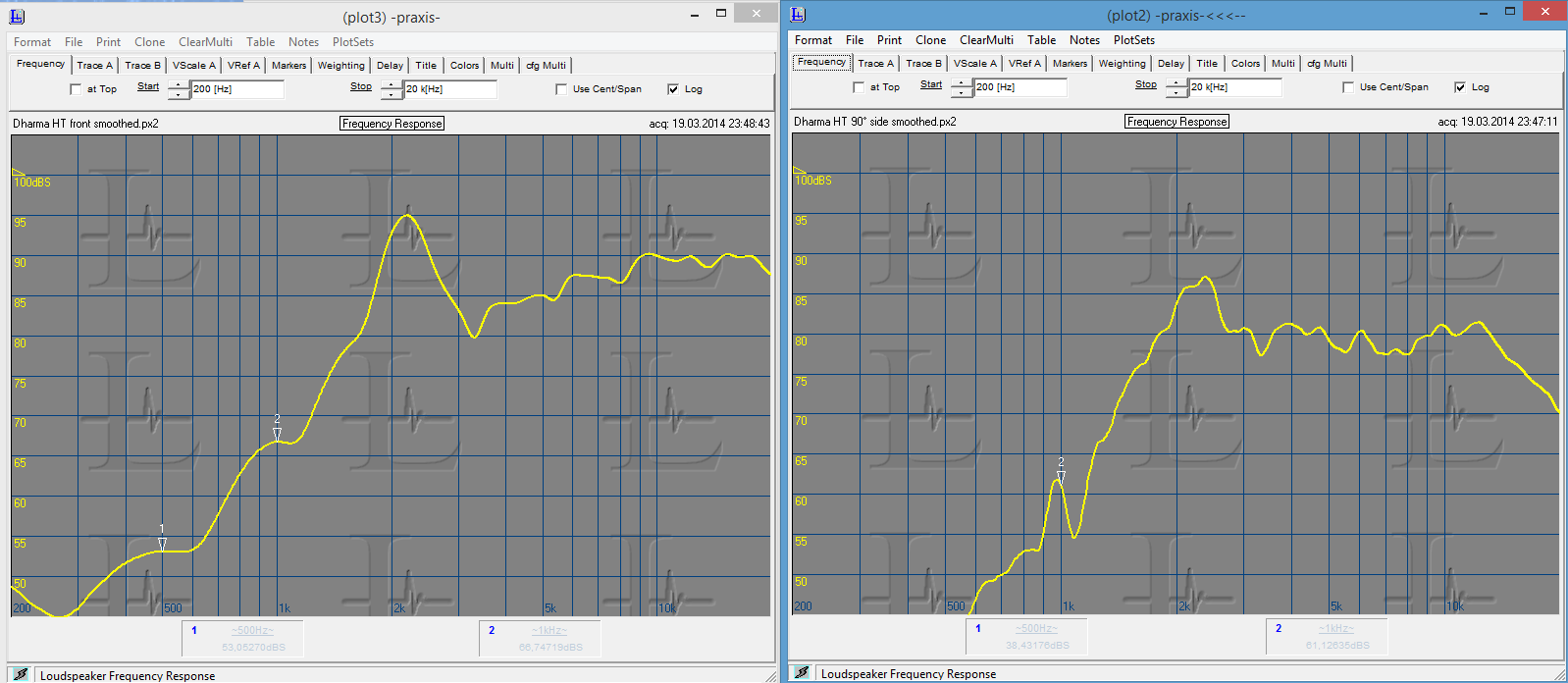

Here are the measurements on the tweeter.
The second picture compares the measurement from the front with the measurement from the side 90°. The second picture is the same with another scale.
Forget the first measurement on the left.
The 4th measurement shows the response on axis compared to 45° off axis.
Hi Joachim,
thanks for the sneak preview.
At what distance did you measure ?
And what is what in pic 4 ? Yellow looks like 45°. But what is off set, in which direction ? Is red pushed up by 2dB ?
Thanks again !

Joachim,
thanks for taking that effort too!
Your 0, 45 and 90° measurements suggest an impressively constant directivity of the "baffled" AMT from 6-13 kHz. Sadly the Mundorf AMT flyer stops at 30°. If you could measure the pure AMT too for comparison, that could shed some light on what SL really achieved with his baffle shape.

I measured in ca. 50cm.
4th picture red is on axis and yellow is 45° frontal.
It is hard to keep the measurement distance constant so the sensitivities may not match to the last dB.
I will repeat that measurement and hold the distance constant as much as i can.
Also 15°, 30° and 60°.
Between 3kHz and 5kHz linearity is a bit better off axis.
I do not know if i can improve that by changing the shape of the baffle.
On the other hand i will use the AMT only over 7kHz and there it looks fine.
The null in the area of interest is ca. 10dB.
That is aprox. what Kreskovsky gets in the older NAO that has the B&G magnetostat.
The new NAO has a stronger null and i asume the LX521 is better too.
I think that comes because is both cases the tweeters are rather small.
The AMT is wider so the null is not that strong.
Yes, the AMT starts to beam over 13kHz.
