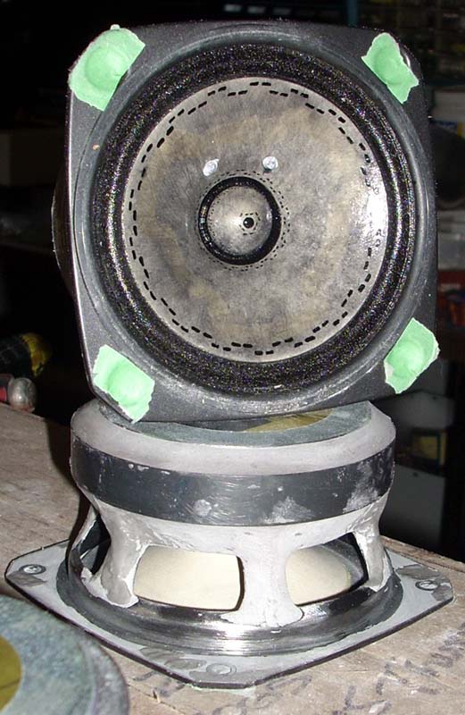

Hi anybody
just to share with you, what happend to my w4-1320:
brown: some 3mm thick felt
gray: 0,5mm felt
the most effectful thing was the small piece inside, between basket and membrane. The highs are smoother now, not so sharp und the speaker produces a deeper image.
try it, it's easy to do .
gray: 0,5mm felt

Ed LaFontaine said:I'm considering the Pioneer A11EC80
I've never actually seen one of those (other than in pictures). A favorite of gychang. Has been used as a budget substitute in many an FE127/FE126 box with surprisingly positive reported results. Why not give it a go as a sub for the FR/WR125?
I'd approach it as i do any other paper cone driver... puzzlekoat, EnABL, ductseal (if you want to go whole hog, i'll trade you a "jar" of SR500 for some clear pollyscale (just about thru my 1st bottle, and it isn't available in Canada) & a phase plug if it fit one of the standard sizes (1" diameter VC, means either a B200 or FE16x plug should be workable, but in the spirit of keeping the price down, something found might work better -- i have a box of neo-corks that do a passable job for this size VC).
dave

It is as much about making the rear of the basket aerodynamic as it is stiffening/damping it.
And if the latter has no point then i assume that means that all these drivers with cast aluminum baskets are just for cosmetics? (they do i admit usually have less obstruction in the form of basket legs)
We are trying to maximize the downward dynamic range of the driver/box system. Once i get them finished and installed i let you know how much audible difference it seems to make.
Really thick baffles have their own problems -- and with these small FR drivers they can get really big.
dave
PS: and the thread title does say extreme 🙂 One might equate what some of this is to the guy that adds a nitrous injecter to the supercharged engine in his street car (or the guy with the 34" woofer in the back of his 3-door hatchback.

I completely understand about improving the basket aerodynamics of a large driver with large amounts of Xmax, but is it really beneficial to drivers with less than 1mm of excursion such as 90% of these FR drivers? They don't exactly move a lot of air and doubt they have enough "oomph" to produce any port chuffing in a typical BR design.
I would imagine the cast baskets came into play originally for large drivers that were capable of large amounts of power handling and output. I know a lot of companies talk about how their cast aluminum baskets wick the heat away from the VC's while also maintaining a nearly flex-free design so everything stays perfectly aligned throughout the safe operating range of that driver.
I assume the cast baskets trickled down to the smaller drivers for similar reasons while also keeping the entire unit weight down. Plus the fact that most cast baskets are already much better damped and stiffer than their stamped steel cousins.
Downward dynamics... This is a term I am unfamiliar with. I have tried a couple of Google searches on this before but didn't come up with anything that actually explained what it means. If you could please explain or post a link or two for me, I would certainly appreciate it. Once I know what downward dynamics means, I might start to understand why some of these mods "tricks" are desirable and useful.
When I mentioned about the really thick 3" - 4" baffles (Thiel Audio comes to mind), I was referring to larger drivers like 8" and larger. I can imagine a baffle that thick for a little 4" driver would look like a small TL on its own... a.k.a. - a tunnel
BTW, I never said "extreme" was a bad thing. I'm definitely one for overkill. 😀
As long as we are dealing with opinions, and I don't have any facts to back this up:
IMO
If properly mounted, a stamped basket does not ring. By properly mounted, I mean that the basket is solidly bolted to the baffle. If the basket is softly bolted into a thick, cushy gasket, it will ring like a bell. The gasket must be squeezed until the basket is is firm contact with the baffle.
Stamped baskets are perceived as "cheap", cast baskets are perceived as "quality". Overall, a cast basket is easier to build with adequate structural strength to keep the magnet from moving. If the legs of the basket have at least a 45* chamfer on the inside surface, there can be no reflections back into the cone. To get the required strength, a stamped basket has to have sufficient metal guage. At some point, it becomes difficult to extrude the metal and leg width must be increased. Trade off.
All stamped baskets present a flat surface to the back of the cone and will reflect. What the results are I don't know. The frequencies involved are quite high. Putting felt on the inside of the basket legs is so easy to do that doing so becomes automatic, whether it does anything or not.
I have my doubts that smoothing the aerodynamics around the magnet structure does anything useful, but I haven't investigated this. Since I use mainly the shielded Fostex and Lowther DX drivers, it is a non issue to me.
Putting a felt pad on the back of the magnet makes no sense to me. Any reflections that get to the driver are off of the cabinet back, off of the magnet, back to the back and then through the cone. There is almost always some form of damping on the back of the cabinet that will attenuate this. Same with a standing wave between the magnet and the cabinet. If someone would like to show me an FR plot that demonstrates this, I'll be happy to change my opinion.
I also have my doubts about a screw through the back of the cabinet that presses on the driver magnet. Since I don't believe that the magnet is actually moving with any decent driver and at the power levels we are inclined to use, the effect is probably to increase the structural integrity of the cabinet. This is particularly important with speakers like unbraces "Voigt" pipes made of too thin material. I have avoided this issue by strongly bracing the cabinet around the driver so that nothing is inclined to move.
As I said, IMO.

chops
Downward dynamics is just a way to express something almost always overlooked within a musical playback event. When a musician plays, he makes a piece of music his art by small changes in instrument dynamics internal to the notes he plays.
In the same vein, instruments themselves can be separated by subtle inflections of both time and emphasis, applied to the constituents that make up a chord. The cone treatments and these basket treatments are aimed at revealing those aspects of recorded music rather than the more usual bulk FR and decay plots.
Most folks have not explored these areas in music reproduction because until the EnABL process was let loose, most drivers were not very capable here. The most capable have historically been the FR drivers, in the before EnABL world. These were the first to be treated by folks on this forum. The individually limited bandwidth, multi driver systems, are just as good at reproducing these tiny, subtle, pieces of information, once this sort of extreme care of cone, basket, baffle and back wave has been applied.
You will not find these comments in an orderly or scholarly format yet. This is a new thing, happening on this forum, for the first time in a public information sense.
