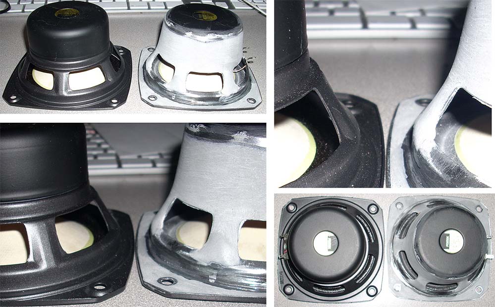

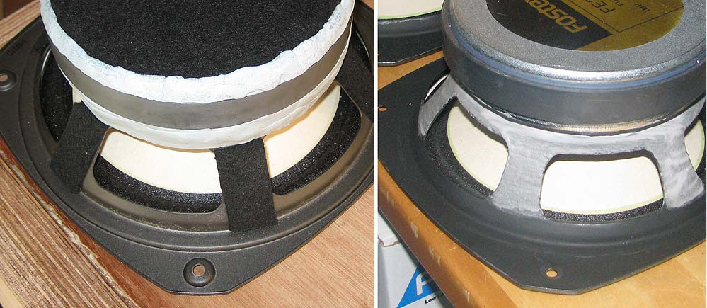

Just finished modding the basket of my FE206E's.
Decided to use blu tack as I wasn't sure what product to buy in Australia that is similar to duct seal or sr500.
Stuck felt on the back of the magnet and on the basket legs.
Any comments dave?
Any comments dave?
BluTak is a good sub for ductseal.

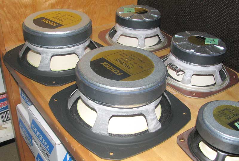

Wixy's picture gives me the opportunity to start showing pics of what our prime use of SR500 is.
Attached is wixy's pic, plus a 206 that has had the bezel stiffening finished. The hollow "dish" of the front bezel has been filled with SR500, flattened (big razor knife + sanding), and then painted with black acrylic.
This dramatically stiffens the front bezel, and damps the entire basket. You can also see a fresh coat of SR500 on the basket legs and in the basket/magnet cavity. This driver may need one more coat & then the remaining cavity will be filled with ductseal. The few layers of SR500 in the cavity stiffens up the structure and i get 2 levels of damping.
dave

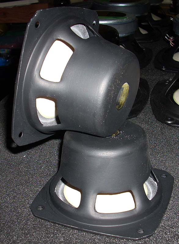

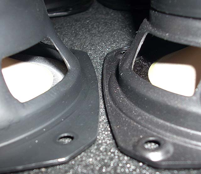

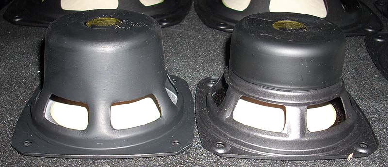

ecir38 said:Beautiful job Dave. How many coats did those take?
More than 30... yook about a month
dave
