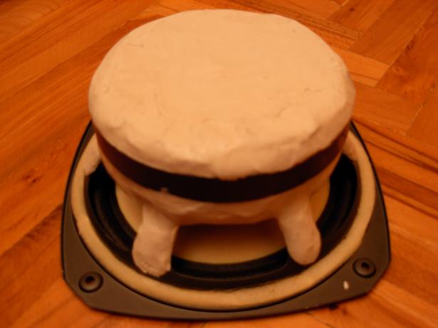

I've started using rope caulk for damping and plumbers epoxy putty for strengthening.
Dave, regarding the space behind the front flange on stamped fostex (and other) baskets - do you think damping or strengthening is more important at this location?
Dave, I've been on a parallel path to yours, wish I knew earlier. I'm working on shaping trailing edges on the legs and entire magnet as well. trying to get a nice mold-able shape.
I also have a dead fe-127 that I'm using to model a completely new frame for.

Illusus said:Dave, I've been on a parallel path to yours, wish I knew earlier. I'm working on shaping trailing edges on the legs and entire magnet as well. trying to get a nice mold-able shape.
We do need to figure out how to get you out here permantly.
dave
AdamThorne said:regarding the space behind the front flange on stamped fostex (and other) baskets - do you think damping or strengthening is more important at this location?
I don't know for sure... my guess would be stiffening, but probably not by much. If you grab a Fostex basket in your hands and twist, that it moves at all is indicative (it doesn't after stiffening)
dave
