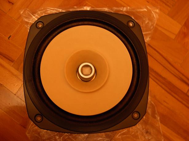

I've done two mistakes:
1. Used a wrench socket instead of a wooden phase plug. Not so nice. Gotta remove it and make a proper plug.
2. Applied one thin coat of dammar. I think it made them sound worse.
Gotta do something about it. Puzzlecoat? Enabl?....
Anyway I can't properly evaluate them, as they are boxless now. I've abandoned them when I bought Visaton B200. Now I am contemplating about a new enclosure. Will be either a short BIB or a full Chang. (BIB has better chances, but...)

That socket would work much better if it was closer to the diameter of the pole piece. That gap is huge and should be 1mm or less, as small as possible but not rubbing. The best solution is getting proper, wooden phase plugs.
Dammar worked well for me but, if you don't like it or applied too much you can remove most of it by carefully wiping it off with a soft cloth moistened with 99% alcohol. Just don't soak the cone. It'll take many light passes.
