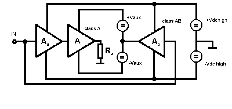

Class A+ (class A tracking) would go above 50% 😉
I had to Google that, what you're referring to is class-D modulated supply rails with a class-A amplifier? Upon reading the paper it seems a lot of work and complexity to get to 70% max efficiency, I wouldn't bother, just get a bigger heatsink and a bigger transformer 😀
No, I mean class AB that drives center point of the power supply that supplies small class A amplifier with full load current capability. This saves a lot of heat, though it is quite complex. It was Technics in seventies/eighties who came with the idea.

I think this is what you're referring to?
Looks overly complex to me, just to save a few Watts?
No. I think there is a link to a patent in the thread I gave a link to.
In case you wish to have 200 - 300W true class A you have no other chance, re heat dissipation.
