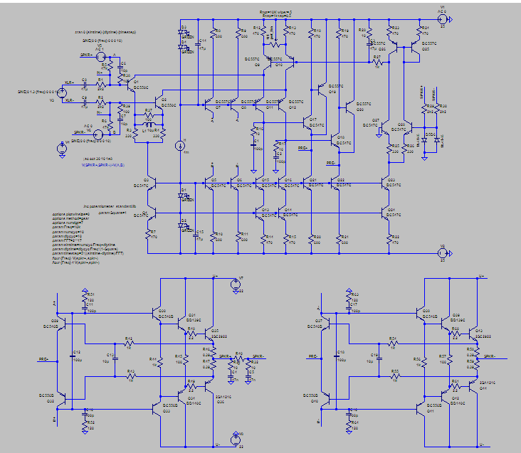

i was looking forward to a good expert level exchange on this topic and expecting some good learnings to come out of it.
I'd like to take a stab at it, but I'm a bit rusty as I don't design amplifiers on a daily basis, nor have the wealth of experience Bruno has, but alas, lets have a look. It needs no further explanation that the step response isn't particularly clean.
One thing that's clear from the simulations is that the slewrate limitation as reported by Pavel (and verified in simulation as well as in the real world) is mostly due to the two 10R/1nF RC networks that are at the input of the two output stages.
They are R40/C12 and R41/C13 in the schematic above. They are driven from the predrivers which is a Sziklai transistor configuration, biased to ~4mA. These are Q38/Q39 and Q37/Q40 in the schematic below, their output is PRE+ and PRE-.
Biasing these higher will result in more drive capability, and hence better slewrate, the downside is that dissipation will also rise. Changing R34/R35 to 470R rather than 680R raises the bias current to 10mA. Simulation shows that this doesn't solve the problem though.
We can obviously lower the value of C12/C13 in the RC networks, but doing that to a large extent makes the amplifier become unstable, so we'll also need to compensate elsewhere. Dropping C12/C13 to 220p shows improvement, and no unstability, but there's still overshoot and subtle ringing on the output, dropping to 100pF makes the amplifier unstable. So lets keep these at 220pF for now.
There's two other RC networks though, R38/C10 and R39/C11, if C10/C11 are made larger in value that should straighten things out again. Doubling their value from 33pF to 68pF indeed does the trick. Below is the amplifier with the above change and the step response stimulus (PULSE(-1 1 0 100n 100n 50u 100u). The THD values are slightly better in the simulator than the original with these changes.
I unfortunately do not have an ExtremA here I can test this on, so I'm hoping Pavel would be able to try this out in practice. It requires swapping out a total of four capacitors.
If anyone would like to offer different suggestions I'd be happy to hear them.
Sander, I greatly appreciate that you have returned to the circuit. Regarding what I can do and I have have already done with the ExtremA, please let me summarize.
I have built another amplifier with your, slightly modified, output stage. It is a SE version with opamp frontend, please see the schematics:
This circuit has very low THD, that confirmed YOUR THD measurements (I have shown the measurements earlier in this thread). This circuit also has smooth, RC – like step response, that is not slew rate limited, shown again:
Then, about 3 weeks ago, I was asked by one of the builders here, to help with measurements of the original, i.e. yours and Bruno's design. That's how I found the problem with step response, which I have also simulated with very similar result as the measured one.
I have tried to reduce C4 and C9 (original names per your webpage, now C12 and C13 in the post above) capacitors from 1nF to 100pF. The result looked promising, step response was clean (though slew rate limited), but – THD rose to some 0.2%. Though oscilloscope has not shown any oscillations, the circuit must have been oscillating at least locally. So I have put back the original 1nF capacitors back. I do not have your original amplifier design yet, it is back at the owner, which is about 300km from my place.
Later I have been playing with simulations as well and came to similar conclusion as you have made. The C4 and C9 should be no smaller than 220pF. The modified value of two further capacitors should help as well, the last thing to do is to verify it in the real amplifier, I hope the guys who have the amplifier now might try it.
Thanks again for your co-operation, I believe we are on the right track now.

Intersting OPS.
In the sx-Amp, I use a single transistor to regulate the OPS current (700mA per pair). I used this same (single transistor) technique for the buffer stage in my Symphony preamp to get ppm level class A performance in to 32 Ohms. Later, I used a two transistor regulator with current source load very similar to the design above - I posted up a circuit in the Headphone forum.
It of course does not handle the power that the ExtremA does, but the distortion in class A is in low ppb (simmed) - around -130 dB ref 1V out, and still -120 dB at ~3 V out. So the basic OPS concept can deliver outstanding class A performance.

Here is another possibility, at least in simulation looks everything OK, distortion, stability, etc. SR, clipping behaviour is improved, and also excursion in class AB is without problems.
@Pavel,
I like what you've done here, I've always wondered how the output stage would fare with an opamp frontend, never had time to take a closer look though. This, with a bit more work, can easily be turned into a bridged configuration with balanced input. That will help with overall efficiency, which, even on the ExtremA, isn't great courtesy of the class-A OPS, we're at about 40% with the ExtremA.
I would certainly be interested in exploring this further, the design of a poor-man's ExtremA would be a possibility. One of the complaints I've always heard about the current design is that there's too many parts and it is too complex.
One approach could be to take a (balanced) instrumentation amplifier (dual opamp) as an input stage (with all the required EMI/RFI measures) then subsequently two of the amplifier stages with an opamp frontend and round this off by tying a DC servo around the whole amplifier.
Anyway, I'm getting ahead of myself here. I'll see if I can find someone with an ExtremA locally so the proposed changes can be worked in and verified. Thanks so much for your help and suggestions thusfar.
