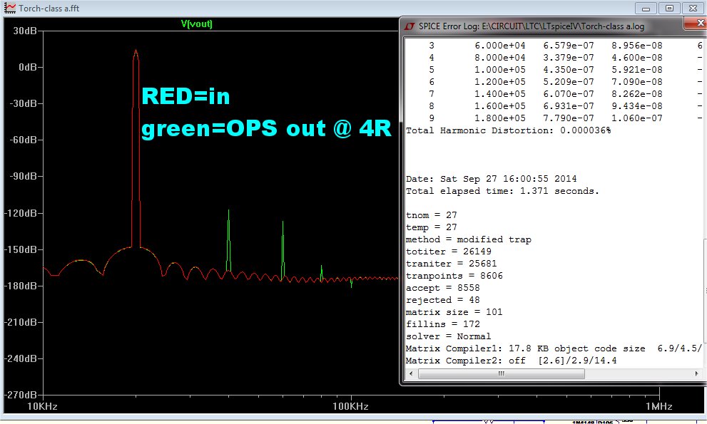

Enough other threads to discuss ostripper's amplifiers, isn't it.
I did not post that to discuss my OPS's .... I am about 95% "up to date"
on how this one works.
I am saying I am quite impressed by it's generic performance.
Kudo's to the designers.
This is just a stepping stone ... I want a VFET/LFET Class A (switchable to
AB) OPS. This design is too limited (but instructional).
PS - this is actually a simple version of the "YAP" HEC OPS
(syn08) , but YAP is AB only (for now).
OS
BJT's are fine (excellent).
The "out of box " performance is stellar , as well.
Whether they build the whole amp , or tether on another
IPS .... this OPS adds nearly nothing .
Test is without NFB !! (below) ... -140db as predicted ! 😎

I will say - anyone who builds this exact amp
will be in for a low THD "treat". I simulated ALL of it. :up::up:

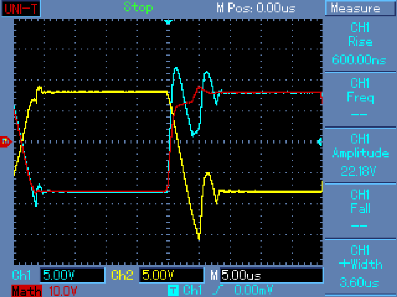

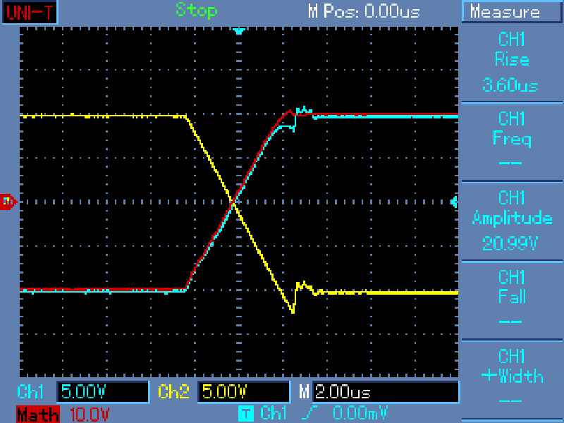

Hello Sander,
as you know, I have received a request of one of the amplifier builders here to make measurements on his ExtremA. It was built on original PCBs, without visible mistakes.
During measurements, THD was low as suggested, at kHz range. Unfortunately, I am not able to measure THD 10k or THD 20k with enough precision.
But, CCIF 19+20 kHz result was not adequate, so I started to suspect low slew rate. I have measured step response, with results attached (you know them). The amplifier has balanced output, red track is this.
So I tried to change frequency compensation, by reduction of C4 and C9 to 100pF, and I have also tried another methods. The results looked promising, re step response, but distortion (at any frequency) rose more than 100x – clear indicator of local oscillations.
I had to put the original compensation back. The result (original circuit) is very low THD, not so good CCIF and low slew rate (10V/us) with not nice settling. Maybe Bruno might like to tell us more on step response settling?
Re DC – your suggestions are all fulfilled.
Best regards,
Pavel

Hello Sander,
as you know, I have received a request of one of the amplifier builders here to make measurements on his ExtremA. It was built on original PCBs, without visible mistakes. ... <snip>
@Pavel,
It helps to illustrate what you're doing here exactly, from what you've told me the input signal is a squarewave with Trise/Tfall = 100ns. I've discussed this with Bruno and forwarded you his reply, I'll post it here as well so we may end this off-topic discussion. Feel free to contact me privately if you want to discuss this further, I'd be happy to hear from you.
Bruno Putzeys said:
Higher order loops tend to do that when you drive them beyond their slew rate limit. One designs higher order loops for their ability to reproduce low-frequency signals with exquisite precision, not to follow impossibly fast signals reasonably well. It's an audio amp. Play music through it.
Sander,
I agree this has been somewhat off topic discussion here, however, you have provided a schematics here in the thread with respect to no output coil. Very low slew rate may be the real reason why the circuit does not need output inductor.
Re Bruno's answer, I find it inadequate and I cannot admit such behavior in time domain. With such kind of reasoning, that Bruno has shown, we are back in the seventies in times of THD wars.
I promise you that I will not continue in this discussion here, however the circuit is out for public and they should now how it behaves in time domain, if the author has not provided such measurement himself.
Pavel

In case this debate continues - I made a comparison of the original circuit vs. ExtremA output stage driven by OPA627. The version with OPA627 has both lower distortion and much better step response with higher slew rate. The step response is RC like, following exponential formula
Vout(t) = Vo * (1 - exp(-t/Tau))
The issue that Bogdan has addressed is class A to AB transition. As you know, it creates sudden distortion in the output stage, as had already been shown in the ExtremA thread. I admire excellent low distortion when it stays in class A, however the circuit has issues. This transition point depends on idle current and one has to stop somewhere to be able to cool down the whole thing.
