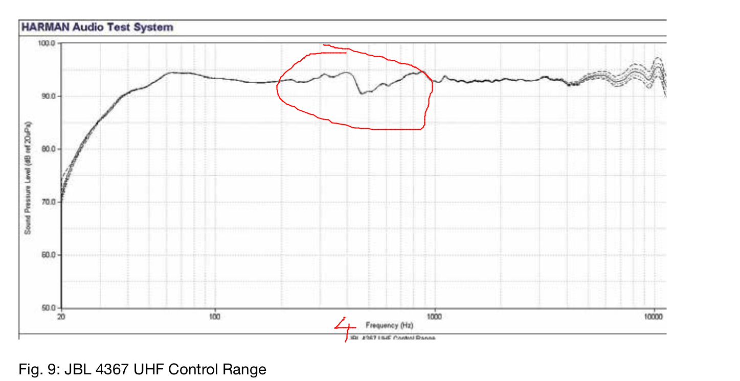

I repeat to you 15" cannot do midrange ! is quite simple just look at what do 😉 jbl in a 20k $$ semi active

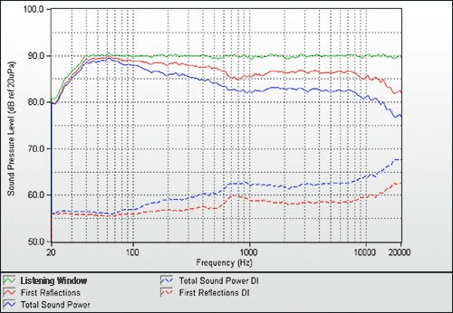

Below is the polar of the Gedlee Ns15 I believe. An example of the directivity achieved with large woofers and waveguides.

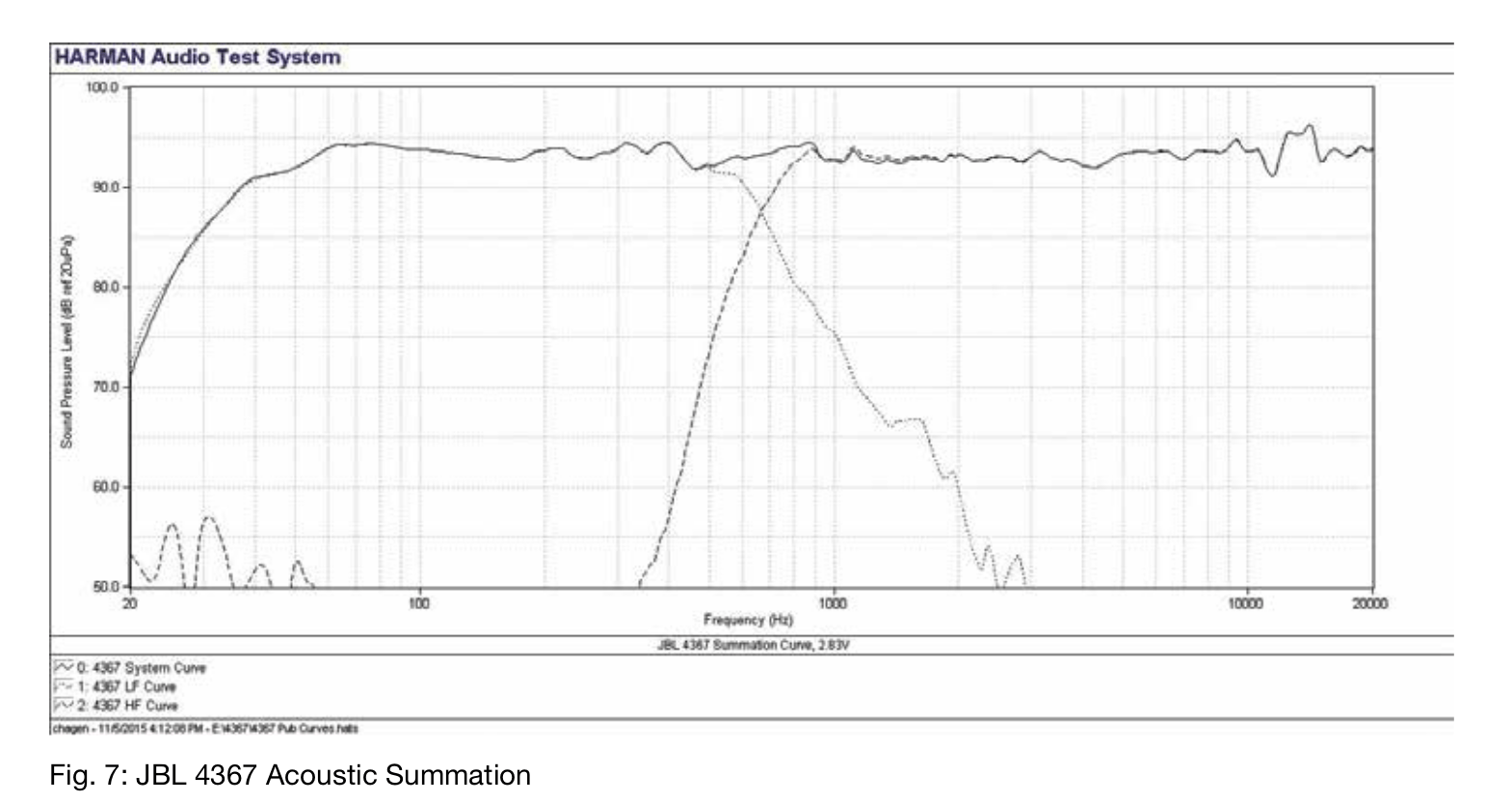

you must add the active sistem... 15" must cut under a 400-600 end of the story NO MIDThe M2 is 12k.... and the FR of said speaker is not proof that a 15" can't do midrange.... the trend line is +\- 2.5db and that is fine. It is also the anechoic response. The higher the directivity of a loudspeaker the less room interaction, the sharper the IR. A smooth FR is desirable but how does one achieve this in a room. Directivity and room treatment is the common route....
Maybe you have a speaker to compare to the M2 that you deem superior so that we can continue to compare and contrast?
we can see the same XO point the is mid made by compressor driver !an 1,4 maybe ?Below is the polar of the Gedlee Ns15 I believe. An example of the directivity achieved with large woofers and waveguides.

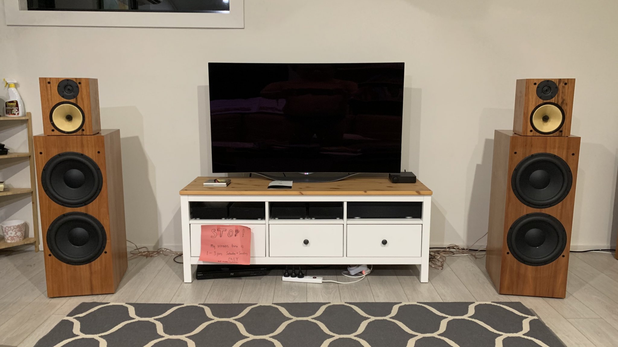

I’d put my speakers up against the M2 any day of the week, ending with a Y.
And they don’t (yet) use Purifi drivers, advanced waveguides, over-engineered low diffraction cabinets or bass boost EQ.

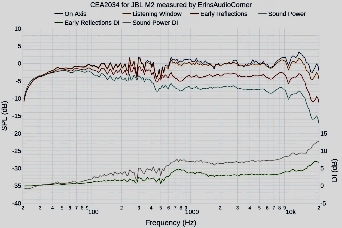

With that speaker the problem exists entirely in the vertical response mainly due to the asymmetrical horn. If you look at the Horizontal only in Erin's measurements, the response and directivity is really good.same big problem to me...

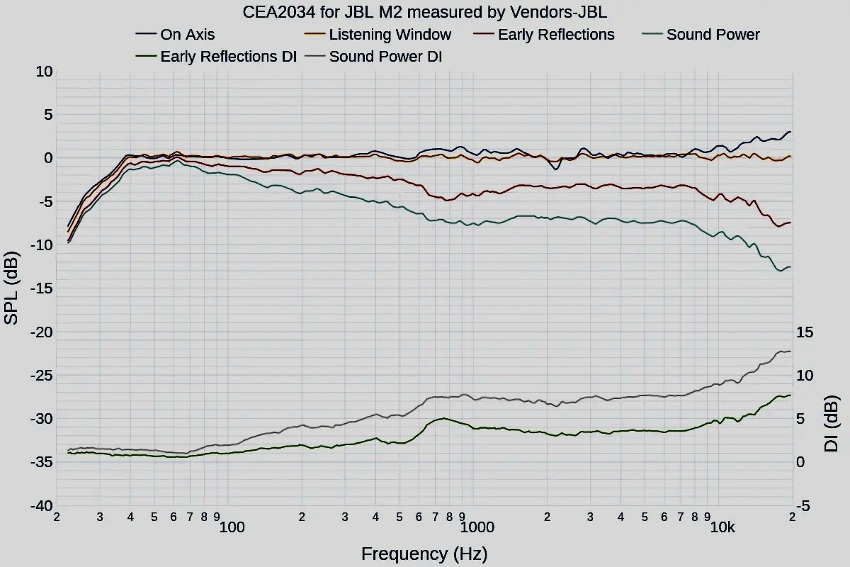

It's not clear quite what happened to the M2 because Harman's own measurements of it at some point had it ruler flat.
I think I understand what your intent is, with this measurement, Fluid.
If you look at Pierre’s measurement- he too shows JBL’s own measurement, and it shows something IS going on, between 400Hz and 600Hz too, it’s just smoothed, a bit like the one you posted.
Reference:
https://pierreaubert.github.io/spinorama/speakers/JBL M2/JBL/index_vendor.html
On the other hand- the Klippel Near Field Scanner is a real “heart breaker” @augerpro
It shows everything without make up, in clear daylight, the day after. The horizontal resolution is less than 2Hz!
Reference: www.erinsaudiocorner.com
the 4367 have the same woofer of M2 this is from Harman JBL......
the M2 have dsp too

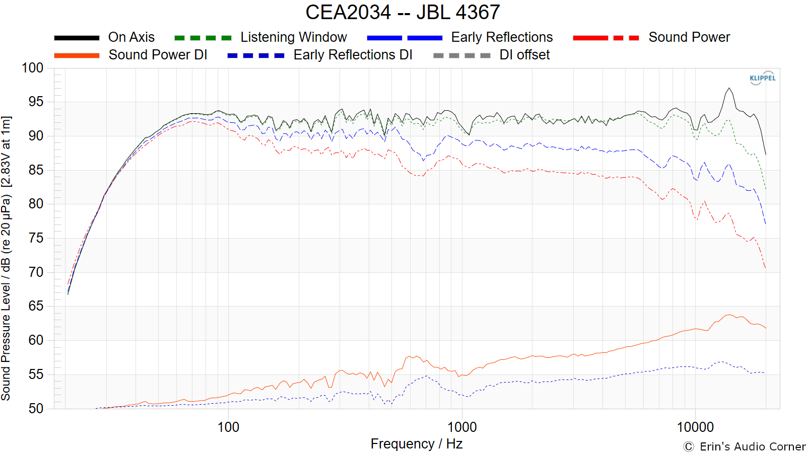

Slightly different/revised woofer, the 2216Nd-1.
Here’s the spin:
smoother than M2. Sure it doesn’t go as low as the M2; but this isn’t using DSP to do active equalisation for the bass.

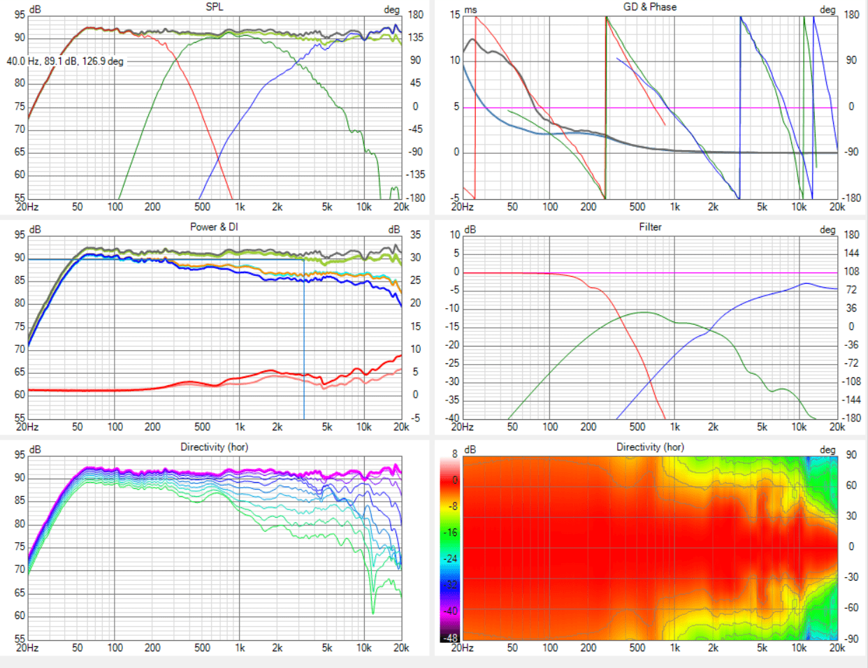

Directivity, as youve pointed out, is of high importance, vs a 2.5db margin of error in an anechoic response.
So looking at your set of speakers, your anechoic looks great... but the real show starts in the room.... and the higher directivity speaker will look closer to its anechoic response.... the speaker with a wider polar will be farthest removed from its anechoic response... where your speaker will land vs the M2, in the room. Has yet to be sorted.
But youve already increased sources and xover filters, not off to a good start.
That could be so misconstrued 🙂A lot of factors go into making a wiggle.
