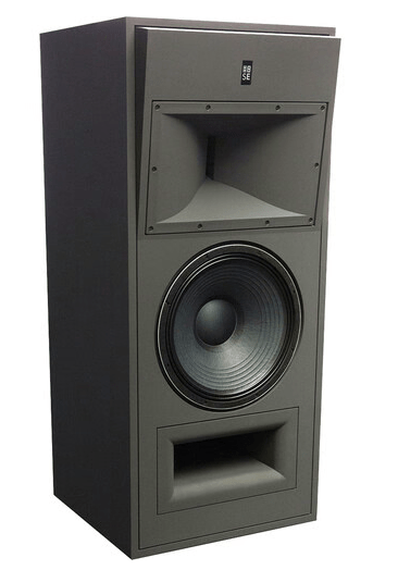

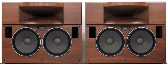

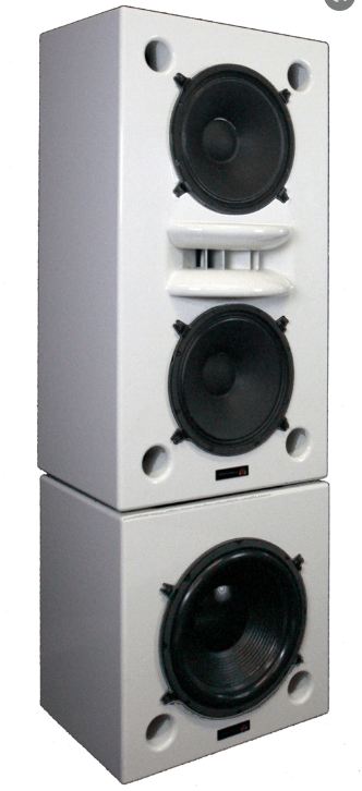

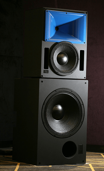

You and I must be speaking to very different people. I have never heard anyone argue that 15" is the idea size for a midrange. I've bene to a few DIY meets and competitions, seen dozens of designs presented, and never seen a 15" midrange. I'm sure they exist, but it's a bit of a stretch to suggest they represent any majority opinion.

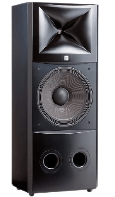

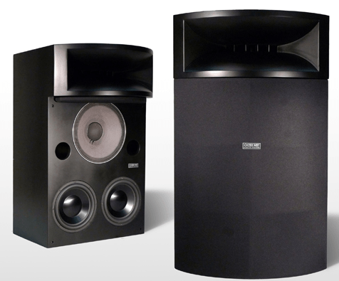

All these are Flag ship products.....All have 15" midwoofers.
there was a well know thread at avsforum where a Harman dealer hosted several get-togethers to audition the Revel Salon 2 vs the JBL M2. Floyd Toole was even involved with one to advise setup. The Salon 2 won. I think I remember listeners even thinking the bass was better. Go figure.
The only place he said it didn't matter is when working out how loud something can be. You took it to mean something other than what he said.It does matter....There are more pieces to the puzzle than "spl on axi"s......
You know those “15” midranges” are all about high voltage sensitivity and maximum SPL (dynamic range) right?
In a domestic environment a 6.5” midrange should be enough. Lots of people are happy with a 3-5” midrange. Actually most people are happy with none, if you look at the market for pure midranges.

.... I would be more interested in the Scientific sound quality aspects, not so much human preference.... if one speaker model was truer to the source and the other one was "the group fav "....I'd go for the former.there was a well know thread at avsforum where a Harman dealer hosted several get-togethers to audition the Revel Salon 2 vs the JBL M2. Floyd Toole was even involved with one to advise setup. The Salon 2 won. I think I remember listeners even thinking the bass was better. Go figure.
Neat.All these are Flag ship products.....All have 15" midwoofers.
I guess I must have misunderstood. Based on this:
Still, the majority of people here, that I've spoke to, preferred to see the 15" as the Apex mid range
I assumed that you were referring to DIY speaker builders; and claiming that a majority of them agreed 15" was an optimal size for a midrange.
I do agree there are some impressive commercial products that use a 15" midwoofer. Maybe Purifi will make one someday if there's demand.
