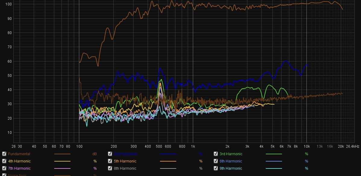

Heating the glue in the gap used to stick the protection grid down, then lifting it off without it pulling back into the dome from the force of the magnet, and after all that making sure nothing hits the dome without the grid. The whole process on a very expensive tweeter makes me anxious.What makes you nervous?

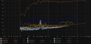

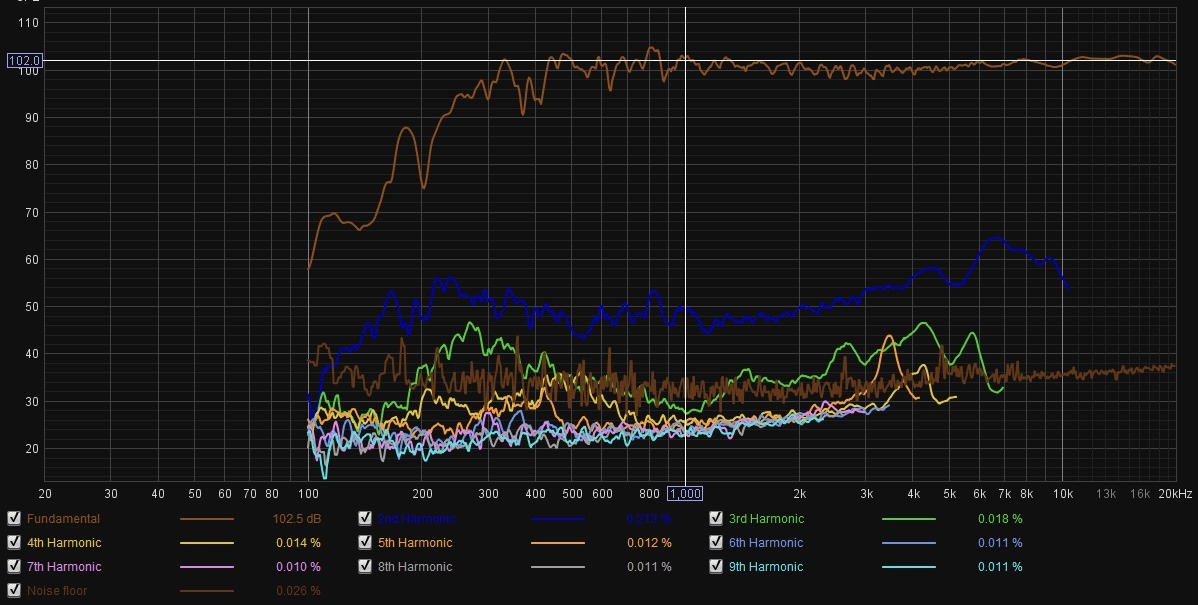

Without pointing fingers at who did what, whenever one sees “distortion” in a narrow band like that, one needs to check carefully for extraneous air gaps or vibration eg. from loose/gaps between screws and surface, binding points/terminals, loose wiring.
I have measured this narrow band of “distortion” by
1) not having screws fully tightened to fasten a subwoofer to a cabinet
2) not having foam gasket behind midrange driver frame
Before:
After:
In that Sointuva sample; it was due to air leaks through binding post bolts and nuts:

Strange that is the conclusion you came to. Those issues were the red herrings. Both speakers had those things in common yet only one showed the narrow band distortion. How the driver is mounted is important. Lars explained it here earlier. In a driver with more overall distortion this would go un-noticed. For clarity's sake the full extent of the problem was a narrow band distortion peak of 0.05% / -65dB relative to the fundamental and only at the specific SPL that made the mass spring oscillate. When that pokes up above an even lower distortion floor it looks bad to the eyes in a graph.In that Sointuva sample; it was due to air leaks through binding post bolts and nuts:
https://www.diyaudio.com/community/...ifi-woofer-speaker-builds.352063/post-7058058
"frame-motor resonance: this is a generic thing for all electrodynamic drivers. there is a heavy motor hanging in the frame which is bolted to a box. The frame acts as a (very stiff) spring and the motor is a mass thus forming a mass spring oscillator. All the Newton forces of the driver goes through this mass-spring system. This makes it very critical how the frame is fixed to the box since the high forces can cause rattling (ie high distortion).
It would be a lot better to mount the driver by its motor which is the source of the Newton forces but this is not standard. The best would be to bolt the motor onto a heavy solid chunk of metal serving as inertial reference to absorb the Newton forces.
Anyway, this is as mentioned a generic problem for all drivers but with the X stroke PTT drivers we have high Mms and a very strong motor in order to get low F3 in a compact box and this means the driver produces more Newtons force for the same SPL compared to a lower Mms driver. This makes the mounting method more critical including how much torque and what materials used etc.
When measuring on the driver laying on its magnet the problem is gone since the Newton forces terminate into the 'ground' and the frame is unterminated so we do not have the mass-spring oscillator."

A completely incorrect assessment of what was happening. Measuring speakers properly is hard enough, interpreting the measurements and understanding what they mean is much harder.So, to summarize, there is a problem caused by internal resonance which is worsened as it leaks through the gaps. But this could be drastically improved with sophisticated sealing at the binding posts and insert nuts, and additional absorption at the inside of the enclosure.
all our motors have neodynium magnets in the pole piece in order to eliminate the FFM and inductance modulation. Changing the outer magnet to neo will only save space (which could be attractive for car use ) but not change the Bl@lrisbo
Any plans to offer neodymium motors for higher sensitivity variants?
driver mounting:
We did some experiments using a simple birch ply box:
1) screws relatively tight (1-2Nm) is best and there is only a barely detectable HD peak when sweeping at high SPL (100dB or more)
2) less tightening of the screws is just detectably worse (probably insufficient clamping force which causes micro buzzing)
3) clamping the magnet to the box via some damping putty has a beneficial effect. This is an old trick in the industry (KEF etc)
Resonances: all physical objects have resonances (eigenmodes). The question is always which modes get excited and which modes radiate sound. Moreover, a nonlinear mechanism is needed to produce distortion. Anything lose on the baffles or panels may cause distortion (xover components etc). Secure clamping of the driver frame to the box is needed to avoid buzzing.
A stand mount speaker box has its bottom to top standing wave frequency in the same frequency area as the basket/motor resonance. Any air leak can produces a distortion spike at the standing mode frequency. This is a pure air resonance n the box and the leak being nonlinear. Has nothing to do with the driver.
Again, this is all generic for all drivers as determined by the laws of physics.
The conclusion: just tighten the screws well and worry only about all the so many other important aspects of speaker box design 😀
