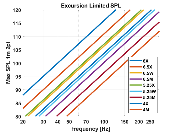

Playing around with ideas for slections guide for our drivers. Here looking at the volume displacement limits of the SPL vs frequency. Playing loud and deep bass reauires a lot of air to be displaced.
The bass SPL is limited by the maximum volume displacement of the driver (Sd*Xmax). Going one octave deeper needs 4x volume displacement. At higher frequencies the SPL is limited by the power handling. Here are the SPL limits imposed by volume displacement for our line up of drivers. Assumes a single driver in infinite bafle (2pi) at 1m distance. No room gain, no extension from a port.
The bass SPL is limited by the maximum volume displacement of the driver (Sd*Xmax). Going one octave deeper needs 4x volume displacement. At higher frequencies the SPL is limited by the power handling. Here are the SPL limits imposed by volume displacement for our line up of drivers. Assumes a single driver in infinite bafle (2pi) at 1m distance. No room gain, no extension from a port.View attachment 1091033
Nice chart.
I think seeing actual drivers instead of the textbook physics can go along way towards helping people choose drivers.
And if nothing else, help educate the need for 4X the displacement per octave deeper, and the realities of max low end SPL.
