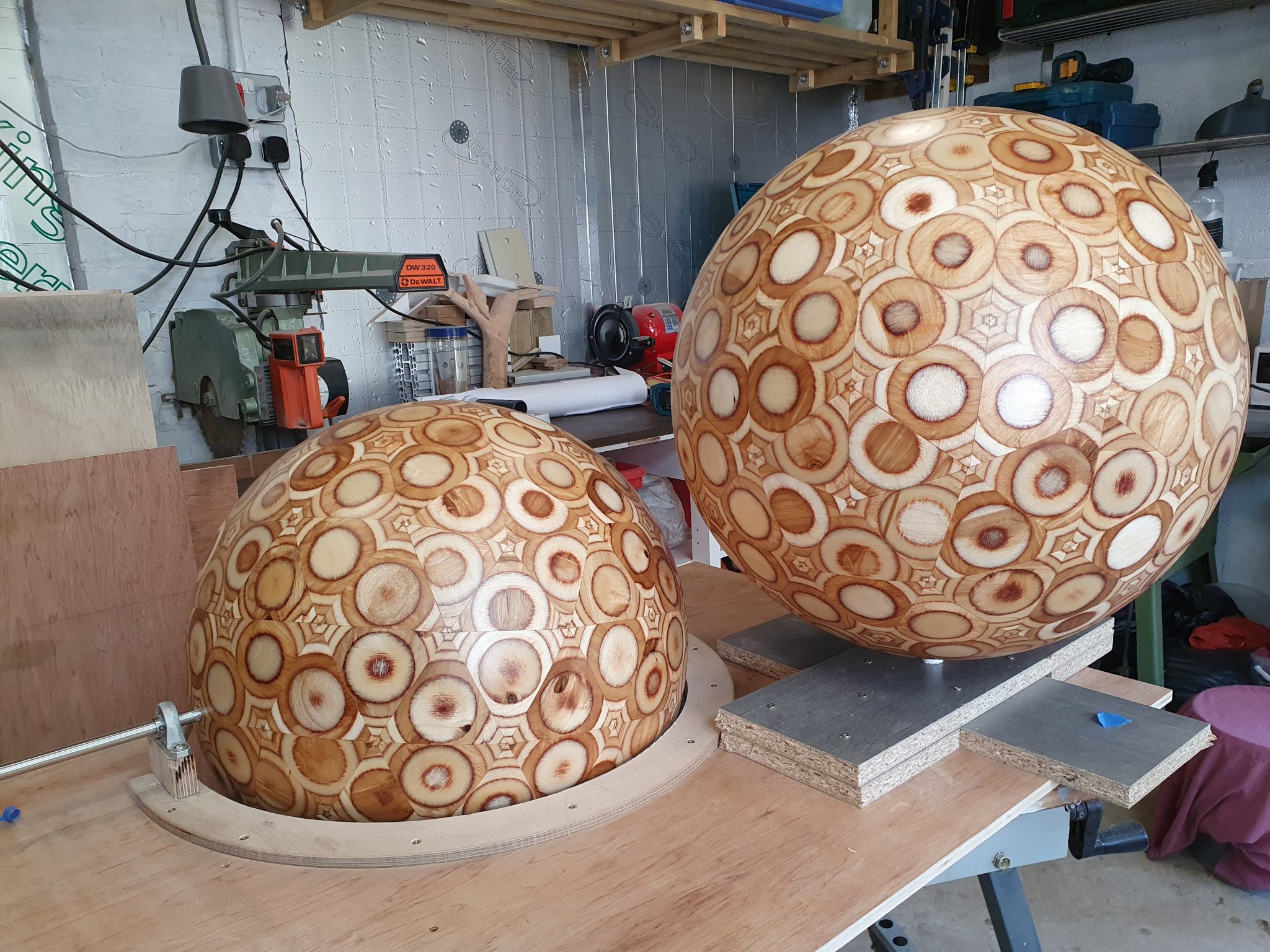

I wondered if you had any info regarding where you would consider the acoustic centre of your 8" driver (or any of your drivers for that matter) is in relation to the mounting face, I am not sure if this varies with frequency but an approximate distance at useable crossover frequencies would be useful to builders.

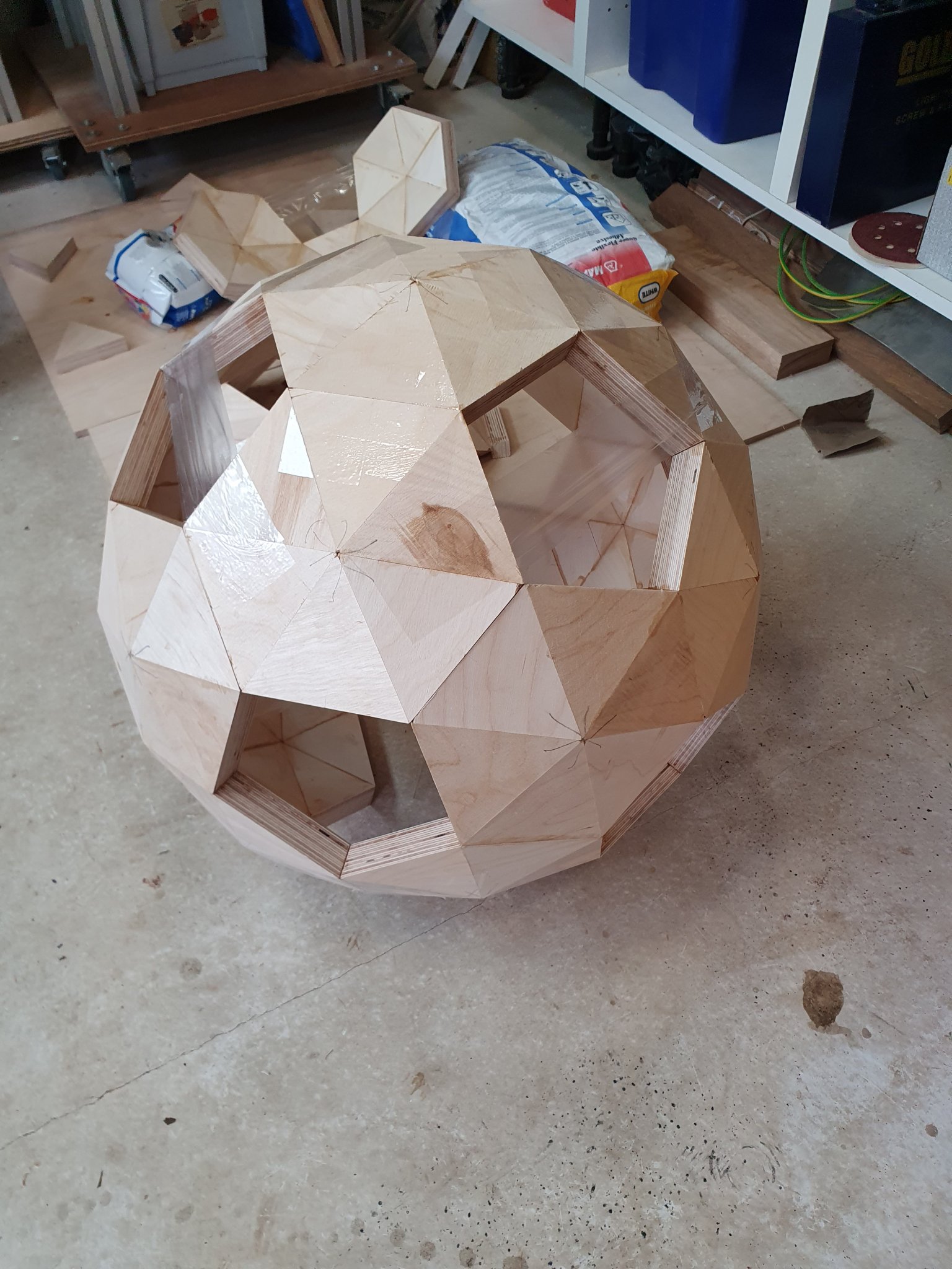

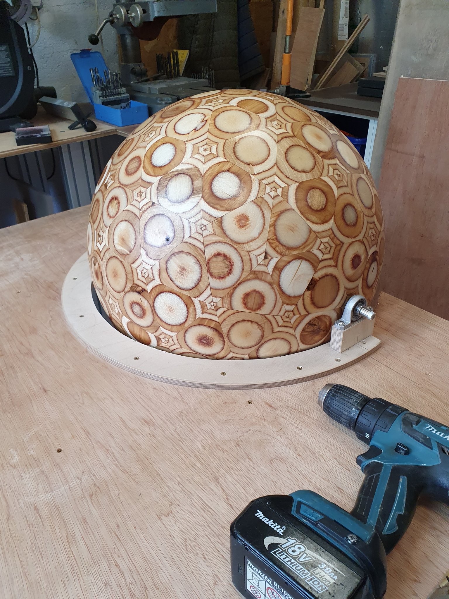

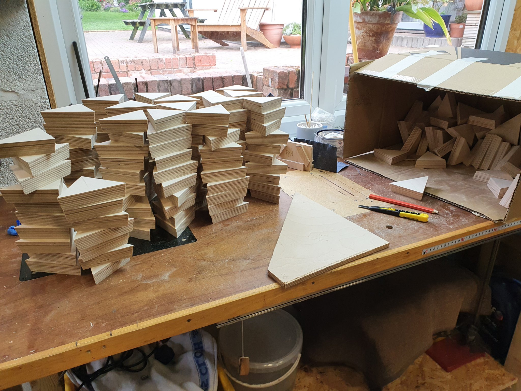

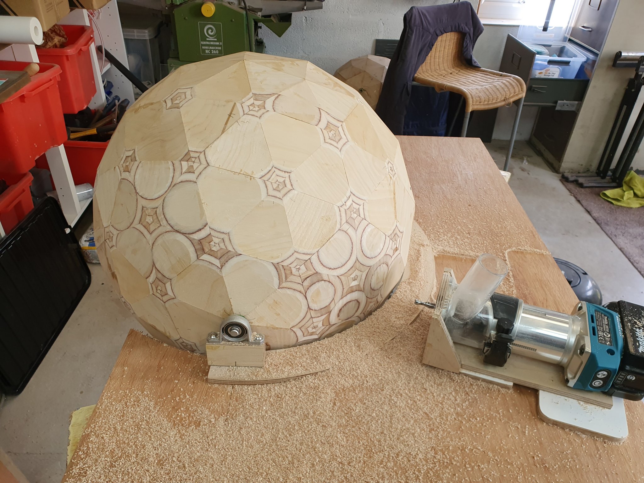

My active build is coming along slowly, 24db LR crossover and four way Purifi amps are ready, the spherical bass cabs part done (45l volume will be reduce with a smaller sphere offset internally so I can play around with final volume and reduce standing waves)
View attachment 1072046View attachment 1072049View attachment 1072047View attachment 1072048View attachment 1072050
My Viawave tweeters will be mounted in a close coupled pod and hopefully set back to align the acoustic centres.
The final crossover frequency will probably be 2k2 but will depend on the 8 ohm driver specs (any update available?)
Cheers Steve

Thanks for your intrest, I think this extra info will be useful to builders in general.
Center to center distance from my cad drawing will be 225mm.
Some progress for my build.

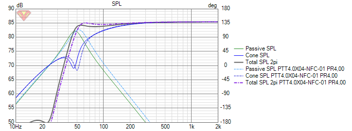

Here is the long awaited prelim 8" 8R data sheet.Hello Lars

Lovely plots for a driver with so much linear excursion. Your team has done good work!👍

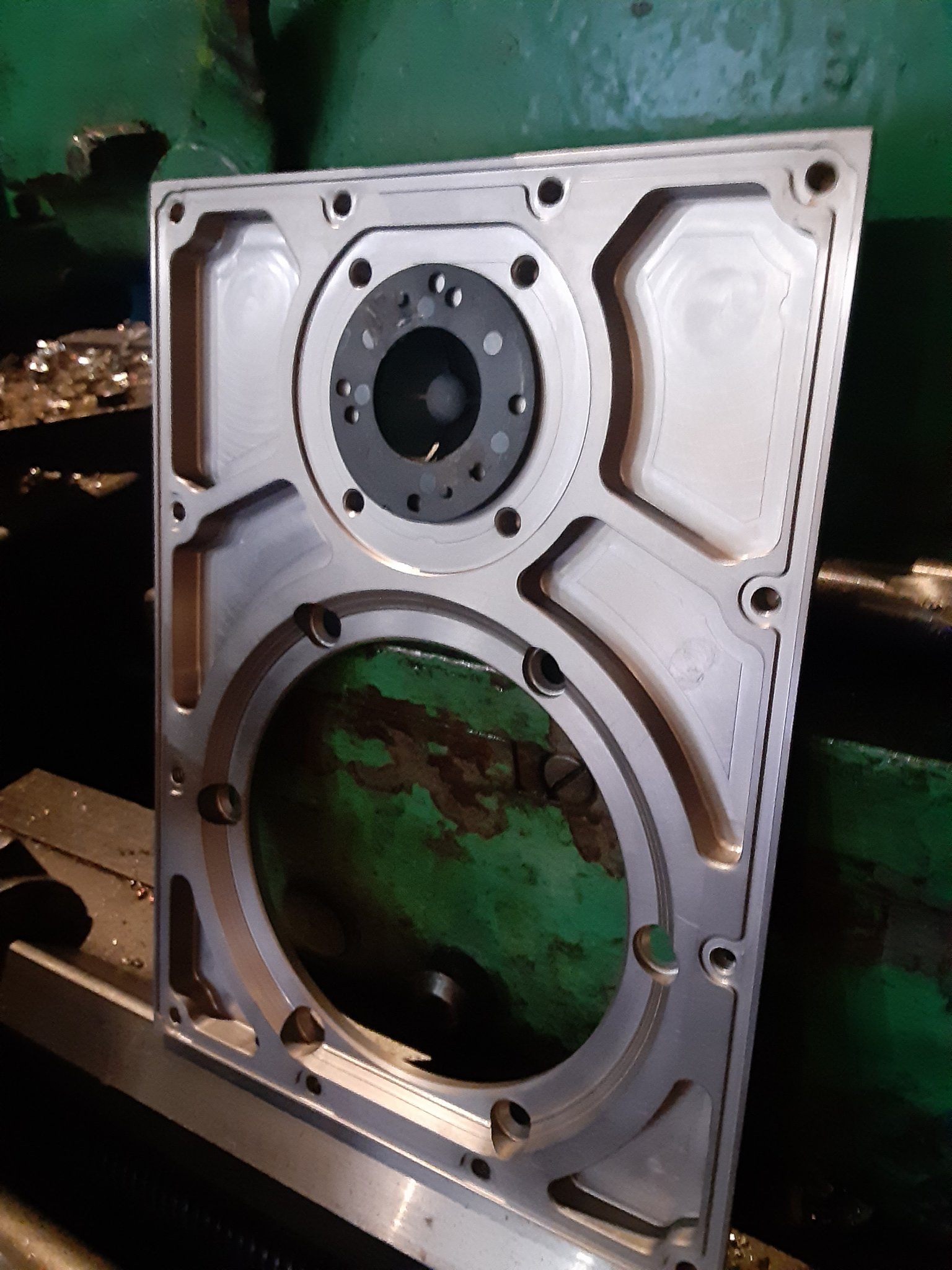

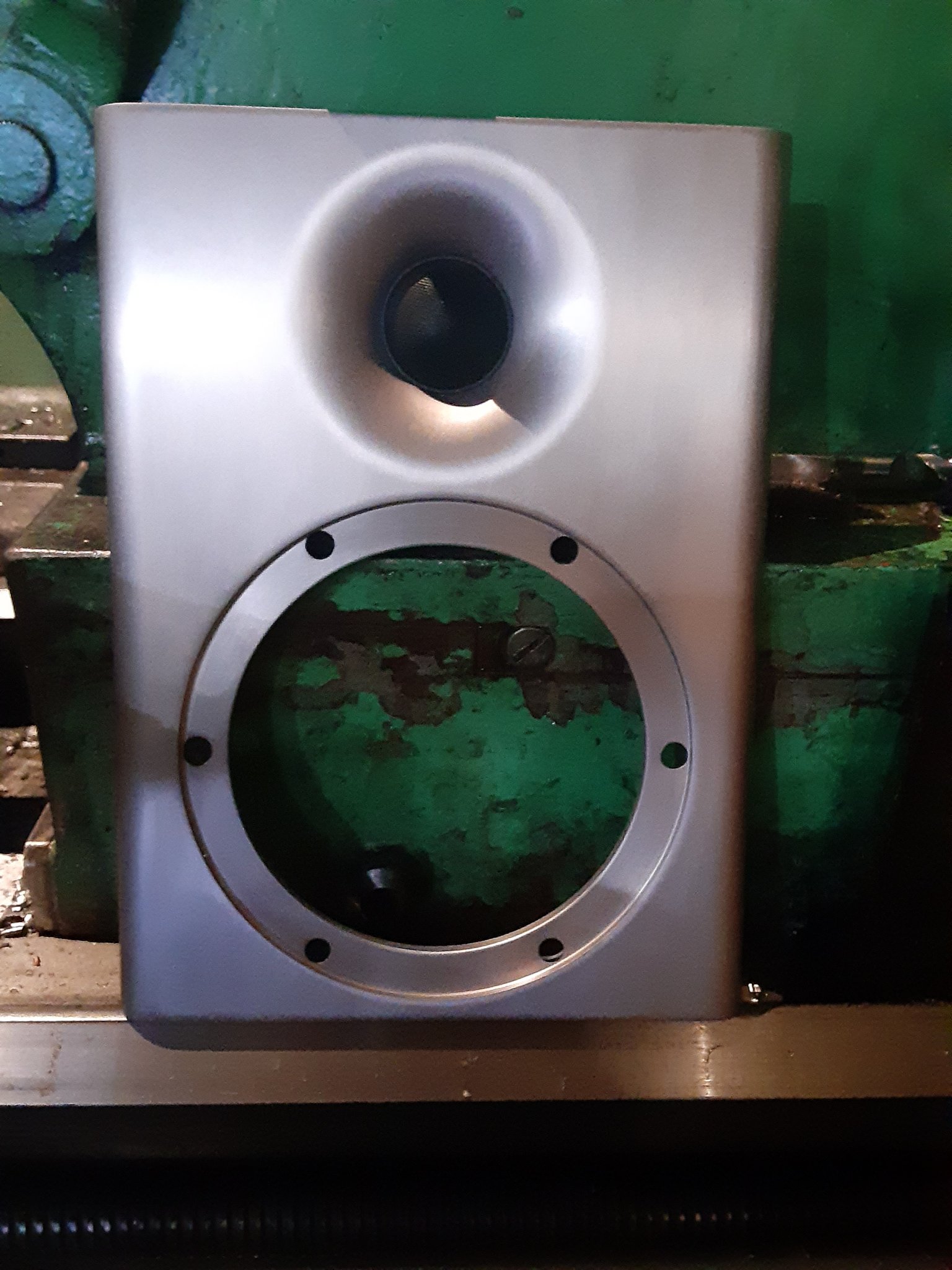

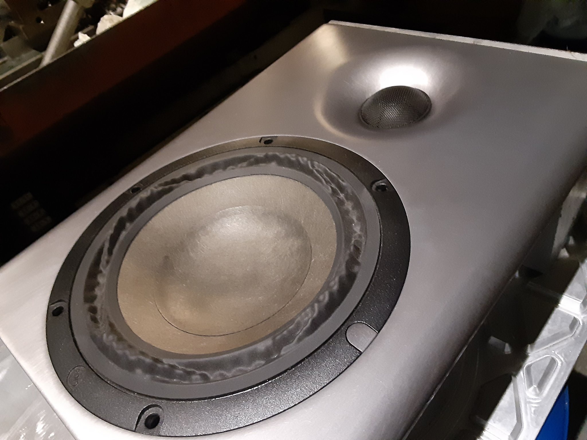

AwwwwAnyone looking for aluminum baffles? I'm working out a process for making custom baffles and the first go was to make one for the six inch Purifi with waveguide. The main tweaks I'm planning are some minor changes to the rear panel seal geometry and some faster machining strategies. Dialing in the anodize procedure is the other main objective. Note the exaggerated mounting holes; on the rear side they have a deep well chamfer and the idea is to have custom chamfered nuts with a rubber gasket seal. So the mounting bolts don't contact the baffle, and because the driver is essentially free floating the chamfered nut geometry actually handles the centering problem. Dunno whether it's a good or bad design feature, but making tweaks on the overall design is a fairly negligible fix.
I'm thinking I can do em from about 400-1200$ per pair depending of the level of finish. Also working on the flush mount bolts specific to Purifi, as can be seen in one of the mounting holes. So I was thinking to do a baffle plus hardware package for convenience. This was just a proof of concept so if there is any need for this sort of work give me a shout.

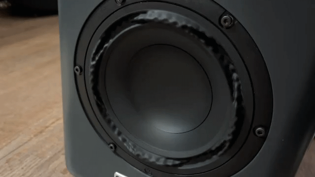

Whilst I dig through 85 pages, is anyone aware of a compact Purifi build? Bookshelf speaker, good close to a wall, not too deep.
Just been reading up! Wonder if it goes ok close to a wall behind.
Looks killer.
Benno1988 - SPK8 can work fine close to a wall - you do gain some bass-responce, and could compensate for this by increasing the box volume form 4l to 5lJust been reading up! Wonder if it goes ok close to a wall behind.
Looks killer.
