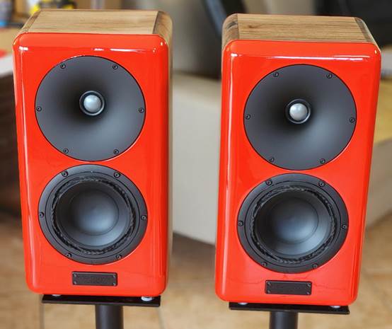

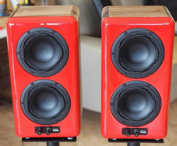

1-
Ptt6.5x with PR at first.
Good coherence between bass and mid.
I'll could add big subs and crossed them low like 80hz.
2-
Ptt6.5M sealed + RSS315hf sealed, crossed at about 200hz.
Maybe not the best match but same low extension at higher spl and better midrange.
The bass drivers could be upgraded with better ones like big Purifi in the future.
Have you some advices ?
