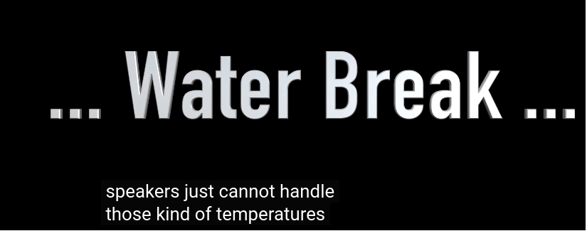

Video: people are looking for and expecting distortion😢. At least good to see the impact of distortion getting recognised amongst experts🙂Those little speakersis there more to this? He accidently said high distortion speakers but he was sorta right
😀 Quite hard with 20w classA or 8w 300B..are you joke ?Those little speakersis there more to this? He accidently said high distortion speakers but he was sorta right
What is quite hard? Do these 20w and 8w alps have any headroom or no? What levels are you listening at? 60db? What distance are listening at? You leave out a lot of important details, seem to be missing them too... Funny😀 Quite hard with 20w classA or 8w 300B..are you joke ?
this is funny, we know from you that kef scanspeak dynaudio morel seas all build wrong stuffWhat is quite hard? Do these 20w and 8w alps have any headroom or no? What levels are you listening at? 60db? What distance are listening at? You leave out a lot of important details, seem to be missing them too... Funny
