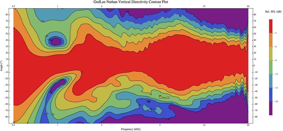

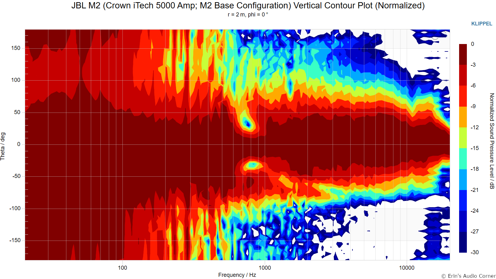

I didn't say that wiggle is the problem, but vertical dispersion of a 2-way with LR4 xo. To be more precise, it's a problem measurement-wise, not necessarilly audible at spot. Sometimes it is compensated in on-axis response to get smoother PIR. If that is good design or a way to overcome a problem, who knows. Anyway, it is an issue that raises lots of questions and discussions during this millenium among speaker designers and reviewers.You can’t automatically assume a wiggle is a problem. A lot of factors go into making a wiggle.

M2 as well as Gedlee 15" 2-way cannot avoid vertical dispersion problem, making PIR/DI wiggles.
Do you assume that Gedlee uses LR4.I didn't say that wiggle is the problem, but vertical dispersion of a 2-way with LR4 xo.
No I don't assume. Why are you constantly putting words in my mouth and nitpicking about irrelevant details? This happens in many other threads too. Isn't this just a discussion forum for hifi diy enthusiasts, not a scientific publication. Me and IMO most others JUST want to discuss here without double checking and peer controlling every sentence. Sorry.
My example of LR4 was JBL M2 and I showed vertical spectrogram by Erin's Audio Corner.
Princeton University Audio Lab have measured eg. Gedlee Nathan's vertical dispersion, and it shows typical 2-way owl's eyes. It has 10" woofer, and I don't know it's xo topology, but if I remember correctly it isn't pure bread LR4. I couldn't find bigger models' verticals.

Please do not minimise crossover type, nothing is more important in controlling DI wiggles, for a given physical configuration.about irrelevant details?
That something has gone wrong with the EQ in the M2 somewhere along the line because the directivity index is pretty much identical 🙂I think I understand what your intent is, with this measurement, Fluid.
Certainly the resolution is very high, the spikiness of the response that low in frequency doesn't really make sense though so I wouldn't see that as heart breaking truth but a strange result to investigate the cause of (which is obviously not practical in a review loudspeaker).On the other hand- the Klippel Near Field Scanner is a real “heart breaker”
It shows everything without make up, in clear daylight, the day after. The horizontal resolution is less than 2Hz!
It makes sense to me because between 400Hz and 1600Khz is two musical octaves (400, 800, 1600Hz) but mathematical frequency span of 1200Hz (1600-400)
To get a 1/24 octave frequency resolution one needs a resolution of 1200 / 48 = 25Hz.

You misunderstand me the 250 to 400Hz region seems to have a slightly exaggerated spikiness that isn't quite the same in the 4367 where the woofers are very similar. The M2 was measured on it's side which is the only real change in measurement conditions. It had nothing to do with the resolution of NFS vs Harman's Anechoic chamber. I don't remember off hand what kind of resolution they can get but they usually smooth at 1/20.
I can't imagine that comparing graphs at 2Hz resolution is particularly useful, 1/20 oct is the minimum required by CTA2034, 1/48 would seem reasonable as otherwise you could be looking partly at rounding errors in the calculations, Vituix applies this by default.
Also at 300 to 400Hz the size of chamber seen in Harman images should be almost completely anechoic meaning that there is effectively no boundary and the distance to it doesn't really matter, at lower frequencies that would not be the case but that isn't the range where there is so much discrepancy.

"I noticed the resonance in the SPIN data and this made me curious what was going on. I first performed a near field measurement of the woofer with and without the grille. The results showed no difference in this region (meaning, the grille wasn’t the cause). So I measured the impedance of the woofer in the enclosure and then removed the woofer from the enclosure and measured the raw woofer impedance. As you can see, the enclosure is responsible for a resonance around 270Hz (I presume this is a standing wave as the frequency is roughly equivalent to the height of the enclosure). There is another resonance that is in the woofer itself centered around 400-500Hz; I presume this to be cone edge/surround resonance. This is responsible for the dip you see in the frequency response at this frequency."
[snip]
"There is a series of resonances in the midrange that looks concerning in the data. In fact, that is why I went through the trouble of removing the woofer from the enclosure and testing; so I could try to find where the fault was. As I mentioned earlier, I found a resonance in the enclosure at around 270Hz and another resonance in the woofer which was responsible for a 3dB dip from about 400-600Hz. Objectively, the dip doesn’t concern me as much the series of resonances in the 200-300Hz region. However, even though I knew these resonances were there, they were not audible to me in my listening tests. That could simply be too low in amplitude as they are only about +1.5dB above the mean in this region. It could be that the room is so dominant of the sound in this frequency. It could be a combination. While I am it, I’ll also note that JBL’s own specification sheet for the 2216Nd (link) shows the same woofer resonance. Additionally, the JBL 4367 (which uses the same woofer) has some interesting data in their white paper (link) which coincides with the 500Hz dip shown in my data."
