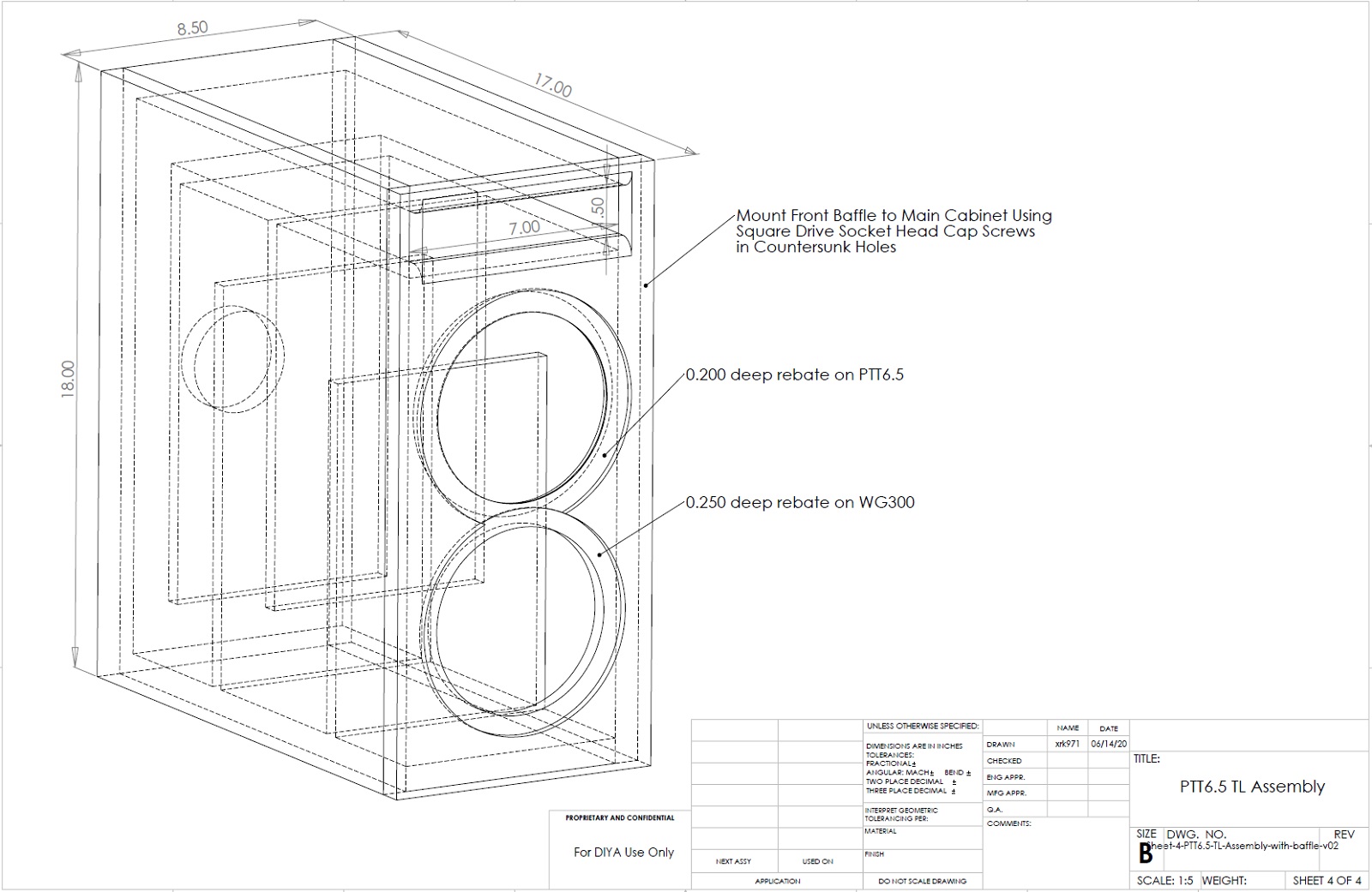

I never got around to making the foamcore pathfinder/prototype. Will go straight to BB ply - my cabinet maker has started already. I am sending him drivers to get a Perfect fit (despite my best efforts to specify in a drawing - nothing beats having drivers in hand).
Here is what it’s going to look like:

That's a bad-*** TL box. Hope that hard work pays off. I still cant believe how revealing the purifi driver is after all this time.

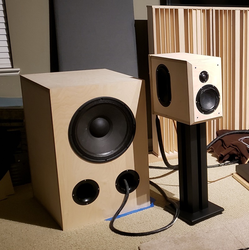

I tried a Bliesma T25B-6 + PTT6.5 as mid-woofer + a JBL 15" as the woofer. crossing at 2.5k and 120Hz. Sounds amazing. As capable as the 6.5" Purifi is, there is no competition to a 15" JBL. As the good saying goes, there is not replacement for displacement.
I am curious how large is the box for the 15" JBL?
The Michael I mentioned above uses GR Research servo subs another more bass More bass MORE bass option where the cone area and servo amps help mitigate the distortion effects Purifi goes after.
6.5 cu ft. it takes up quite a bit of space!
attachment.php
I am familiar with the GR subs. Although never heard them in person, I follow the posts in the audiocircle forum. Very curious to try them but I am honestly running out of space in my room at the moment. In fact, I had planned to pay a visit to Dannie this month but all travelling plans was put aside due to the current situation.
I just have to wonder if we even need the GR subs if we have an array of 10 Purifi's on each side!
