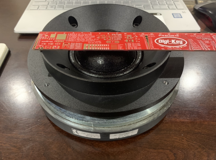

I just got a set of VM752’s as part of 3 way speaker I am designing for a friend. Never have I ever held such heavy driver - it’s 22lbs and about the size of a very heavy 8in woofer. But it’s just a midrange.
Just look at how big it was a compared to keyboard of my 15in laptop.

That's massive. What are the other drivers? Did you take any measurements of the Volt?
Not yet but will do so as I will design a passive crossover for it.
Tweeter will be a RAAL and woofer is TBD but leaning towards dual SBA Papyrus 7in in a tapered TL.
Looking forward to hearing the legendary sound of this British made 3in soft dome mid. (Although fabric, the dome is quite stiff like a paper driver). I don’t know how this thing manages to weigh so much. I think a Neodymium design would be welcome.
