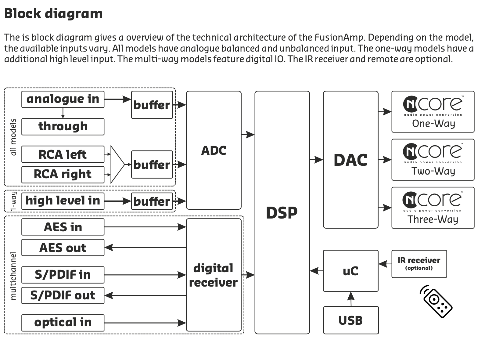

I went to look at the Hypex Fusion Plate Amplifiers - nice system. Do they come with embedded dacs or can you use your own?
- I would like to ideally use a single dac of my choice... don't know if that is easy to do or not
Well, with a digital crossover you always need multiple DACs. Fusion is a complete system including DACs and amps. This kind of integration has benefits (no interlinks, preamp, connectors and additional circuits required). My Fusion 253 has three DACs built in, one per channel. You can connect a single DAC to it, but you will have an additional ADC stage then. With a good clock source I now prefer to go digitally in via spdif. But if you like the sound character if your DAC you van connect it, the ADC stage is fairly neutral...
The beauty of using a Hypex amp is that there is no need for a DAC. If you use a DAC, the output will just be converted back to digital, which means you have introduce two unnecessary conversions to the process.
Here's the Hypex block diagram showing the digital and analogue paths:
