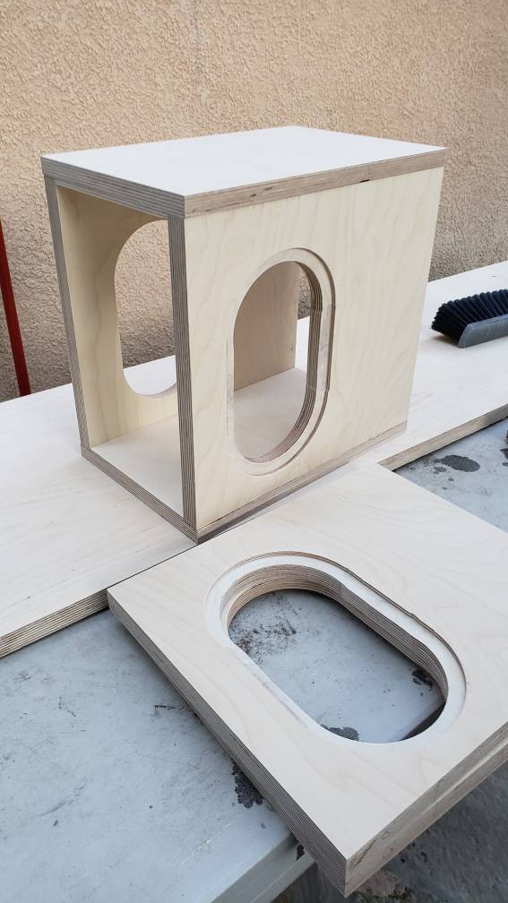

Starting to take shape. Hopefully will be able to make sound by the end of the long weekend. View attachment 846835
Didn't finish. Hot day so started late and the router jig slipped while making the front baffle so took longer to correct the error. And front still needs flush trim and chamfer. Might have to redo the baffle. Luckily it was designed to be removable for experimentation.

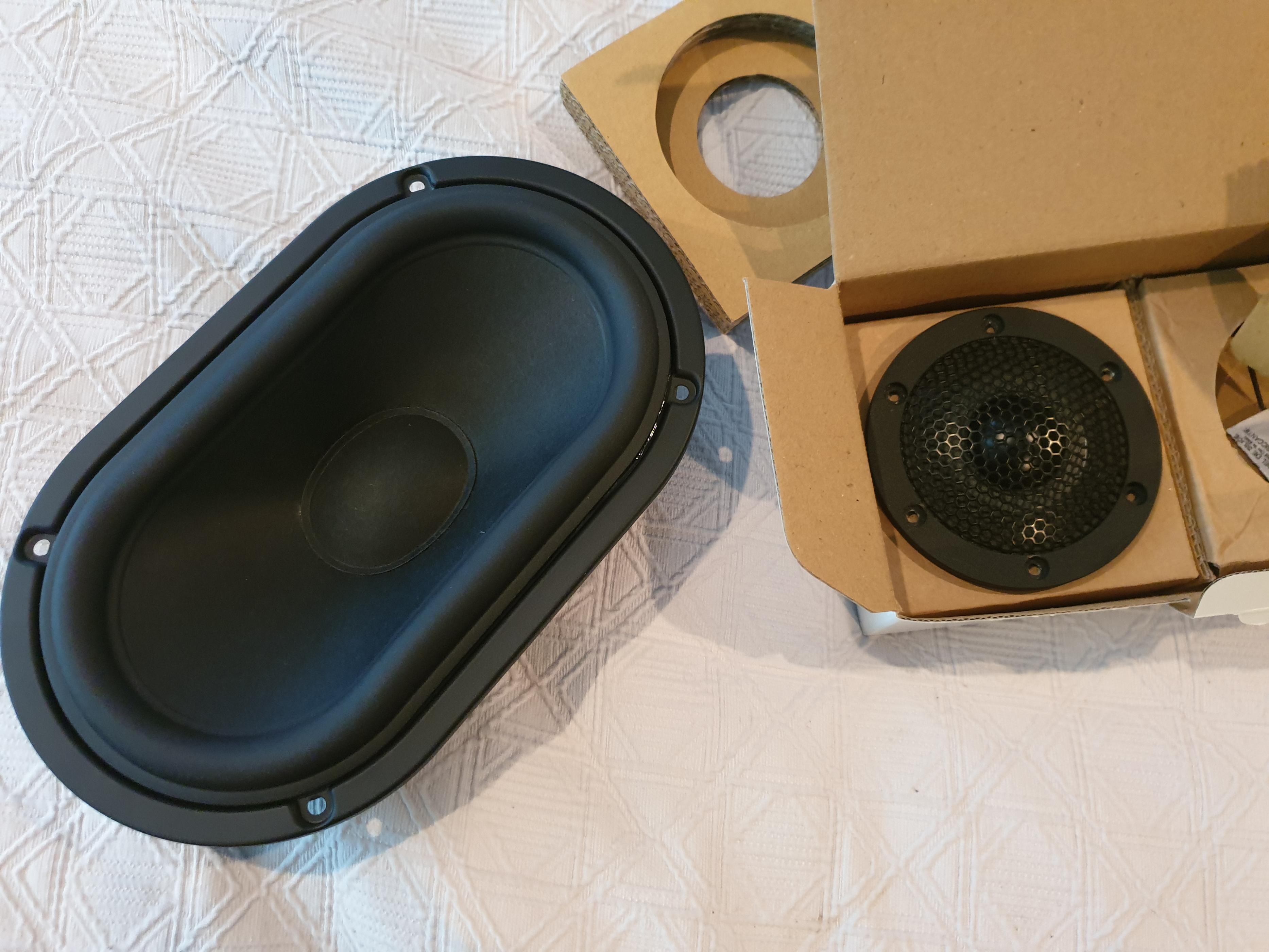

Put everything together to pose for the picture. Purifi 6.5, SB passive radiators, and B&W tweeters with 3D printed housing/ front plate.

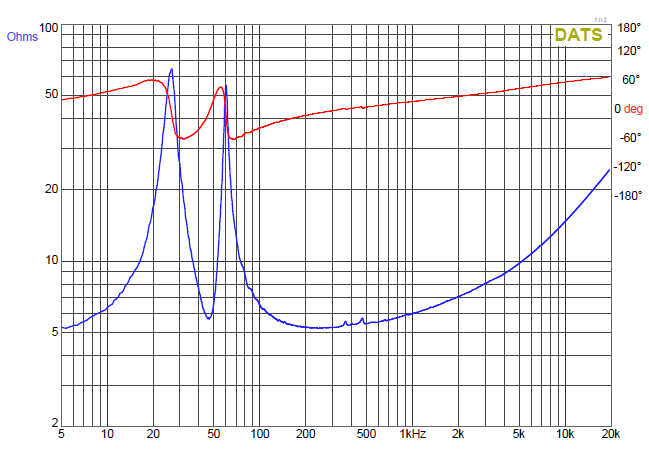

Here is the impedance plot. Box resonance is a bit higher than driver. Will have to tune the PRs.

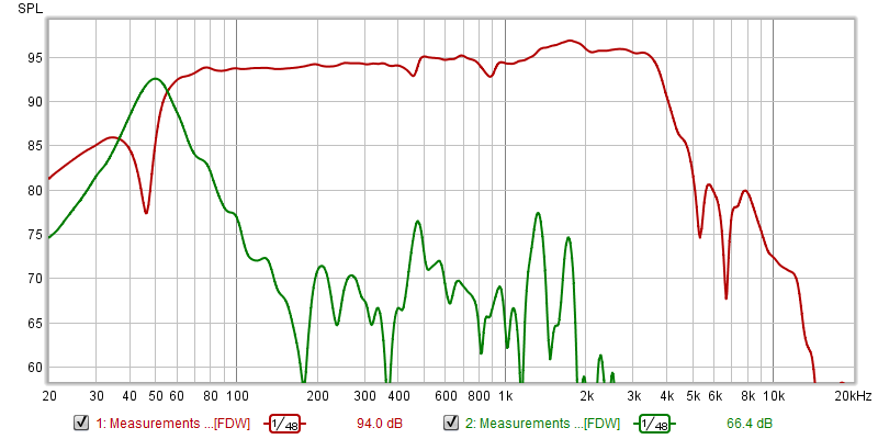

Here is the near field FR plot of the Purifi and one of the 2 SB PR.

My guess is that I can add a few grams to low the resonance a bit more?
There are also 2 dips at 460/890Hz. Those corresponds to the depth and the width of the box. Need to add some dampening.

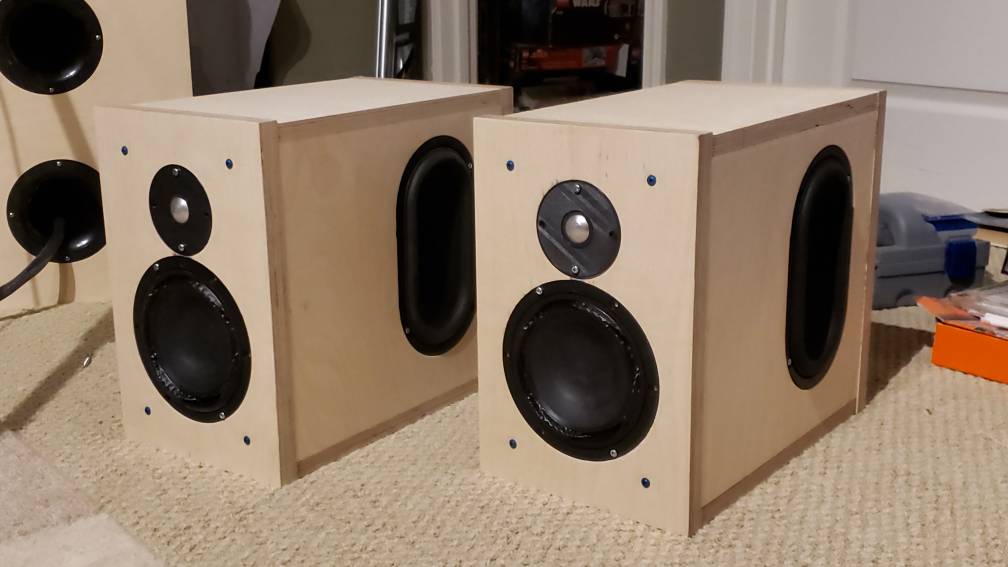

2 PR's per woofer. I think the Vd of the purifi (max) is about 193 cm3 and the vd max of this PR is 195cm3 so it works out on paper
well I can confirm that it will work. I just hooked it up and blasted some organ and the 2 PRs held up fine even when the Purifi was pumping hard, at parts the Purifi even went beyond xmax, scared the crap out of me.

Passive resonators on a 2-way hmmm.... Midfreq noise coming from passives, how abot it?
I have wondered about that too - my test box has them on the back so not as much a problem. But can definitely hear some mids radiating out. Some stuffing will help but not eliminate and will dampen the bass too much. A TL would be better in the respect. Btw, complete CAD drawn plans for the TL design are now available here, including the STL file for the WG300 to RS28F adapter.
In Jmpsmash's graph, you can see the peaks at 210Hz, 270Hz, 470Hz, 1400Hz and 1700Hz maybe -15dB to -25dB below the main output (assuming scale is the same).
good point about the mid-frequency leak. a -15dB leak will certainly be audible and unpleasant at those frequencies. Both the hificompass and the Purifi official build (despite being a ported, they probably had the same design for their PR testing) have a internal barrier that doubles as internal framing. I plan to add that to my box and compare the measurements. Along with some absorption for the box dimension resonance should control those leak better.
