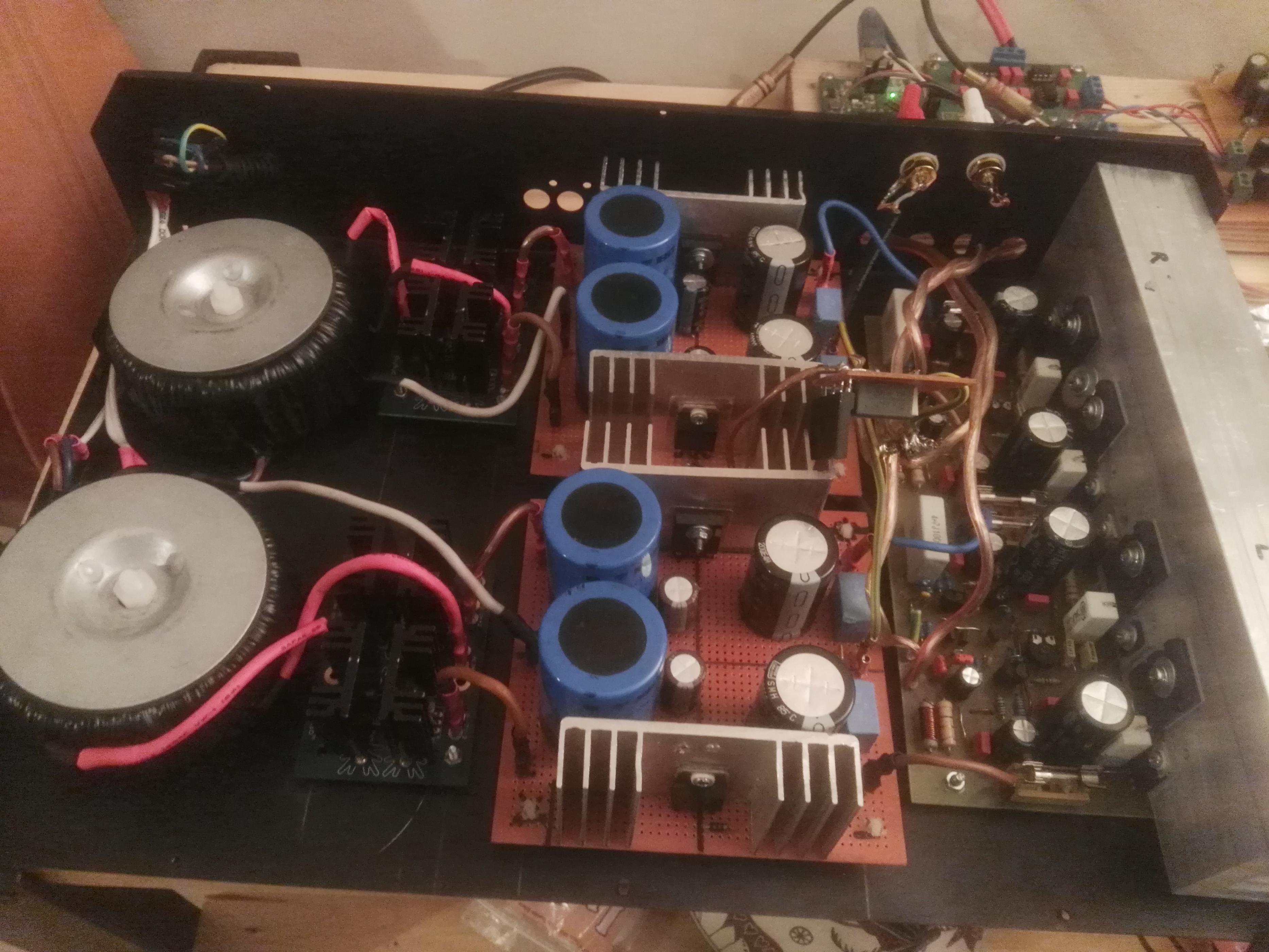

My symasym 5.3 is almost completed. But I worry about bias.
I built some classA amplifiers. They are bests. But modern technology allows classAB/B amplifiers can be so good.
MikeB recommends 55mA per channel, is there a benefit of increasing bias? for example; 150mA, 300mA, maybe 1A even 1.5A?
I also have simple capacitance multipliers and 100VA transformers per channel. I will go dual mono in one chasis.
Is the original 5.3 schematic suitable for highly biased operation?
What would be your suggests?

Here is my Symasym 5.3 🙂
its a dual mono in same case.
100VA transformer and simple capacitance multiplier each channel
StarGND has connected to chasis with ground-earth breaker.
there is no humm. but I hear "hiss" noise from the amplifier. When source is not connected, "hiss" is lower but still there.
is "hiss" noise normal, or can I reduce it?
my previous amp was PASS F5T and there was no hiss.

I reduced the Gain with 1k and 33ohms
The sound is excellent. After reducing Gain I feel trebles crystallized, is that possible?

What do you mean by 'trebles crystallized'? Better or worse? Crystallized to my mind sounds like glassy?

Hi anatech and rest of forum friends. I had also read about the stability loss in the amplifier by using output transistors C5200 and A1943 instead of those recommended in the diagram originally but I have several of the ones mentioned firstly in my stock. I have read very good references about this symasym amp so I would like to build it. Thank you for your help
Hi Elias,
Many amplifier designs do not like other output devices, same for drivers. So it isn't uncommon to have to re-stabilise an amplifier if these parts are changes. What changes in all amplifiers is the phase margin. The question then becomes, "will this affect things in operation".

Hi Chris thank you for your answer. If I wanna use C5200/1943, I will have to adjust bias. I read a friend here made some changes to make this amp worked ok. What do you think about that?
Hi Elias,
You will have to change the compensation capacitor.
The bias current is a completely different thing. One thing you should know is that the higher the current in a transistor, the faster it gets up to a point. Then it decreases again. We're talking amperes, but the effect exists at bias current ranges.
Search the SymAsym thread for the output transistor types you're interested in. Bear in mind that there isn't going to be a great deal of performance differences between good quality output transistors. You would be wasting your time to locate and install the "best" output transistors. I have to admit that the On Semi devices I used are the best I have seen. But, I'm not about to try and buy (likely fake) the same parts for a couple I still have to build.
