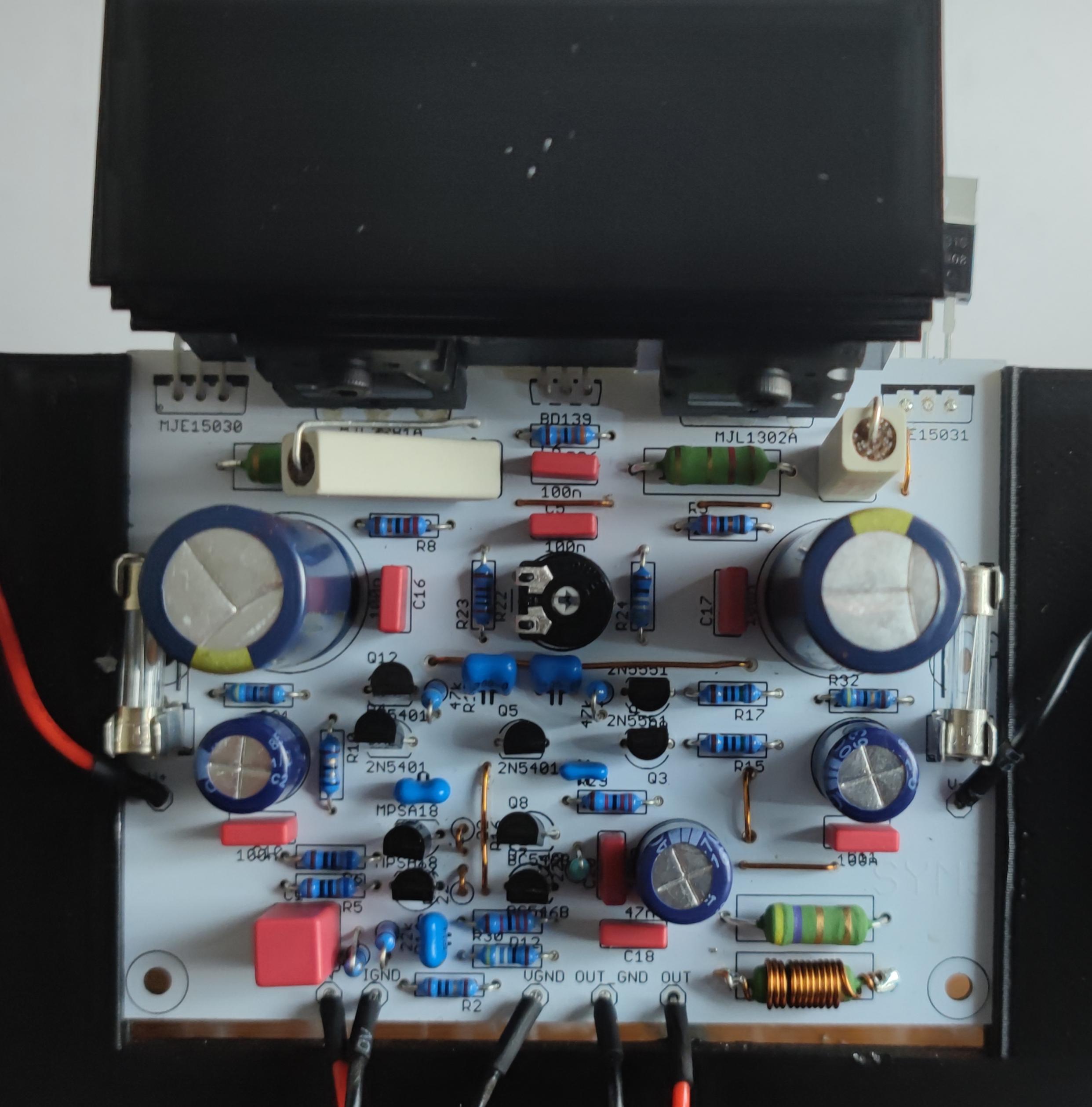

I build the amplifier and ran into a problem that I can't solve. First of all, I am a beginner in audio engineering. I can solder and play a little with the multimeter thats all.
Now the amplifier is not working properly. A symptom is that I have to set the volume of the source very high so that something comes at all and what comes next is very noisy and scratchy.
So now it is also the case that I cannot measure the bias, for example, as long as no source is connected, the voltage remains at the emitter legs of the transistors at 0mV or a little above but then quickly becomes apparent 0mV.
Has anyone a idea where to start to troubleshoot?

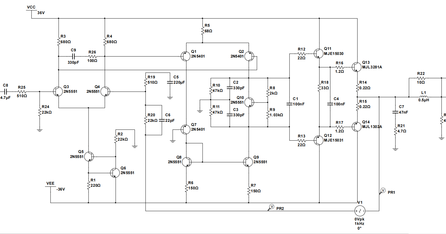

In the schematic on the first post, it only uses lag compensation in the input stage. I don’t think it is enough to make the whole thing stable.

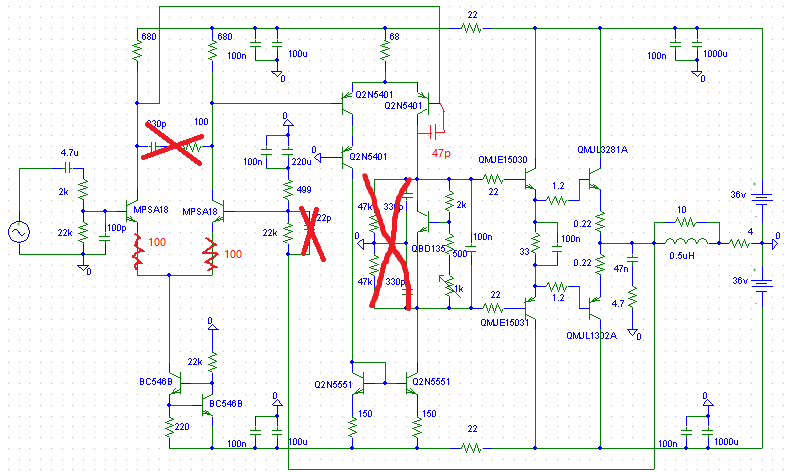

Here is my suggestion.
1. Remove the compensation in the input stage.
2. Degenerate the input transistors with 100 Ohm resistor, so you will get a well defined gm.
3. Put a 47p Miller cap on the VAS. (Right side of VAS only)

Many thanks for the quick response!
Just to make sure I understood right:
Remove compensation in the input stage: Is the 22p cap in the feedback loop meant?
Degenerate input transistors: Does that mean two 100 Ohm resistors directly to the emitters of the MPSA 18´s? Is this the same as Michael recommends when reducing the gain?
47p Miller cap - didn´t understand this - what does "VAS" mean (sorry for asking stupid questions)

VAS: voltage amplification stage.
Please see my changes below.

I will not build one unless it performs well in the simulation.
It is fine to disagree. Miller compensation is the one I am familiar with. That is how I tackle the stability issue. I know not everyone likes the taste of Miller compensation.
One thing it is good to point out. If the original design works fine, don't change it.
I want to add some note to the method that I mentioned in Explendid amplifier designed by Michael Bittner, our MikeB
I can tell the original author wants to avoid Miller compensation. The original design has higher slew rate and bandwidth comparing the changes I proposed. If you don't have issue, don't fix it.

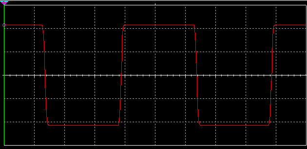

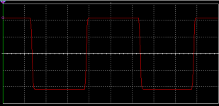

The simulation is based on the schematic in the first post. Hope I did not screw up this.
Here is my observation.
1. It is stable. Clean square wave at 10KHz. Credits to the author.

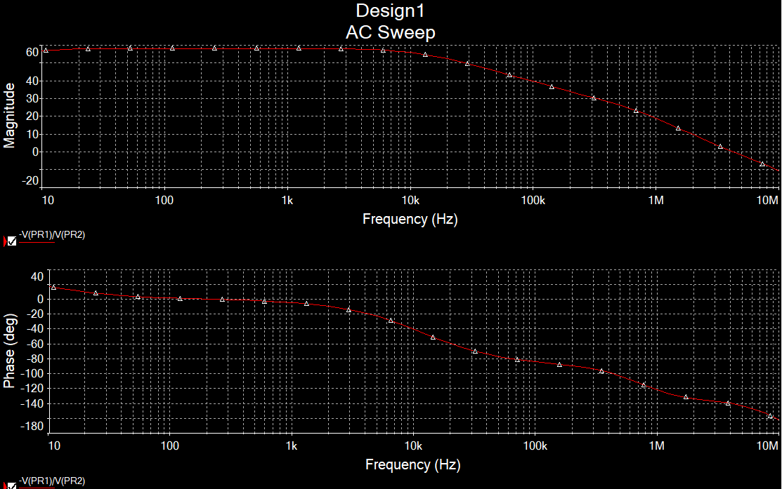

2. The ULGF (unit loop gain frequency) is high up at 4MHz, comparing average amplifier that only gets 500k - 1M ULGF. That means it probably won't work on bread board. You need good PCB layout and component selection to make it stable at 4MHz.
3. You get near 60dB feedback at 10KHz, which guarantees low THD. Under 100mA bias in my simulation, I get 0.007% THD @10KHz +-20Vpk-pk.
