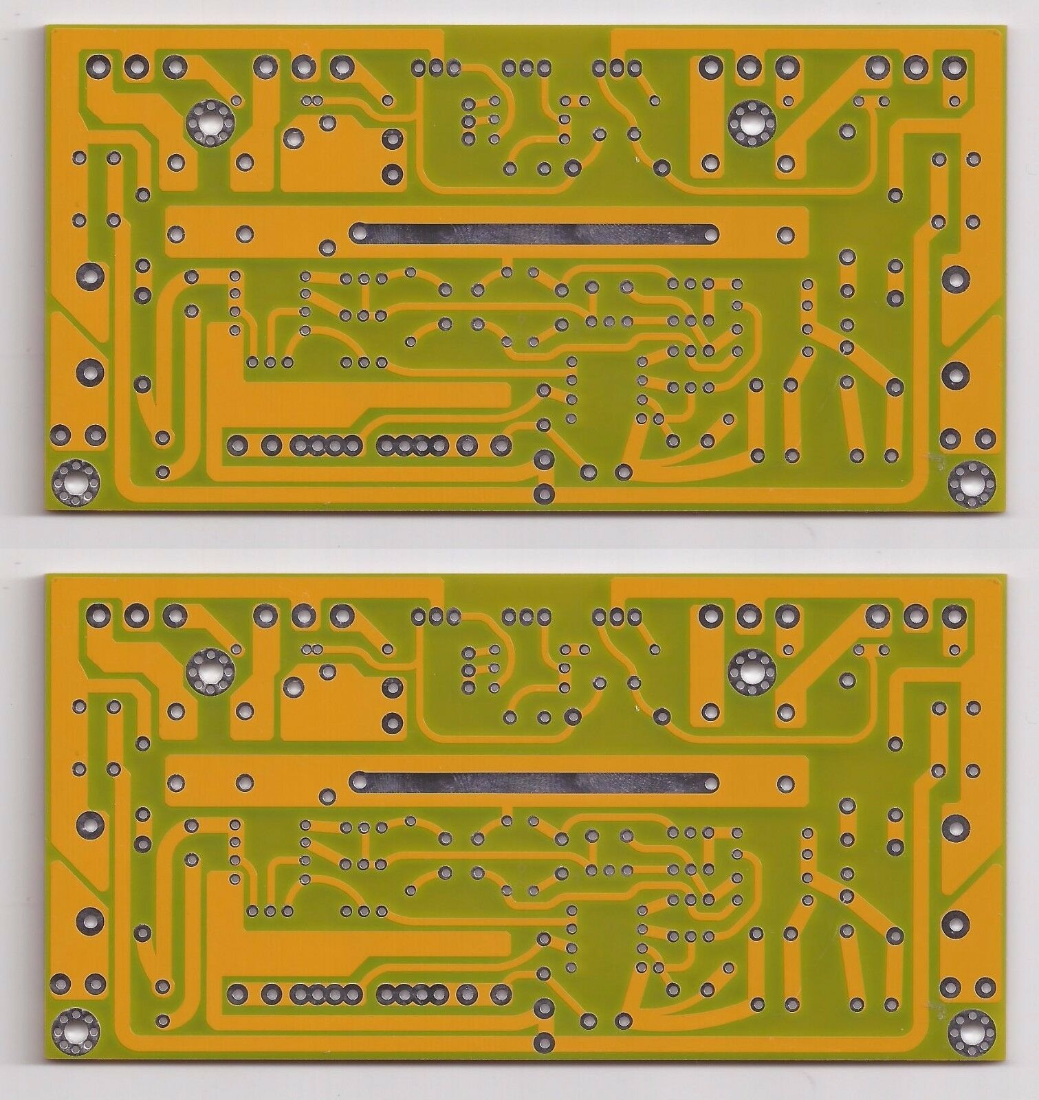

Alternative Drivers & Outputs. Also, is this PCB/Schematic "Good"/"Correct"?
Two Questions:
#1. Is it ok if I use genuine Toshiba TTC004B/TTA004B along with genuine Toshiba 2SC5200N/2SA1943N (all from Mouser) in the attached eBay "Classic Symasym5-3"? My alternative would be genuine Sanken MN130S/MP130S and Toshiba 2SC5171/2SA1930 taken from a disassembled receiver.
I ask in case it would be unstable and/or degraded. I could wait until my next Mouser order if necessary but I like to recycle when it makes sense.

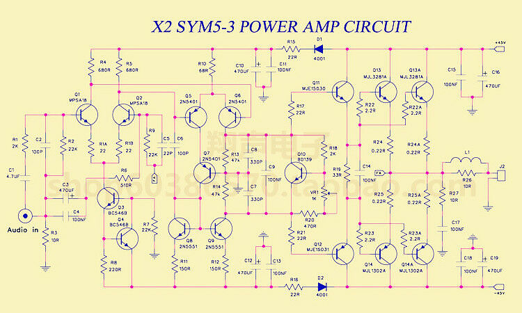

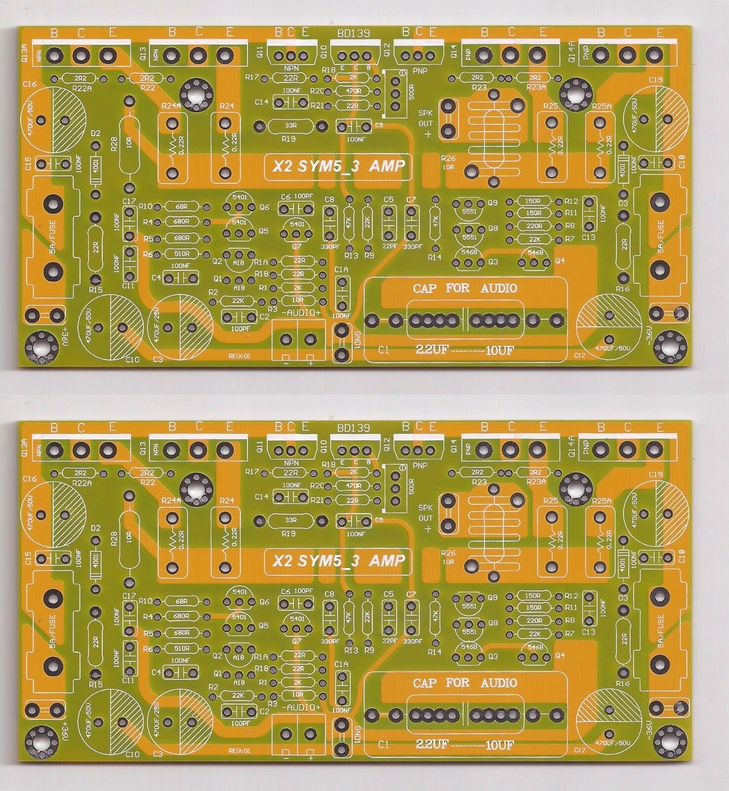

#2. Is the attached version (PCB and Schematic) "good"? I ask since I have seen a number of eBay kits or bare PCB where the layouts and/or actual schematics were poor and/or simplified and departed from the real thing. Also my eyes might be shot for the day but I don't see D1 & D2 on the PCB. (D1 & D2 are not needed, correct? What was the reason for them?)

It's been a very long time on this one. I think 5.3 was the latest one, so find that schematic here and follow it. Every version 5 release was excellent, they all worked well. Beats the heck out of guessing or using questionable information.
So using "search this thread" I found a reference to Jim's Audio (he does not post the schematics and that PCB is a different layout) and also a post from slowhands which includes a fuzzy schematic: Explendid amplifier designed by Michael Bittner, our MikeB
I believe the fuzzy schematic is the same as mine but it really isn't 100% legible. I will keep searching but if someone knows the official schematic location/post (or can verify that the schematic and PCB that I posted is ok) that would help.

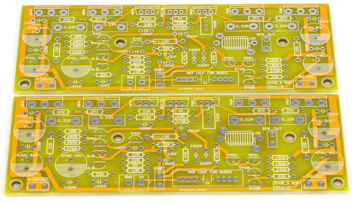

After doing a few more searches and comparisons I wonder if my boards and the jims_audio boards for the Symasym5-3 were done by the same PCB designer? (Or perhaps one copied from the other?)
The difference appears to be the removal of the fuses and an area/cost shrink.
Below:
  1. jims_audio (front)
  2. jims_audio (back)
  3. mine (front)
So if anyone can confirm that the jims_audio boards are good (I assume they are) I will just go ahead and start assembly. I also found online that some are sold assembled with Toshiba 2SC5200/2SA1943 outputs and 2SC5171/2SA1930 drivers.

The Symasym5 did not have two pairs of output devices... so this is probably not the same amp. Here is the official website SymAsym5 - Project
edit: What a surprise. China has ripped it off, and it's all over Aliexpress with two output devices and an increased power supply. The symasym is not suitable for rail voltages over 35V - the 2N5401/2N5551 devices used in the VAS will run too hot
Thank you that helps a lot. (I wish I had found that earlier with the Gerbers.)
Comparing with the schematic for the board I bought (in post #4302) I do not see any show stoppers. Here are the differences:
  1. The eBay/AliExpress board adds 22 Ohm emitter resistors for the MPSA18 input pair.
  2. The outputs are doubled and the base resistors changed from 1.2 Ohm to 2.2 Ohm (two, one for each output). (But they are lower capacitance outputs.)
  3. On the output the 4.7 Ohm 47 nF Zobel network was changed to 10 Ohm 100 nF.
So next I will examine the PCB layout and make sure it matches the schematic and also try to spot any layout issues.
I will not be using high voltage since my speakers are four Ohm. The "donor" AVR chassis that will be recycled has a large extruded heatsink and a dual voltage secondary (SecH and SecL). I believe I will have +/-32V DC using the SecL.
Perhaps the double/parallel 2SC5200/2SA1943 are ok since their capacitance is quite a bit less (each) than the MJL3281A/MJL1302A pair.
Any advice/suggestions would be appreciated as I am new to this amplifier.

Most modifications made to the highly evolved design here by other people are probably not tested. Base resistance is not something you really want, and the lower stock values are what I would stick with.
The original design was tested and evolved carefully. The PCB design is also critical, so if your pattern differs your performance may not be the same. The layout can affect distortion and stability a lot.
-Chris
Sure. I could install just one MJL3281A/MJL1302A pair and the original 1.2 Ohm base resistor. I "suspect" that two pairs of 2SC5200/2SA1943 with two 2.2 Ohm (1.1 Ohm parallel equivalent) will "add up" to a similar total RC as the one MJL3281A/MJL1302A pair and the original 1.2 Ohm base resistor.
However it would be better to be sure. Someone must have build this other version but then again it might not be tested.
If I go with the original component values (one MJL3281A/MJL1302A pair and the original 1.2 Ohm base resistor) does that work well with 4 Ohm speakers?
I suppose I could order new boards from JLCPCB... ...sigh. Or build these, measure with REW/E-MU 0404 USB and listen to them. The trouble with eBay and AliExpress PCB/kits is that they are very easy to find but often are "modified" and/or suspect.
I will likely wait 7-10 days to see if anyone recognized my PCB and can verify the performance/end result.

I had to reduce my compensation capacitor to 10 pF using MJW0281 and MJW0302. So, you might be fine, just look at a square wave driving a load, 2 1/2 to 3 V signal is all you need. Adjust the compensation capacitor to reduce ringing. Once you find the right value, get a polystyrene for the best sound quality.
So, you need an oscilloscope and function generator for this. An 8R or 10 R resistor at 10 watts should be fine, but I used proper non-inductive 250 watt dummy loads.
Actually I have an easy solution. I had bought MJL3281A/MJL1302A for repairing my L20.5 but when I compared 0281/0302 versus 5200/1943 (measured with REW/E-MU 0404 USB and EBG UXP/300 load) I found the distortion lower with the 5200/1943. So I never tried the MJL3281A/MJL1302A. (Soldering and desoldering 8 outputs on the L20.5 layout just to try is a bit of a chore.)
So I used the 5200/1943 in the L20.5 and I can repurpose the MJL3281A/MJL1302A for this one and avoid any guessing.

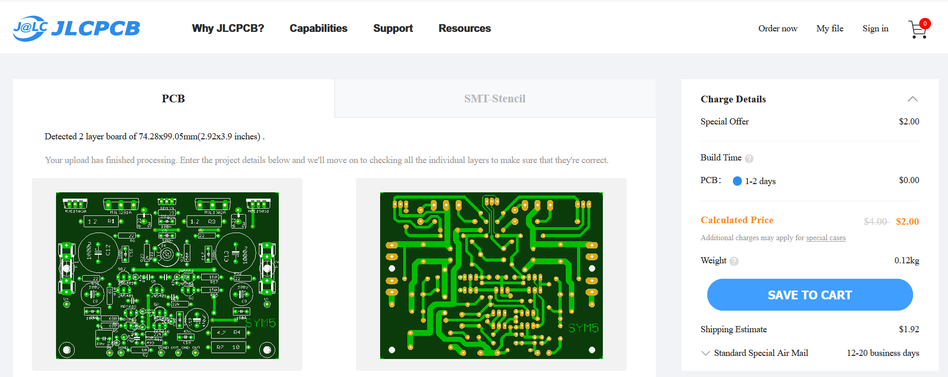

Is the attached layout the right one to order? (That is what I found from jaycee's link in Explendid amplifier designed by Michael Bittner, our MikeB) I just noticed that the JLCPCB shipping price is much better than earlier in the year so I can easily order the right boards. (Now I just need someone to point me to reliable/approved KSA50 MkII and Accuphase Gerber files and I will be finished my Christmas shopping. Seriously, if anyone knows the right gerber files to order for those please let me know. I like the sound of the KSA50 kit I built but I know it is missing what appears to be two emitter followers and various component values are different in the input section.)

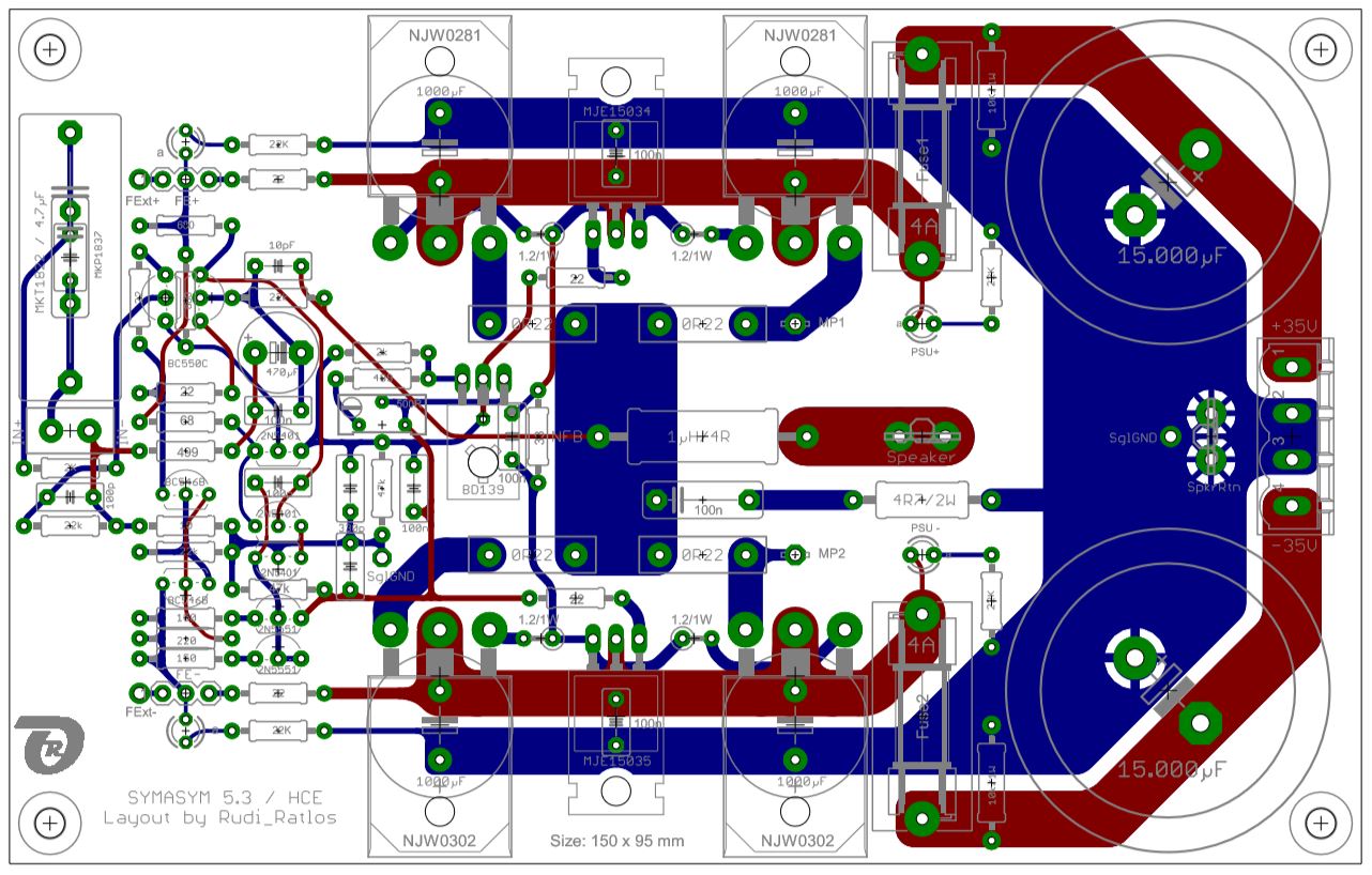

This is the original SYMASYM - website:
SymAsym5 - Project
I have attached a layout-design that I have done myself.
It works absolutely stable and fine.
The other pictures show the SYMASYM with my layout as used in a home-cinema.
Regards - Rudi_Ratlos
