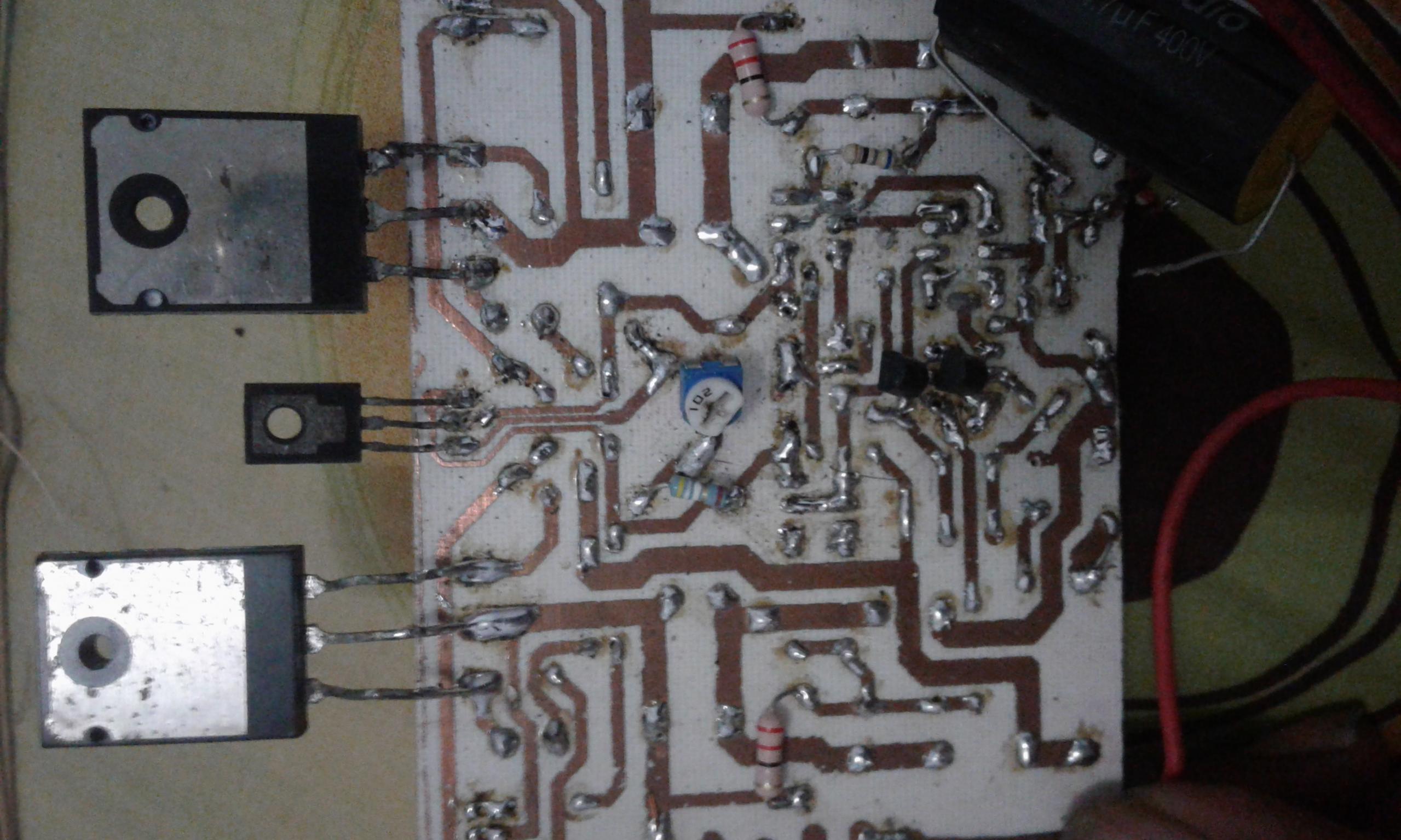

That my sym but some component that i pickup for checking component, and i already build new one with new component, but tr final not new ,

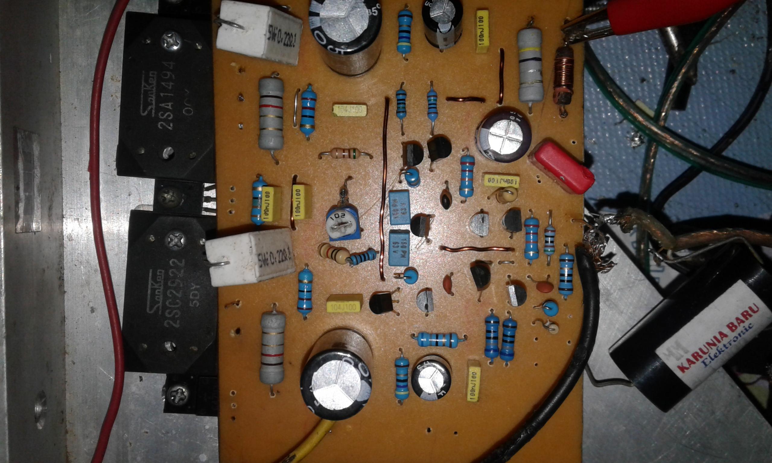

I mean the first build symasym is white pcb the result when i measuring the bias at both of emiter final is 0 mv i adjust with vr 1k still 0 mv, and than i build 1 again with brown pcb and i measuring bias , i adjust at 2.3mv , 5 second than be 630 mv reads at my dmm, sory if my english not good enough
I note that in the picture the Sanken transistors only had screw in one side of each one so they may not be flat against heat sink.
Also it looks like the Bias transistor BD139, is half sitting on the Sanken transitors insulator, so I guess it's not properly in contact with heat sink.
Even so 5 seconds is a very fast bias rise, if it's stable after reaching 630mV perhaps this is due to capacitor charging? Cany hte bias be reduced from 630mV ?
Most likely, as soon as bias reached certain level - the amp starts oscillating.
Do you have an oscilloscope connected to the output?
Stable maybe, i try in about ten second and heatsink very hot, iit can't be reduce, i must off and on again biasing be 2,3 mv and 5 second rise againt

It is a new one that i had build
Is that big Karunia Baru thingie the capacitor in your nfb decoupling arm to earth.
If so remember this element connects to the inverting input of the amplifier and capacitors are wound components - you don't want to be picking up signals radiated by your output stage. The output stage resistors also have inductance as these are wire-wound. Don't invite this sort of trouble.

I'm sure, it oscillates as soon as the bias exceeds certain level, due to particular build specifics. There may be other issues, but the simple ones I'd like to mention:
- rather "dirty" bottom side of the board - you may want to clean it with white spirit and carefully dry before powering it on again;
- rather inaccurate mounting of the drivers, outputs and temperature sensing transistor on the heatsink - it would make sense to mount them a bit wider, using all the screws and insulation pads of the right size - proper thermal contact is important.
- Output transistors combination is sub-optimal - complementary pairs are:
2SC2922 / 2SA1216
2SC3858 / 2SA1494
