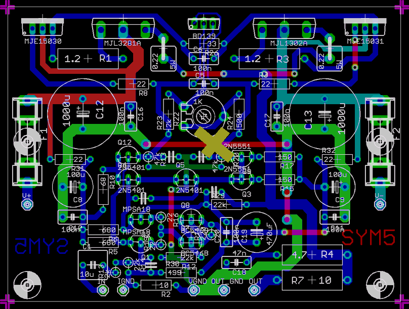

Now that this thread is alive again, can anyone explain to me why this amplifier is one of the few (the only one to my knowledge) where you connect the speaker return to the amp board instead of the star ground point?
And what happens if the SymAsym blows a fuse, either - or + rail? Does the output stick to the remaining rail or does it behave nice. I need to know if DC speaker protection is a must or might be skipped for starters...

I studied mike's "symasym" board and it is a secondary "star" , along with another (another channel), it then connects to a central star located at the main capacitor bank/trafo CT.
I have observed a larger version of this amp with a blown fuse , didn't blow the speaker , didn't blow any OP devices. A DC protect circuit couldn't hurt, but all my equipment is doing well after 13 months and much abuse.
Mauro Penasa's MyRefC also does this. I think Roender's PCB does likewise.
The reason being that the main audio star ground is on the PCB, so the speaker return goes to that audio ground.
There are two sets of PSU caps, onboard ones, those included with the Symasym schematic, and the ones you should increase which should be placed right next to the rectifier. We want to avoid allowing rectifier pulses going through the onboard caps and polluting the ground, so instead we put larger caps right next to the rectifier offboard to absorb the charges before they contaminate the board ground.
So by PMA's advice you would add the new caps right next to the rectifier, grounded to a star ground at the center tap of the power transformer. A wire then connects this star ground with the amp board's power ground.
Did I get that right?

Keen , I see PMA's line of thought here, at least for this amp. The pulses here are right next to the sensitive parts of the amp (no distance) with only an R/C, (R31/C16) separating them from the input stage. No 1000uf cap here. In fact , they meet at the "X" .. the middle of the jumper (below- 1). Scoping an offset ground point of something like the symasym pcb will show the pulses , at least on something bigger with bigger caps.
Having bigger caps on the rails is nicer than having them offboard , so on a bigger board one could have 2 ground connects , one dirty ..one clean.
