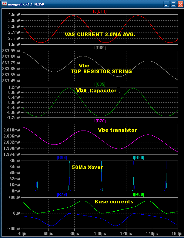

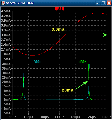

I would expect the output bias to change very little if at all when changing the VAS current.
If the D.Self Vbe multiplier extra resistor is implemented, then you can tune out bias voltage changes with small VAS current changes.
It DOES change , even with the extra resistor. The change is only dependent on the average VAS current , as the E-C decoupling cap's time constant will smooth out any changes that happen quickly (an audio signal). SEE BELOW...
(same amp at 5.4 and 3ma)
OS

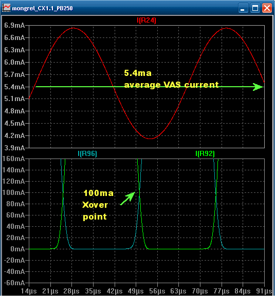

Yes, the VAS current does change. It swings either side of quiescent bias due to it passing the audio signal to the next stage. Just as your post shows.
But from there on I disagree.
I'll use the slightly simpler case of a single pnp VAS transistor loaded with a CCS.
Set the CCS to 5.4mA, to match your first example.
The current flowing through the VAS ends up flowing through the CCS. Well not quite, that equality requires the base currents of the upper and lower drivers to be exactly equal and opposite. For the time being I will make that assumption and further assume the base currents are +1mA and -1mA to keep the drivers conducting their own bias currents.
The CCS current = VAS current = 5.4mA
The quiescent VAS bias current has to flow from top to bottom, but has 3 routes to get there. Through the bypass capacitor, well excluding leakage there is no DC current flowing this route.
That leaves the Vbe transistor collector and the string of resistors around the npn Vbe transistor.
Let's assume that 1mA passes through the first of the string of resistors. That leaves 3.4mA passing into the collector of the Vbe transistor.

Let's suppose the AC varies the 5.4mA by +-2mApk.
The VAS range of current is 3.4mA to 7.4mA.
Most of that variation passes through the bases of the drivers.
I would expect your simulator to show just how much. I would also expect your simulator to confirm the changes in current of the Bypass cap, of the Vbe transistir collector and the first resistor of the string.
I would not be surprised if you report a result showing more than 90% of the 2mApk current change goes through the driver bases.
That would leave a variation in Vbe current (the 3 routes) of <0.2mA.

The effect shown in the simulation is the swapping of the Vbe changes between the two drivers and the output devices as they alternately turn off and on more or less, not quite balancing out. This is not due to Vbe multiplier voltage change nor to Vbe current changes. It is due to the nature of the Vbe vs Ic curve of the output and driver devices

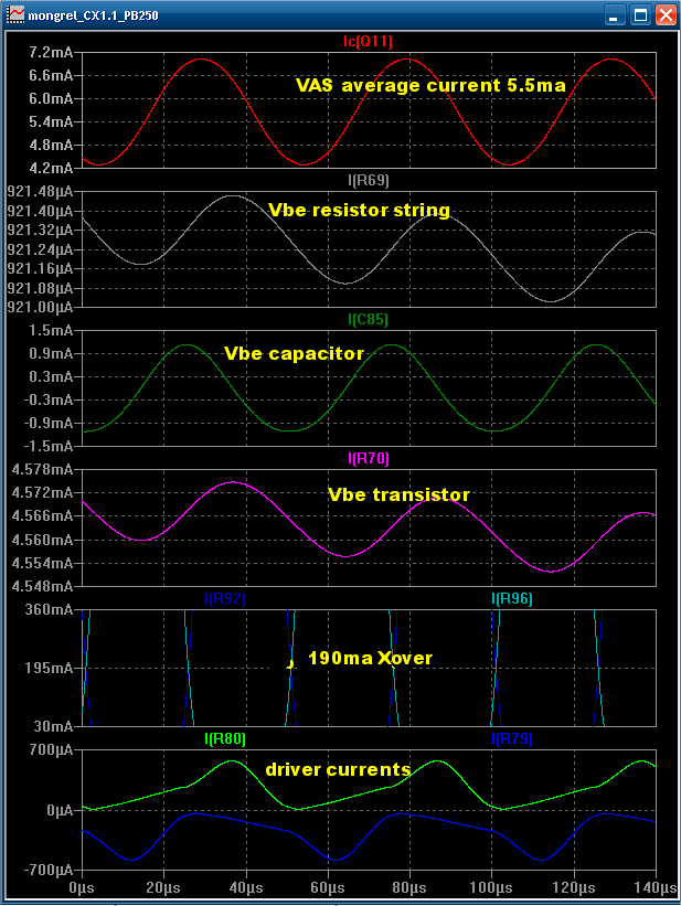

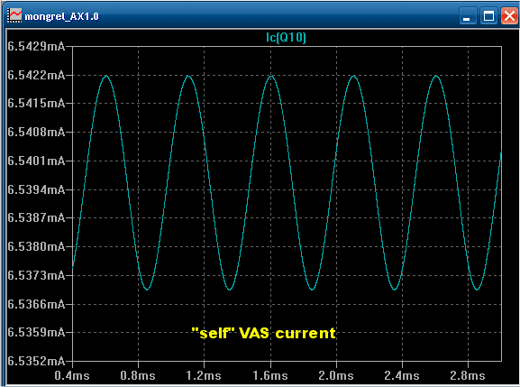

I see that the driver bases and their effect on VAS/Vbe currents are not a factor. This was done on the symasyms "big brother" (CX1.1) with a standard "self" Vbe multiplier (pix-3). As can be seen on comparison of the 2 compound plots (pix 1,2) the "change" is in the Vbe transistor and it's resistive divider. This corresponds to the Xover change (50ma to 190ma). Absolutely confirmed on the real-world version.
This amp is a little different than a standard "self" amp in its interaction with the Vbe , as the "self" has a fixed steady state CCS at the negative rail (pix 4 -VAS Current) with less than a uA of fluctuation.
Anyways , look for yourself...

Hi Os,
thank for running all those simulations.
One fact that does surprise me is just how much of the VAS current variation passes through the bypass cap. Well that's the way I read the data.

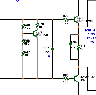

The self Vbe is wired up wrong.
The cap has to go on the other side of the multiplier. It connects the VAS output directly to the tail CCS.
The tapping to the upper driver comes from the collector of the Vbe not the top of the extra resistor.
Ya got me... 😀😀 (below) MY cap on the wrong side of the collector resistor. 🙁
OS
OS
Also R79 is also connected to the wrong side of R70. 😀 Very NAIM clone of you.

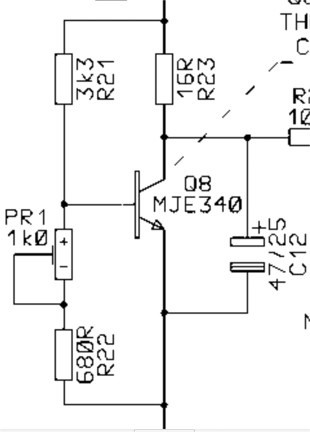

For a cap to work, there must be a voltage change across it. So you see there is no way a capacitor can possibly filter anything completely. A capacitor cannot totally absorb any load.
The cap and multiplier share the load (load being the current they will absorb as their effective impedance allows). Say the Vbe multiplier has a 220 ohm impedance. The 22uF bypass cap has high impedance at low frequencies, which decreases at several db per octave. At say 1khz the cap still has fairly high impedance, if it is equal to the multiplier's the load will be shared equally, except at harmonics of the fundamental where the cap has lower effective impedance due to the frequency.

this is where I am getting left behind.For a cap to work, there must be a voltage change across it.
The Vbe multiplier keeps an almost constant DC voltage across the cap.
The cap itself has a very low impedance to audio frequencies.
The cap plates float up and down in sympathy with the signal coming from the VAS.
The multiplier does it's best to ensure the cap voltages, both DC and AC do not change. At low frequency where the cap impedance becomes significant then that LF impedance will allow an LF voltage to develop in sympathy with the VAS modulation.
Now this where I got lost.The posted data showed tiny current changes in the Vbe transistor collector and top resistor of the string. These tiny current changes confirmed to me that the voltage changes across the resistor string and the parallel Vbe transistor must be very small.
Why does the capacitor show current changes approximating to 1mA?
If the voltage across the capacitor changes by just a few uV, then surely the current should also be in the uA range.
Why not?
Why not?
To change the voltage across a cap by a few uV
in a short time, the source must output a big current
to charge the cap in the said time....
Classical capacitors charging equations....
but we are not talking about a short time. We are dealing with audio signals and sinewave ones through a simulator.
If there s a variation of voltage multiplier impedance or
a variation of the VAS current , there will be forcibly a
higher voltage across the voltage multiplier.
The rising voltage will charge the cap in a very short time
since it is INCLUDED in the feedback loop.
It is the amp s NFB that is correcting a moving DC
working point.
- Explendid amplifier designed by Michael Bittner, our MikeB
